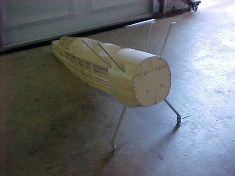

The wings and tail feathers are framed and covered and the fuselage is ready to receive the radio gear and engine.

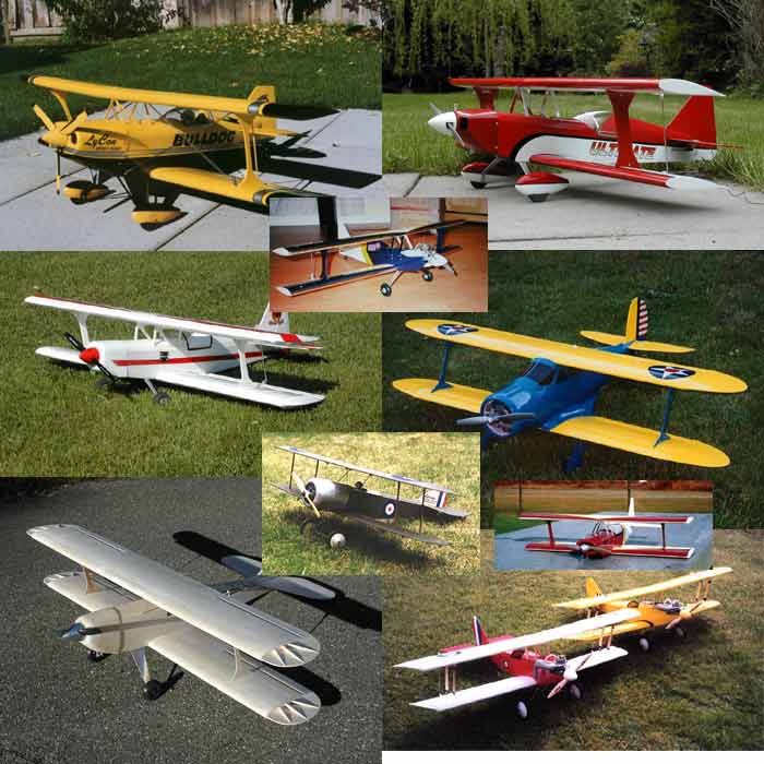

Here are some of my bipes. 1 is from a kit, 2 are from plans and the rest are my designs. Sizes range from 20" span to 61" span. .049 to .90 All 0,0,0.
I loooooove bipes!
I loooooove bipes!

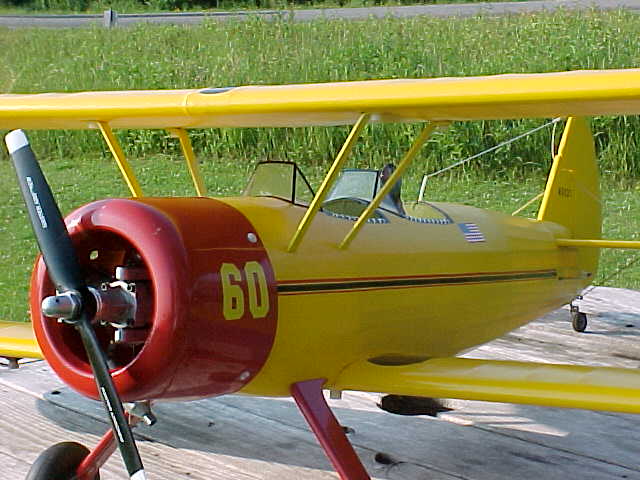

Have been trying to fly my Midwest Stearman for some two years now and have had many instances of stalling and fortunately have survived most crashes with minimal damage. Mostly bent gear and a pushed-in firewall. This is a very disappointing model to me as I have some 25 years of RC flying and have tried most all model configurations. With 30oz. of lead in the nose, my Stearman comes in around 15 lbs., wet. The other day I computed the wing loading using a 15% reduction in measured wing area for biplane inefficiency and walla, mine comes in at a wing loading of 33oz/ sq. feet. The Stearman is not suppose to fly with wing loading like a WW2 fighter. But, that apparently is the sad state of affairs with this plywood disaster! Yep, have had some good flights but doesn't make up for all the stalling problems. I guess I am too comfortable with my Phaeton 90 bipe which really flies! Oh well, back to the canards. The one attached really flies well! [sm=drowning.gif]
Hi Flicka: Most bipes, in my book, do not have anywhere near enough vertical tail area, resulting in nasty handling anywhere near stall. The airflow over the tail feathers of bipes is messed up a lot more than that of monoplanes by an extra wing and its cabane struts, and the lower reynolds numbers of models worsens this nasty effect. The best cure for this is to enlarge the vertical tail area. I like to give the fin and rudder at least 15% of the total wing area, for non-scale designs with normal layouts. The Ultimate is a good example of a bipe with enough vertical tail.
The simplest way to try out a bigger vertical tail is simply to tape a cardboard extension to the trailing edge of your rudder. It does not need to be at all robust, since you do not need to fly very fast to determine whether it works. If your rudder authority was already strong enough, simply reduce rudder travel in proportion to the increased area. I would be inclined to roughly double the total vertical tail of the Stearman to get really friendly handling. Trying different size cardboard extensions is very easy, and can be done during a single flying session.
A little washout in the wings also helps, and beware of washin, - even a tiny bit poisons handling, and four ailerons are vastly better than two - much less adverse yaw and less tendency to bite you with snap rolls at inopportune times.
Bipes do not carry weight as well as monoplanes, but this can be overcome with more power. If you are carrying all that noseweight anyway, maybe a bigger engine would be worth trying.
