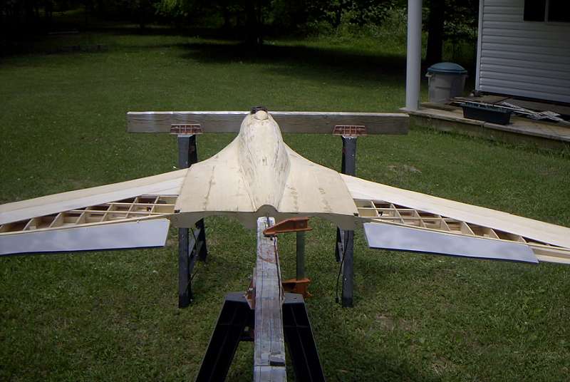

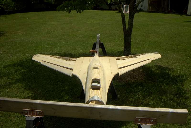

Some pics of the 'first cut' of the LE flaps. In spite of much discussion regarding the pros and cons, I decided to go ahead and try them. All the film of the 27 I've seen shows the LE flaps in the lowered position, including the 'Cobra'. I guess flat out, they are retracted, but every other maneuver shows them down. I haven't figured out the linkage system yet, but thats next. Interestly enough they make an arc moving downward which is why the full sized flaps are curved on the ends. I did not forsee that!
ORIGINAL: wsmalley
I had thought about using these from time to time and have even come up with off-the-shelf solutions which would allow the LE flaps to be mixed into elevator and would still droop when the trailing edge flaperons to be used.
It's basically a series of "Y" cables and on-board elevon/flaperon mixer used in conjunction with the transmitter flaperon that will allow this type of action.
If you're interested, I can draw up a schematic that better describes how it's wired. The linkage is fairly straight-forward as it just requires a servo per control surface.

Yea, Dan, I'd love to see your idea. As you may have noticed, the plane is made in sections. In the 'fore' section, I'm balancing the wings in the wind to check balance. As many times as I've watched 'Ram-K', including freeze framing the DVD, the flaps- during landing are imperceptable as far as movement as flaperons. The elevons are working like crazy. I can only conclude the flaperons function only at hi speed maneuvers, and then seemingly very slight. I figured I would use piano hinge on the bottom edge and lithoplate skin to slide over the gap. That too is very hard to figure out in the FS.

I would like to see your plans for the LE flaps (slats) as I'm looking to do that for a A-6E model, which is linked to semi-fowler flaps and the horizontal stab; e.g., flaps / slats extend and the horizontal stab LE depresses; i.e., up elevator.
No plans for the flaps. With a built up wing, I simply measured where the back edge would be and started the wing skins on the edge (top and bottom) of where the rear of the flaps would be. The width was determined by scaling off a plastic model and cutting inside of the inner and outer ribs. This meant making a false rib for each end of the flap. A Zona saw was used, letting the saw rest against the upper and lower wing skin. Actually is it was pretty easy. Slats would be a little more difficult, but if you do a search here there is some good info available. I'm sure we would enjoy some pics of your progress. Bill S.
