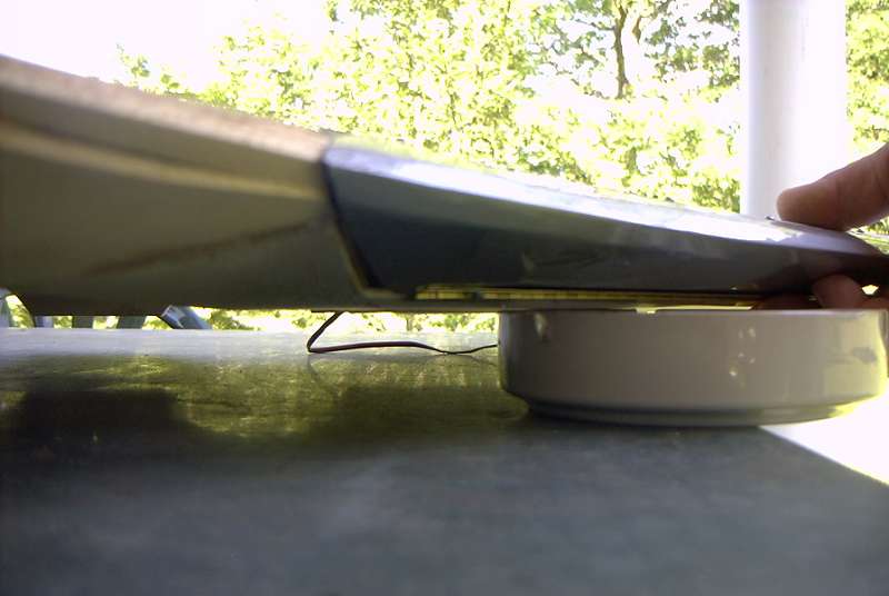

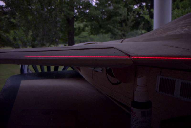

Some pics of the LE flaps mounted with full length piano hinge on the bottom. I use a laser level mounted on my camera tripod to check the surfaces. The light gives a very interesting flow over the surfaces and seems to 'flow' as one would expect air to move. I took these late in the evening to allow the light to be seen. Have my 3 mixers now to experiment with. The next step is working out the mechanical linkage.

I was thinking about the mixing and I've pretty much decided to hook my LE flaps to the aux channel and not have them mixed with elevator. Instead, I'm going to program the pre-mix to slave the aux channel to the flaps.
Thinking a little bit more about how they'd be used in flight, I've decided that the best way to do this would be to have the aux channel knob already twisted to full deflection, then control them using the pre-mix swtich.
When the pre-mix is disengaged, the LE flaps will droop to max manueverabilty. To retract the LE flaps, I would simply flip the pre-mix and the LE flaps would retract to the TE flap position (zero degrees). When I need flaps for landing or slow flight, I would then only have to twist the flaps knob and both LE and TE flaps will deploy.
This is much simpler than what I'd written before --too many knobs to twist, way too much pilot work-load.
This way, you only have to flip one switch to deploy and retract the LE flaps and one knob to twist to deploy and retract flaps. Everything else is handled by the mixers (Trx & on-board).

Since my flaps were not designed into the wing, I opted for the bottom hinge location with some lithoplate strips on top to cover the gap with flaps down. I use a dressmaker's tracing wheel to make rivots from the reverse side. It actually adds quite a bit of rigidity. In the 'up' position, the strips slide over the covering and barely raise the surface. Note the gap created on the root side with the flap down. This is why the full size has a circular taper built in. I can cure this with some work but note it's presence. I'll study your new sytem, agreed lessoning the workload is important. The full size has a computer to do this.

I'm also attaching the latest wiring diagram that removes the mixing between the elevator channel and the aux channel.

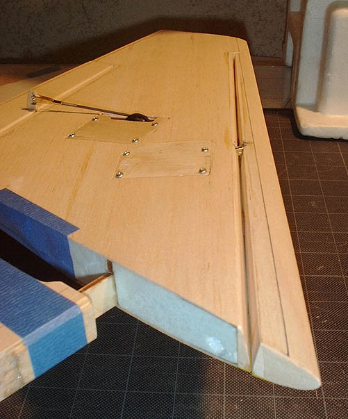

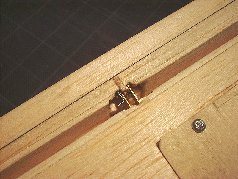

I thought you'd be interested to see the latest news on my LE flap installation.
I created a test rig to configure and test the mixing and to use for aerodynamic testing to confirm the torsional rigidity of the LE flap and whether the servo would handle the loads.
So far, so good. The control is torsionally stiff and the servo was able to actuate the control at 75% of the maximum speed that the model is expected to achieve.
I've made a few changes to the wiring. Instead of using an external mixer (EM2) for the flaperons, I'm using the internal mixing. I'm also tying the flaperons to the elevons through the transmitter's internal mixing rather than the "Y" cable shown in the schematic above. This allows me to couple and decouple the elevons/flaperons with a flip of a switch.
I've also created a short video showing the mixing operations. If you'd like to see it, I'll post a link once I've put it on my web site.
So, the next step is build the wings that will be used on the model. There will be minor revisions to the LE flap linkage to make it easier to use and more precise. I'm also going to make changes to the servo hatches to make those lighter and easier to adjust the linkage.
The last two pics illustrate the camber changes to the wing when LE and TE flaps are deployed.
