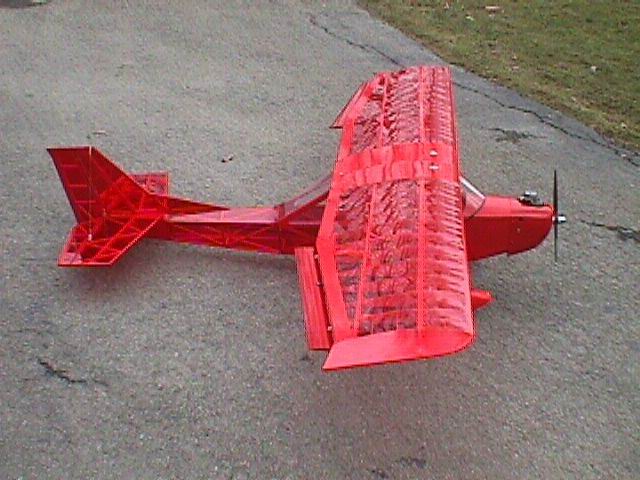

Old 12-23-2005 | 05:17 PM
Posts: 660
From: Jamestown, NY
Default RE: Junkers type control surfaces?
Been there and done that and they were very effective. See my McCessna attached. I static counterbalanced the ailerons with extended fishing sinkers adjustable on music wire supports.

Old 12-24-2005 | 11:06 AM
Joined: Oct 2005
Posts: 254
From: simi valley, CA
Very nice.
It's tough to get good roll authority on large wing slower flying models. Those type control surface are a great alternative to just making larger normal control surfaces. Plus I really enjoy the extra craftsmanship. In this age of ARFs, you don't see as much home engineering anymore.

Old 12-24-2005 | 02:45 PM
Posts: 660
From: Jamestown, NY
More detail!

Old 12-25-2005 | 12:04 AM
Joined: Oct 2005
Posts: 254
Looks like fun. I'd say a true sport flier if there ever was one.
