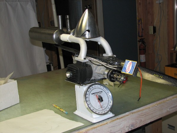

I am doing a Cassut for aerobatics -here is the powerplant /prop spinner n exhaust all 12 lbs of it
size is 50% scale which is only 7.5'span and 8' overall fuselage BUT 2300 square inches should be -32 lbs thereabouts -
