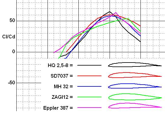

Below are a couple Profili outputs (I pasted the legend; it actually appears above the charts).
Here's a standard polar of 5 airfoils at Re = 70000, predicting low-Re breakdown of the E387 & Zagi 12:

And here's airfoil L/D for the same five sections at Re = 120,000

Your post raises a question I have. If you look at Cl/Cd the 7037 foil beats the MH32 across the range. Why is the MH32 the popular foil of the day?
Don't know specifically why, but l/d is just one among several considerations depending on type of plane and its designed purpose, flying style, etc.
I've heard the 7037 has a slightly nastier, more abrupt stall characteristic. Also that the MH32 is very responsive to flap input, efficient over broader speed range, generally better at high speed, may be a better multi-tasker.
Another thread w/related comments: http://www.rcuniverse.com/showthread...hreadid=311728]

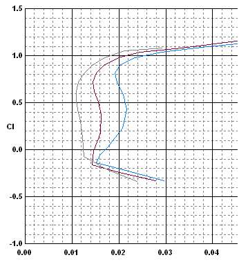

Im no expert that this stuff, but now Im curious. I ran the MH32 using Dreescode/Snack at various Re to try & encompass the range you gave as an example. is it possible to determine how the results compare??

Can we arrange a test . . . . I ran the MH32 using Dreescode/Snack at various Re to try & encompass the range you gave as an example. is it possible to determine how the results compare?
Yes, and the best measure of validity would be comparison to actual (wind tunnel) test data.

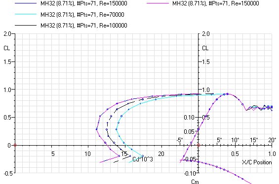

Consider the following 3 charts of MH32 polars. This one is at Re = 70 / 100 / 150K in Profili/XFoil, for comparison to DesignFoil:

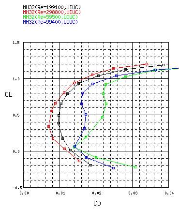

This is actual test data at nominal Re = 60 / 100 / 200 / 300K:

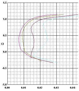

This is at Re = 60 / 100 / 200 / 300K in Profili / XFoil, for comparison to actual test data.
At least from this MH32 example, and being mindful of the different Re values, I think it's clear which is the better software, especially when considering the depiction of low-Re separation / breakdown.

Wind tunnel test data's validity at low reynolds numbers depends on the accuracy of the test model, the low turbulence level of the tunnel, the instrumentation, etc. I heard Dr. Selig talk at one of the MARCS National Sailplane Symposiums about 1989. He expressed the idea that people who have done wind tunnel testing tend to question the results but, others tend to take the data more seriously than they should.
Martin Heperle was complaining on his web site about some wind tunnel test data for the MH 32. He felt that inaccuracies in the test model made the MH32 look worse than it should in some series of wind tunnel tests.
Another case in point is shown in Fig. 2.14 of Soartech 8 on page 34. The figure compares FX60-100 tests at Stutgart in 1980 with Princeton tests in 1989. The drag coefficient results at the same lift coefficient and reynolds number disagree by as much as 60%!!!!
It sure makes you wonder.

Ollie - Yes. Although wind tunnel data is obtained physically, it still isn't the real (practical) world, and results from various sources would, to be meaningful, have to be obtained under conditions that are matching and proper, fat chance. Conversely, real aircraft have aspect ratio, surface defects, appendages, and aren't flown in air that's been "straightened."
BMatthews
Wildblueyawner, you're quoting profili / Xfoil. Can I take this to mean that the advanced features unlocked when I pay uses an embedded Xfoil to calculate the polars?
Yes. Profili simply melds a graphical front and back end onto XFoil to ease data entry and the output of plots - Basically turns XFoil keystrokes into mouse clicks. The analysis and computation has already been performed by XFoil when the databased airfoils were pre-processed by Stefano, or will be performed by XFoil when considering a modified or custom airfoil (see below re pre-processing).
ptxman
Is there generic 'code' available that takes airfoil shape + Re information & spits out resultant polars? If so, is this reliable? What are the limitations?
XFoil is anything but generic, based on its ability to handle low-Re conditions and the associated separation bubbles. It's capabilities are summarized here, plus links for downloading the actual XFoil files http://raphael.mit.edu/xfoil/
If the program spits out polars based on actual tunnel tests at measured Re's, smoothed or otherwise, isnt this basically a glorified graphical database? Doesnt this then pose a limitation if you modify an airfoil or request a different Re because it is then forced into some sort of intrepolation routine?
Whoa! Careful here - That plot of wind tunnel data I posted was NOT from Profili / XFoil. That came from here: http://www.nasg.com/afdb/index-e.phtml
XFoil doesn't simply interpolate chart data - It performs a real CFD analysis on the airfoil in question. A simple interpolation routine wouldn't handle the discontinuous function presented by phenomena such as separation.
A limitation when modifying an airfoil (or picking some weird Re other than the standard values in Profili) relates more to convenience - The time to generate a custom polar. This is addressed with a pre-processing option that can run XFoil on modified or custom airfoils unattended, then saves the polar data. Depending on the number of new airfoils, pre-processing can take considerable time (Stefano states that it took over 500 hours of pc run time to pre-process the 2200+ airfoils ==> call it 15 minutes per airfoil) but, again, it can be done unattended, i.e. click mouse, come back later. Generation of the polar charts for the included airfoils only takes a few seconds.

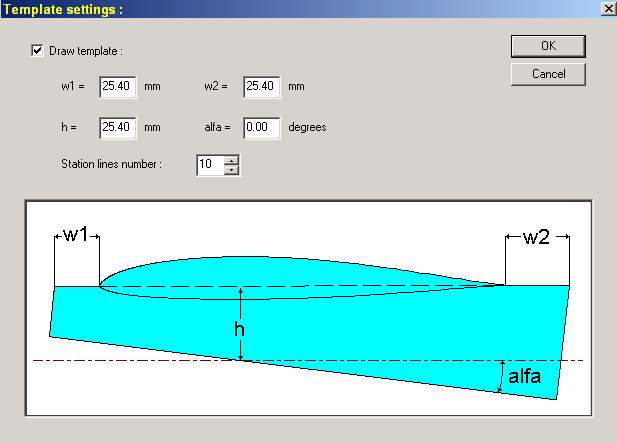

Does Profili allow you to consruct the foam templates for the upper and lower airfoil surfaces? While playing around with my registered version I've only had success with the upper surface.
Don't know yet - I've only tried Profili's analysis functions; will try playing with its geometric / template features. Will let you know if it handles upper & lower surfaces (I'd say a program of this type has got to handle both sides, otherwise the feature is pretty much useless).

The upper foam template can be obtained by specifying a negative number for "h" in the template editing screen:

Thanks Wild Blue! Worked like a charm--why didn't I think of that?
