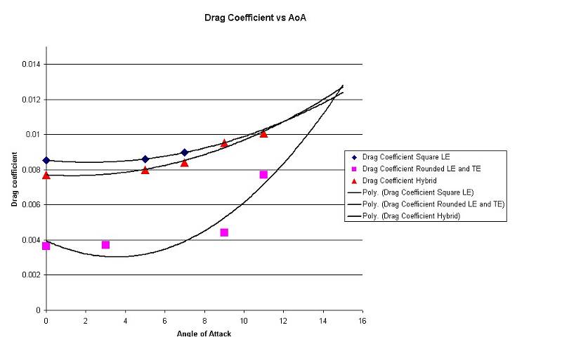

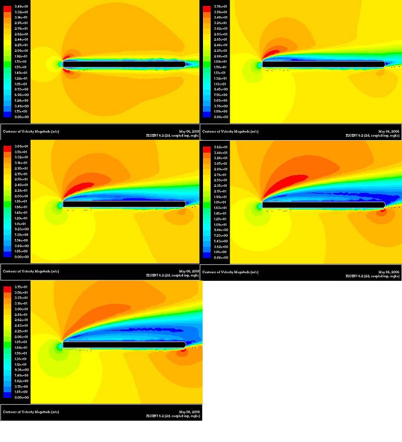

Well, this is not the first time I have seen this topic here. I'm a poor student so constructing adequate models and investing in the flow visualization and measurement equipment is out, but I do have access to a computational fluid dynamics (CFD) package called FLUENT. This is an extremely powerful tool for fluidic design as it allows for not only flow visualization but also measurement of forces/coefficients acting in any direction you would like.
The setup:
I tested a "square" stab with a length of 5" and a thickness of 0.25". This seems to be fairly standard for most model stabs. The model velocity was set to 60 mph at standard temperature and pressure. I varied the angle of attack from 0 to 11 degrees and mapped the associated drag coefficients. The attached images are at angles of attack of 0, 5, 7, 9, and 11 degrees from left to right. The same setup was then used for the same stab with full rounding of the LE and TE.
Results:
The flow separation on the square stab starts at or before 5 degrees and becomes much more severe as the angle of attack is increased. (visible by the lighter blue near the leading edge). Also, as expected the square stab has vortices that are created and shed off the TE (I would suppose that future work would be placed on analyzing the frequency of the shedding and seeing if it is in the audible range which would be pretty cool!). The round leading edge has a huge impact on the separation progression as well as the shed TE vortices. They are actually not visible in these shots because they are extraordinarily small and occur primarily in the boundary layer. I have also included a graph of the drag coefficient vs. the angle of attack. The trendlines are not totally accurate as more data is needed as well as real model validation. As is evident from the graphs the rounded leading edge produces a drag coefficient that is 50% smaller than the square edge.
The setup:
Results:

Sure, here it is. As expected the drag is lower than the purely square stab, but the the separation is still present at very low angles of attack. All in all I think this has made the case for at least rounding all surfaces for the best preformance.
I have included some other images generated by FLUENT. These are pictures of our SAE AeroDesign aircraft and of particular interest is the ability to predict the position and magnitude of the wing tip vorticies. We used this data to design our winglets and were able to test it prior to committing to a prototype. Fun stuff. As I am still only scratching the surface of what this program is capable of doing I welcome all opportunities to do CFD analysis for anyone who might have an interesting problem or is just after some baseline drag data. I have done things such as characterized turbulator placement by observing the exact location of the separation point at various angles of attack. This program does have 3-D capability, but the meshes are significantly harder to generate and the processing time goes up exponentially!! (the SAE aircraft took 178,000 iterations over almost three days[X(] ) So if there are any other flow mysteries or challenges I welcome you to let me know!!!
-Matt

Whoops, here are the other pictures. The rocket nozzle is one of the designs we are working on for the Air Force and NASA. It is about 1.2mm wide at the exit plane and will be placed on some of the new micro-satellites being developed.
There is a fair chance that the modeling shown is more appropriate for our models than not. It's been accepted that the flow we experience in our models at their low Reynold's numbers is more correctly described with fluid dynamics than by other systems.

Those are really kewl pictures. It's an excellent thing your sharing them with us. I hate to ask a favor, but......
Is it possible to describe your test profile as having a straight taper to the TE? Most of our stab/elevator and stab/rudder planforms have a flatplate stab with a rounded LE and with the elev/rudder surface having a straight taper to the TE. Usually the TE isn't "sharp" (It's thickness isn't 0.). It's usually a square TE, but is most often less than half the thickness of the stab and the LE of the elev/rudder.
If not, then thanks for sharing and for answering the extra request above. It's been informative.

Hey Matt, if it's not too much trouble how about running these again but this time with the more "standard" rounded leading edge and square trailing edge? Something that I'm not sure you can model with the software is the tendency to flutter. One reason often given for squaring off the trailing edge is that rounded ones tend to develop a stronger flutter while square ones have more drag but also a highly reduced flutter energy situation.

In reading the chart --
it looks like the differences from AOA are more linear in the square edged example.
Most of my flat plate square edged stuff flies at under 25 mph so I would suspect variences would be lesser in any squared edge / rounded TE etc..
