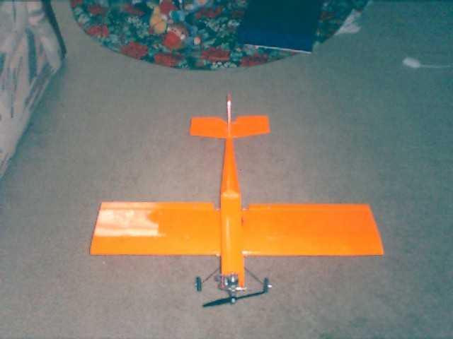

Hi guys,
was hopping for some feed back from you guys.Idesigned a lowwing plane.It has a constant cord wing, split elevator ,and large rudder.the problem is that the rudder has very little yaw effect. At hi speed when you kick the rudder it kind of stalls with the nose dropping and the plane just hagging there.I have another plane a contender 60 and has same caracteristics.Was wondering if anyone had any idea why they are doing thisboth planes have no dehedral in them. thanks for listening. appreciate any feed back.heres a picture of the plane.
joel
joel
Hmmm..... hard to tell. What about a side shot. Preferably right down on the floor so it's sort of like a plan's side view. And perhaps a top shot as well.
And how much throw are you using?

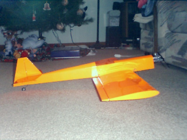

Here's the best shot i have of side view. Yes the contender does the same thing but a little more violent.If you hold it there with the contender it will slowly start to roll in a almost stalled condition.One of the guys i fly with said he heard of that condition but never saw it.the contender has a conopy too. when you look at contender from the top the fuse is shaped like an air foil with the nose cone on.I'm wondering if i should have put some dihedral in the wing when i built it.I like no dehedral though they fly real nice.They tend too track very nice. Ill be waiting to see you're replies.Thanks

I ask that because it's possible that you have some incidence that is being canceled out by the angle of the horizontal stabilizer, and that, in turn, is creating so much turbulence around the rudder that it's making it ineffective.
It's amazing how much the effectiveness of the tail can be affected by the wing. - Hence the fact that full size airliners have the stabilizer positioned as far out of the stream created by the wing as possible.

I'm with banktoturn on this one. It looks like you need to put a canopy or some sort of smooth fairing over that sharp step at the front of the turtle deck. I'm sure it's messing up the airflow over the vertical fin.

With the nice (he says with tongue in cheek) square nose you have a great drag producer. A little yaw and you get much more drag than a nicely streamlined nose would produce and you slow down. Stick the square nose in the airflow and the dynamic pressure aft of it drops. Lower dynamic pressure from any of the causes means that at the tail the initial high speed trim is no longer working.
You end up with the airplane slowing down and pitching nose down. Make a nice streamlined nose and try the maneuver. It might make the rudder more effective.

What percentage of the wing area is the horizontal tail area? Is it the angle of the picture, my perception or is it really as small as it looks??

the tail is arond 12% of the wing flies real good the tial is very sensitive even at that percentage.It looks smaller in the photo because of the angle.

I would suggest at least 20% and possibly 25% would be a better size and will help in stopping the nose down pitch you are describing. It will put more horizontal tail outside of the really messy goings on next to the fuselage (whatever they are and wherever they are coming from ). Then see what happens.

Ugly Sticks have a 20% horizontal tail area. Just excess rudder won't cause nose down unless there is a loss in horizontal tail effectiveness. You lose porportionally more tail tail effectiveness due to loss of dynamic pressure recovery when the tail is as small as the airplane in question. If it is just drag from rudder deflection slowing the airplane down both wing and tail see the same reduction in dynamic pressure and similar lift losses which would lead to some nose down but not as much as when the horizontal tail is wiped out.

Dihedral & Wing Vertical Location.
Wing location on the fuselage can affect the roll coupling of an airplane. Picture a plane with a low wing. Let's say you put in right rudder. Now the air flow is hitting the left side of the plane. The air flow tends to split at the center of the fuselage with part flowing over the top and part over the bottom. On a low wing plane, the flow going over the top of the fuselage goes over unrestricted and joins back up with the airflow. But, the part flowing under the fuselage hits the top of the left wing, pushing it down, causing a left roll, opposite to the rudder.
Visualize a wing with dihedral in a right yaw. With the wing cocked to one side, the air flow is now hitting the bottom of the left wing and the top of the right wing, causing a right roll. Conversely, anhedral causes roll opposite to the rudder.
This is the reason that most low wing planes need dihedral. The dihedral causing roll with the rudder should cancel the low wing location causing roll opposite to the rudder.
Conversely, high wing planes steer in the direction of the rudder. This is why Sticks with flat wings, like the Ultra Stick, will still roll in the direction of the rudder. High wing planes need anhedral to cancel the wing location and be neutral with regard to roll coupling with rudder.
Wing sweep does the same thing. Visualize a plane with swept back wings with right rudder. The right wing is now more in line with the air flow and produces slightly less lift. The left wing with right yaw is now more square to the airflow and will produce slightly more lift causing a right roll. Sweep back produces roll in the same direction as rudder. With a swept wing, you need less, or no, dihedral in a low wing plane. Sweep forward produces roll opposite to the rudder.
In summary,
High wing, sweept back and dihedral produce roll with the rudder.
Low wing, sweep forward & anhedral cause roll opposite to the rudder.
A designer can make estimates as to what he needs, but it is really a "cut & try" type thing to get all the roll coupling cancelled out.
With regard to your nose dropping, you may have some pitch coupling or you may be unconsciously corecting for the roll coupling, causing a slight loss os speed and the nose to drop.
