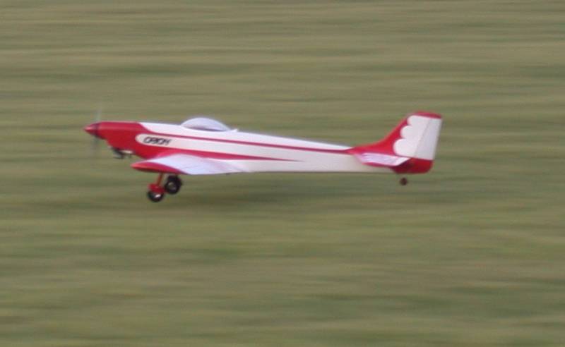

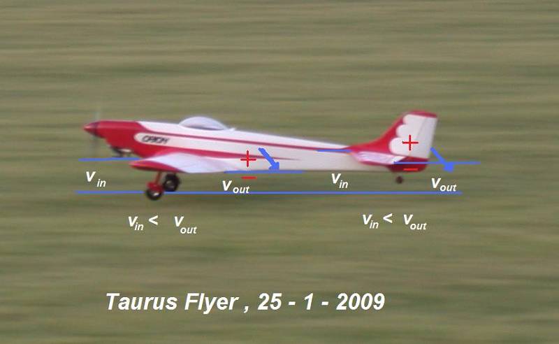

Ground effect is something I never argue about with other people, I simple use this to keep the retractable mains underneath my planes and to get the planes in the air, also because of the wind gradient.
(29,5 Oz/sq ft!)

Sideview, my Orion, design Ed Kazmirski world champion 1960 pattern, but a view procents bigger and some modifications to make a “sport plane†of it. The plane is aerodynamic the same.
30 years old inverted ENYA 60 4 C engine, span 69â€, weight 10 lbs.
In my thread "Redesign and reconstruction of the Oldest Taurus on Earth" you found some pictures of the modification of the cooling of the engine.
Classic Pattern Flying page 9 post 203.
http://www.rcuniverse.com/forum/m_79...mpage_9/tm.htm
I think the plane would not fly so easy without ground effect.
My advice, use an old REAL taildragger with as short as possible mainlegs, when you want to fly on grass with retracts, so you have profit of the ground effect.

When you did read my posts and understand, look to the distances between wing / ground and stab / ground of the Orion.
When these distances are the same and the airplane is right in balance (also downwash wing on the stab) it isn't important anymore on what level you experience the ground effect.
That is the reason I did tell, use a conventional real taildragger because when you take a tricycle and make it a "taildragger" it does not work. Then the stab is too low and the wing is too high normally. Think also on wind gradient if the wind blows!
Also the position of the CG has to be on that location that, because of the forward point of liftforces of the A-symmetrical airfoiled wing with high AOA, the stab is "loaded" and the total plane is your speed brake during landing. Look to the position of the elevator nearly horizontal.
During start, the situation is the same, I can accelerate on the moment the wheels do not touch the ground anymore before climb even retract the gear first.
I can make a full speed fly by on very low altitude and one times hit the ground with the propeller, after that I did make a belly landing on a distance of about 80 m in the next field without damage!
This is because with the real taildragger in high speed the wing gets the influence of the ground effect before the stab!!!!
Ground effect, try it yourself. I think the effect starts between a half and a quart span.
Picture to show the dimensions and fly by lower as on this picture!

Jim,
Look to the picture, my most simple explanation.
Daniel Bernoulli (Dutchman), higher speed of air lower pressure.
The air underneath the wing is forced through a narrow space, so pressure will be lower near the TE of wing and stab.
Above the wing the air is divided over a greater space, so higher pressure.
The pressure difference will give you downwash (blue arrows), (Newton) is equivalent for lift.
The dihedral is important to get a stabile flight, this will give a better pressure distribution and less loses near the wingtip, third picture.
