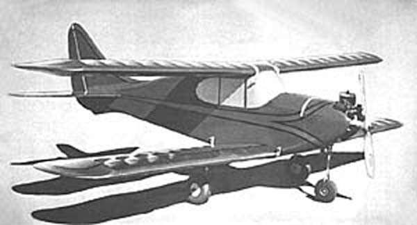

I am in current design phase of a biplane. All previous design experience has been with tricycle gear on monoplanes. I have been trying to find out why there are mostly tail draggers for biplanes and very few tricycle setups. Any comments would be appreciated.

Main reason for designing a biplane is for maximum lift on a small wingspan. I'm trying to get a 13kg lift out of 183cm wingspan.
From what I have seen conventional gear landings can be difficult with heavy loads.
I am not sure how heavy loads will work with conventional gear, stearing could be difficult on takeoff.
Asthetics are not a problem, as funtionality is 1st priority on this plane.
I'm not even sure where I would mount trike gear on a biplane, very little documentation on it?

--------------- I am not sure how heavy loads will work with conventional gear, stearing could be difficult on takeoff. -------------
With conventional gear regardless of weight because the CG of the airplane is aft of the wheel contact with the ground it becomes an unstable system. As the airplane is rolling it hits a bump which offsets the CG from the centerline and it tends to want to keep on going. The tail wheel helps stop this until there is a transistion where the tail wheel is not providing much steering and the tail is not providing much aero help.
When the motor is adequately powerful it can literally blast stability into the system through a thrust vector and the vertical tail. Of course the bigger motor brings torque problems with it.
With a heavy airplane the problem comes with the increased moments of inertia in yaw. Once the airplane starts yawing it takes a lot of directional stability to stop it. You tend to over correct and end up with a ground loop. Again lots of power and directional stability will help keep it going straight.
Trike gear is stable. When you get the airplane moving and a little ground bump hits a wheel the inertia of the CG tends to straighten the airplane out.
------------- Asthetics are not a problem, as funtionality is 1st priority on this plane.
I'm not even sure where I would mount trike gear on a biplane, very little documentation on it? --------------
Look at any trike geared airplane and copy it :-) My main approach.
The main wheels are perhaps 5 percent of the wing chord aft of the CG. Too far aft will make it difficult to rotate to take off attitude. Too far forward will not let the nose gear have enough weight on it to allow steering to occur. The nose gear should be located basically as far forward as structure allows. It allows steering with small side loads, something good for large airplanes but not a problem with models.
You want to allow enough clearance with the aft fuselage to allow rotation to the takeoff angles needed. There is a weight lifting contest held every year that some others may know about, I don't remember the name of it. Sometimes the tail cones are slanted upwards to 20 degrees to allow rotation of the wing. Conventional gear setups in this application can't rotate too far so the wings have to be set at a large angle with respect to the fuselage.
Weight lifting airplanes should probably go with a tricycle gear.

If you're trying to lift a heavy load with limited wing span be sure to watch out for the interplance spacing. For best performance they need to be something like 1 1/4 to 1 1/2 chord widths apart to minimise interferance between the airflows which will dampen the lift. Many of the racing biplanes of the 30's ignored this as a tradeoff for speed but they didn't much worry about higher landing speeds as long as they were tolerable.

I thank you for the comments, great help. I will continue with trike design. You have confirmed my theories for take off with conventional setups being unstable especially having a small engine.
BMatthews,
I have current design plans as you mentioned. 1 1/4 chord spacing, and wing tips. It is a weight lifting competition.

The Claude McCullough scale model bipe that I mentioned above with the trigear was the Wynn
Air Car I believe from a foggy memory. Still haven't been able to find the pic. of it in all the clutter!
The Kraft model isn't bad but that Gwinn..... oh my......
If it was an area limited event then mono would be the way but with a span limit the biplane could be a possible winner here.
The high winds would mean that the model may not do well with the end plate interplane panels but then again it might.
I think I'd be tempted to keep the thrust line centered between the wings and the cargo bay between the thrust line and the lower wing. Keep the CG a touch low in otherwords but not TOO low or other oscillation factors may enter into the mix.
