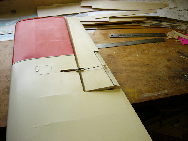

I put them on my old beater 1/4 scale Corby Starlett's ails. 10 % of ail area. Best performance was about 10% pos. incidence to airflow. I kept coming in on the tab horn and all of a sudden the roll rate just about doubled, or servo had twice the torque. I'll see if I can find a pic.

It is a free lunch. I don't know why the guys with the 1/3 scale Cap 232s and such that have to use two or three servos on the surfaces could have the same thrust with one, using booster tabs. Seems I read somewhere, where the bigger transports, 747s and such, only drive the booster tab with no mechanical,hydraulic connection to the elevators.

How do boost tabs work? It is a simple matter of physics, a small force and a long lever arm pushing at the end of the moveable surface. I've been told that Burt Rutan once flew his full scale VaraViggen with the ailerons powered by a single Futaba 148 servo driving the boost tabs.

You have a valid point, one I have been convinced on for more than ten years. When planes first started getting really big, a few people tried tabs but for some reason they never caught on. I think it's mostly a paradigm. The big names all use multiple servos, so everybody else wants to. Big models could be finished cheaper (maybe, though the labor cost for the airframe would be greater) and maybe a little lighter with better aerodynamic counterbalancing and one servo per surface. But, many people validly worry about the loss of redundancy with only one servo. Also, (and this is a biggie and probably the main reason tabs didn't catch on) with the big 3D models doing blenders and walls and such, boost tabs will not help hold the surface in position against the massive drag forces present during those maneuvers. You would need nearly equal forward counterbalancing such as 25%-33% offset hinging on ailerons (which almost no-one does) and large leading counterbalances on elevator to make up for the reduced holding power of only one servo. Also, with the aileron supported at fewer points, it would have to be built stiffer and a little heavier to prevent flutter, though servo tabs can help with that particular issue if istalled well away from the servo arm. It would really be accomplishing the same thing with a different technique. Offset ailerons hinges are more complex and heavier but you can lose servos if you use them. So if you're willing to do the work, you can save money on servos, wires, match-boxes, servo programmers, and batteries. It's just plain faster and cheaper for the ARF builders to make butt aileron joints than it is to go like full-scale and make offset aileron hinges.

Thanks for your comments. After your comments I tested in the close hole on the tab horn and the roll rate was diminished. Obviously my linkage is different and the sweet spot was not found. Your front horn is not clear in the picture. Something about the geometry is still a mystery.
Bill

I bet the tab was stalling at the higher deflection, negating it's effectiveness.

The horn on the wing is as close to the surface as I could get it and close to the trailing edge of the wing as I could get it. With the deflection of the aileron shown, you can see the deflection of the trim tab is a little lower than the airflow of the wing and maintains that deflection all the way to full aileron travel. The horn pushrod on the trim tab is right over the hinge line as you would do on the elevator or ail horn. When the ail. is at the neutral point. the trim tab is too, although that goes without saying.

After your comments I tested for several flights at the close hole on the front horn and the far hole on the rear horn. The airplane would twitch in the air but I kept testing anyway. This morning I moved to number 3 hole on the rear horn and the twitch stopped.
I am getting closer. Thanks for your help and comments.
