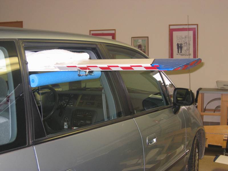

I made aileron boost tabs for a gas pattern airplane that seems to have a sluggish roll rate. The tabs turned out to be 15% of the area of the barn door ailerons. Cannot wait to test the concept but it is too cold to fly.
I am guessing that no convenient method exists to measure servo loads and verify effectiveness.
When you are uncertain about the geometry where in the slipstream should the tab be for initial testing? I would guess that a few degrees of positive into the slipstream when the aileron is deflected would avoid oscillations or flutter due to linkage slop.
Bill

Old 02-17-2007 | 09:55 AM
Joined: Sep 2004
Posts: 3,312
From: Greensboro, NC
Default RE: boost tab question
I've done this on several planes, yes it does relieve a lot of the servo load. However, I feel that anything over 10% of the area is to much, especially on the elevator. You may have trouble at neautral positions with 15%, it will try to hunt.
Everything was made by guess prior to calculating areas. I will test at 15% and cut the ends of the aileron stock if the tab area appears too large.
What is really needed is instrumentation to measure the force at the servo. Maybe measure the current to the servo or a strain gauge in the linkage. Maybe as technology improves the rocket scientists among us will eventually come up with a way for the rest of us to measure servo loads and such. Seems like everyone is always guessing and speculating about the dynamics of the airplane (servo load, battery size, servo torque required, battery voltage under load, rpm, etc.). Oh well … my flying skills are not likely to observe oscillation unless the thing self-destructs. Wish you were close enough to test fly for me.
The concept is fundamentally sound and the boost tabs and linkage were simple and easy to make. So I am forging ahead like I know what I am doing. I don’t.
I have also noticed that the linkage would be extremely easy to connect directly to the boost tab. Pulling the tab into the slipstream would move the aileron. Hum … piano hinges maybe. Oh well … cannot measure the results and shouldn’t destroy the airplane.
Bill
Cabin fever
Too cold to fly, not enough to do, and cabin fever brings on a touch of insanity. Maybe I could hang the wing out the car window at 70 mph measure the servo current and observe the deflection. Another day or two of cold weather and the idea will sound better and better. Oh oh, after only a few minutes of thought the idea sounds better.
The wing will fit inside the van. It sticks out about 30” to the right and can be held in place by the windows. The servo leads are inside the van and an extra RX is available.
Anyone have any thoughts about what and how to measure before I get arrested?
Bill

You're going to be surprised at how quickly the wing out the window vanishes when you deflect the surface.
You're working with many pounds of force, not ounces.

I would say that measuring the current woud give you an idea of the servo load. But as Paul pointed out lots of force involved in the test be sure your wing is secure. Unlike NASA and the aircraft Manufactures we do not have the money for instruments to make measurements so there is a lot of guess work involved...
perhaps a pull scale like used to weigh fish could be connected to the control surface could be used to measure the force to deflect the control surface.

Well Paul I was not planning to turn the wing sideways hanging out the window. I only want to know the force at the servo connected to a 2 1/2 by 20” aileron deflected 30 degrees.
I just finished driving down the road at 55 to 60 mph and the wing is very stable and secure. A slightly better arrangement to make sure the wing is parallel to the slipstream would be desirable but probably not necessary.
I am leaning towards assuming that servo current is proportional to the mechanical force against the servo. If data cannot be found the assumption can be verified on the bench at a later time.
Bill

Oops, a conceptual problem. The wing will not be able to deflect with aileron movement, which will present a worse case scenario that will never be seen in actual operation. Compensation will be necessary to get reasonable data. I suspect the first and simplest approach will be to back the speed down.
I am making amp meter leads now and will post findings even if they appear silly. Will also post a picture of the test rig.
Found it necessary to brief the test driver and wife. She giggled furiously and seemed perplexed.
Bill

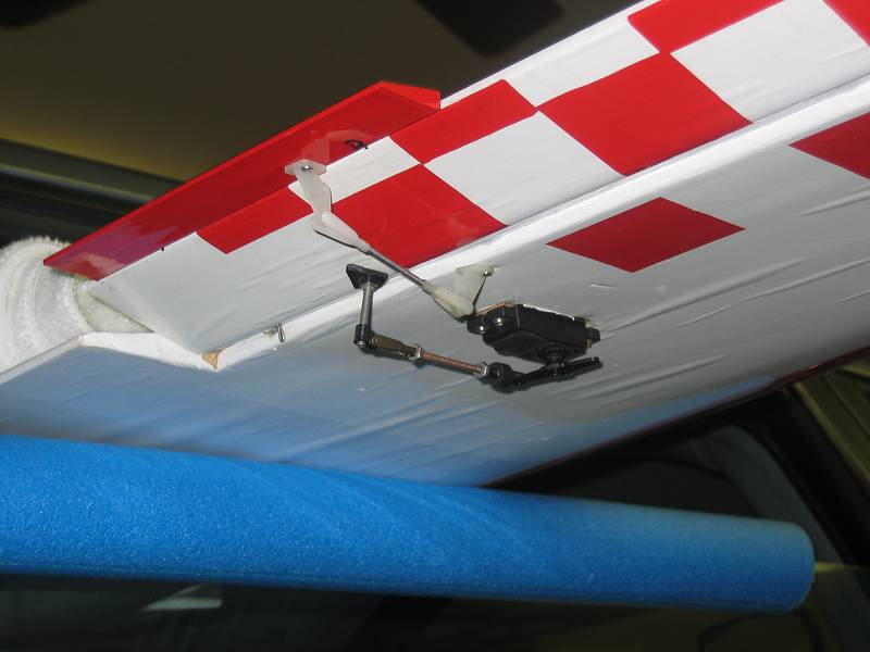

The meter is a Fluke 73 and the error is probably operator. The readings are incorrect by a minimum of 0.01 which is the reading without servo connected. The meter is not auto ranging on the amp scale and will not resolve in the third decimal place. The no load value could be between 0.005 and 0.015.
Aileron barn door – 2 1/2” by 19 3/4” = 49.4 sq in
Boost tab – 1” by 7 1/2” = 7.5 sq in
Servo - S-148 Futaba analog
Stall current – 0.60 amp
No load current – 0.02 amp
Both pictures show the test setup. The boost tab hinges have not been epoxied since reference values are needed before permanently adding tabs.
The driver returned after dark so the data will be tomorrow.

No accidents. No arrests. Lots of comments from the peanut gallery driver. Lost one of the driver’s towels. Data varied 10% during the NO tab run due to 8 to 10 mph wind and direction of travel. Decided removable tabs would be necessary to verify results on a calm day and to facilitate changes.
NO tabs - to 8 to 10 mph wind
20 mph Right (down) ail 0.10 amp
20 mph Left (up) ail 0.13 amp
30
R ail 0.11 amp
L ail 0.14 amp
40
R 0.14 amp
L 0.15 amp
50
R 0.14 amp
L 0.16 amp
60
R 0.15 amp
L 0.20 amp
With boost tab - 15 to 18 mph wind
20
R ail 0.12 amp
L ail 0.06/0.07 amp
30
R ail 0.13 amp
L ail 0.09 amp
40
R 0.12 amp
