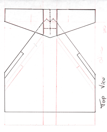

If I figured it right my aspect ratio is 6:1...
Root cord is 84" Tip cord is 36" span is 3'

Aspect ratio is span squared divided by area, your wing with a seven foot chord and three foot tip averages as a five foot chord and three foot span. A/R is then less than one, stall will not be a problem, getting it to stall might be.
Evan, WB#12.

Primmnz,
Make sure I have this right..
Span squared = 9 ft
Wing area = 15 ft
So my aspect ratio is .6.
So I am worrying about nothing!
Da Rock,
While this has the proportions of a delta it is a backwards one. Any Idea how that may effect the flight characteristics?
dick,
With this design I am ggoing to be going from a thickroot foil to a thin tip foil, with the top of the wing flat to provide dihedral.
Please check out odball design 101 in the scratch build forum.
All comments welcome!

Iron Eagle, you have a `reverse delta' for want of a better term, tip stall will not be a worry. with normal deltas the wing has plenty of sweepback for stability (works like dihedral) but I see yours has forward sweep. Probably not a huge problem, but I would make those tailplane/elevators into tailerons for roll control, rather than those tiny ailerons.

I have intended to make them work as Tailerons but had no idea what it was called, these will also be linked to the ailerons, and the elavons in the vectored thrust setup.

Fine, but so long as your CG is in front of the aerodynamic centre, and it will be for a pitch stable model, then you don't need a reflexed airfoil, any good symmetric (zero camber) foil will do. This stuff has been known from the early pylon racing days, when 0.19 powered deltas ruled, way back in the early `60's. The foil you have chosen will result in an inferior flying model. Remember, it's a delta, not a `plank' type flying wing.
Evan, WB#12.

Last night as I worked on the design after getting back from the field I have decided to scrap the use of a reflexed foil on the wingtip. This is not going to be a flying wing per say so using the reflex at the tip is not going to be of much use. On top of this this sill be so lightly loaded that the landing should be very tame. I do have one additional question on Jacks Northrop's original flying wing when it got into ground effect it would stay there for a long time, does anyone know what they did to resolve this?
I think I might see the same thing and was thinking about adding a spoiler/airbrake on top of the fuse to get it on the ground.
