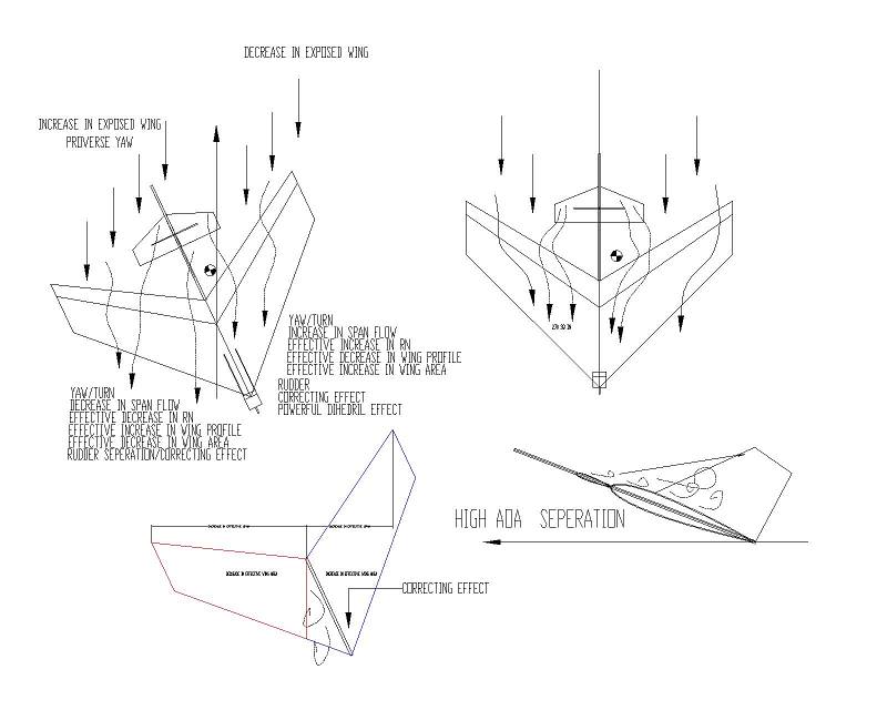

I have attached a file of the concept. no aircraft built at this time for obvious reasons.
I believe what is drawn is correct in theory but feel free to comment if I am not understanding things correctly

The attached image is nothing more than a sketched that outlines/defines the separation/interactions of a forward swept wing.
There are several books & online articles that outline the basic proportions & locations of the wing/canard for the attached sketch.
The one thing I have not found is rudder area/design

Not to be argumentative but I do not see a tractor configuration as advantageous…
My reasoning is as follows:
a.) the separation/turbulent flow amplitude cause & effect of the canard/main wing coupled with turbulent flow of the propeller wash is a big question mark.
I would have grave concerns about deep stalling utilizing a tractor prop
b.) I would speculate the pusher configuration will gather the turbulent flow & direct it across the rudder giving an effective rudder control increase @ high AOA
But the question still remains, how big
Please feel free to correct me if I have misspoken or my understanding is incorrect.

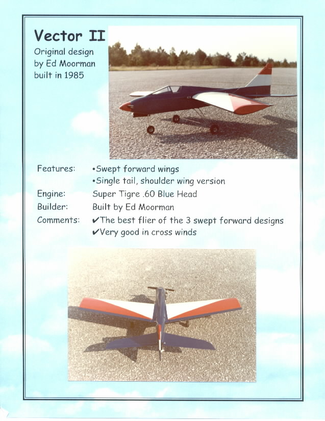

I see the point you are getting at. However, I feel that the airflow behind the prop would be "recharged" allowing the canard to operate more normally at a high AoA versus if it were entering clear air. That same charged air would also flow over the rudder as well. If the motor weigh was a hypothetical "zero" then I would put it in the nose. The only reason I wouldnt is because of the possible difficulties in getting it to balance out correctly. I think you are right about the turbulent airflow gathering and passing over the rudder in a pusher config, but I still feel like the airflow from a tractor config would be more energetic even after blowing past the canard and fuselage. It's really just an academic argument because the pusher config is the best option for your application all things considered. I've got a book by a guy named Lennon that will have the answer you're looking for. I'm going to dig though it tonight and report back to you.
My buddy, who builds, but does not fly any more-he's 85, and I are on our 8th canard, one of which was an SFW. Several years ago I also built 3 conventional SFW planes.
The conventional designs fly very well. They are good in cross winds. I did use a slightly larger vertical area. Normally, I would use 10%-12%, but went to 15% and had no problems.
Two of our canards are tractors, one with the engine in front and the other is a twin with the engines on the wings. We did convert the tractor canard to a SFW design for a try. I managed to flip it on take off and my buddy didn't want to fix the wing so we never actually flew it other than a 3D type tight loop.
There are 2 problems with a tractor, SFW canard. First, the prop blast is directly on the elevator. This gives you very sensitive pitch control. You have to watch it on take off unless you are slightly nose heavy. Second, sweeping the wings forward effectively shortens the plane. You end up with a very short coupled plane with the engine blowing directly on the elevator. In addition, I think the plane was balanced more to the tail than the straight wing version. Since I have flown 3D planes with the CG way back, I felt I could handle a half inch to the rear. I got a big lesson in not messing with the CG Gods. I rolled down the runway, put in my normal amount of up for take off and it did. But it kept on going and filpped around. I nearly made it back to flat, but managed to get a wing tip.
For a canard, find yourself a good CG program and balance it conservatively. I have one if you need it. I would also figure out how far you put the wing from the tail in a straight wing layout, then find the MAC of the SFW and adjust the fuselage length to match this.

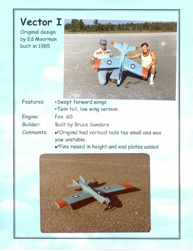

The twin tail plane was the one with the fins too small. This is when I learned that 2 fins fairly close together are like biplane wings without a wide spacing, they aren't as effective. I calculated the size of the fins & rudders and split it in two.
The plane took off OK, but slid sideways in turns rather than tracking around. When doing a stall turn, you could do a 360, turn, although you could also get into a flat spin. In level flight at half power, you could do a tight, flat spin/turn. It would swap ends with full rudder.
We added 1 1/2" to the top of the fins and an inch to the leading edge and also added end plates to the fins. This cured all the problems.
