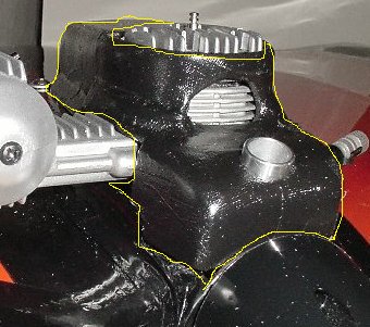

I attached my picture again with yellow outline to distinguish between the fuse, cowl and spinner. There is a little flat area (less the 3/8")in front of the carb that could not be avoided on this engine. The front of the carb comes up to the nose ring and spinner and I saw no other options. My Jett engines will work out a little better in this area.
I have tested different props over and over before and this may end up being similar to get the best results. I read that a cowled engine can give you up to 12% increase in speed. If I get 1/2 that and not burn up my engine I will be happy for awhile.
Thanks for your input

Sorry, I've been typing about this issue so much that I'm getting sloppy. The opening you have looks suitable for your engine for maximum speed.
The sizing equal to the cylinder is a starting point for general use models. Everyone interested in maximum speed expects to work down from there, and most have some experience and rely on that to figure their first opening size. And often expect to work that down.

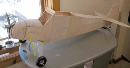

Da rock
I did the same thing to my GP Skylane as you did to your cap speed was not a design goal but I wanted the motor to get better cooling than just cutting out the cowl openings and dumping the air into the cowl. A bit of foam and balsa made for light baffles and worked well.
My cub cowl is a bit more aggressive...
This was not designed for speed just wanted it to look good, and work well, as I told Mike the hardest part was setting up the exhaust which I ducted through the fuse.

Iron Eagle,
Looks good. I would make one suggestion. The engine part that has to dissipate the most heat is the heat. That should always have access to cooling airflow.

BTW, a flying buddy just finished an Edge ARF with a BIG 4 stroke in it. The cowl had two huge openings. The engine happened to be mounted at 180degrees however. And he had only cut the cowl to clear the front part of the head. Basically, the front of the engine was shielded from the airflow. The engine ran like crap. He wanted to know if I thought he had the wrong prop for that engine or if it just wasn't a big enough engine. It was touchy, ran rough and didn't seem to have much power for a 1.50FS. My advice was to open the cowl in front of the engine and close off most of the gaping holes that weren't doing spit. Darned if he didn't take the advice. Bloody engine runs like a locomotive now and the airplane is trimming out to be an excellent flier. And incidently, he's running the same prop.

Da rock
It is hard to see in the photo because of the angle but the top of the head is even with the bottom lip of the cowl intake. I also have the top of the cyl and head in front of the exit to the cooling exhaust duct so it should get the best flow, at least that was the idea. Here is a side shot where you can see the cooling exhaust. You are right it is a lot of fun carving out your own designs.

#34
Mike was saying in his post in the speed forum he seems to be getting a little better than 120 mph passes with the beast. He has not had any know cooling issues with it thus far, not bad with a .46 I would say.

Posts: 2,025
From: Tulsa, OK
I finally remembered to touch the cyl head right after a landing and it was too hot to leave my hand on but I could touch it briefly without problem. It was a 90*F day. During flight there is no sign of overheating. I left the cowl on for all flights on day two. I think I am OK. In time I will get a speed check without the cowl to see if it does anything other then make it look good.
