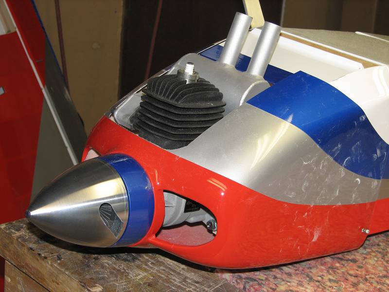

for drag and cooling issues, should I close up part of the area behind the cylinder head? If so, how much of a opening is needed for cooling and should the opening be lower or even with the cylinder head?
Any thoughts from the experts?

If your goal is to have the least drag for the fastest possible airplane, you need to look at some of the CL speed airplanes.
The lack of streamlining behind the engine in your mockup is going to be very draggy. And with the front profile, that rear area isn't going to be doing much cooling. Your flat front isn't really doing a lot for you either. There is a lot of just plain flat plate up there. And your cool air opening really isn't large enough.
Speed guys learned long ago to completely enclose the engine and then control the intake area and heat exhaust areas to perfect the cooling. They discovered they could cause the engines to run too cool that way. Or too hot. But either way, the complete coverage was the way to go fast.
They also found that they could reduce their intake size with higher speeds. Of course, they didn't have to taxi out for takeoff. So they often had less cool air opening than the area equal to the fins and head. But it almost always was an opening that went from the carb intake to the top of the head. The width was what was usually tuned in size. And the exhaust area would be what was quoted from Andy's book.

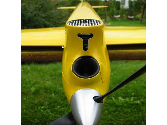

da Rock,
Are you saying my cowl doesnt look like the attached?
The opening on this cowl looks very small to me.
It seems I could build the plane in the the time it will take to get the cowl right.
The opening on this cowl looks very small to me.It seems I could build the plane in the the time it will take to get the cowl right.

Yes, your T shaped opening is T shaped.
But a cowl is all the stuff from front to back and bottom to top. I'm going to take your
to suggest humor and answer the question about the opening size.The picture of the speed plane is just that, a picture of an airplane that's evolved (important point: evolved) to fly in a somewhat narrow speed range. BALLS2DAWALL speed range, but still fairly narrow and very predictable. So the builder had a real good handle on how fast the airflow was coming into that T shaped opening. And he also had the luxury to whittle or fill. And that little opening had a really important secret. It fed a closed tube that tightly surrounded the engine AND MOST IMPORTANTLY that ended at an opening that was in negative pressure. The T you see in the picture was actually only half the reason the engine got cooling air, and probably not the most important reason. The streamlined cowl behind the engine and it's opening was doing a TON of the work to cool the engine.
BTW, the cowl you see in the picture is one of the easiest scratch built structured you can ever hope to do. Wrap the engine with a couple layers of masking tape to give the appropriately tight clearance and two sides of wood "pin" right up on either side. Cut a hole in the top plate of wood to fit the engine head and cap those two sides with that plate. You're almost done. Block sanding some, hand sand a little more, and you are.
I'm not trying to insult you but I gotta suggest that what you've got probably isn't going to streamline that airplane. And from what I've seen, it could easily cause your engine to run hotter than it would without it. It just might have more area than the engine has and actually is shielding a good part of the engine. And then actually keeping air away from the back of the engine. Sorry to be blunt, but I don't know any easier way to say it.

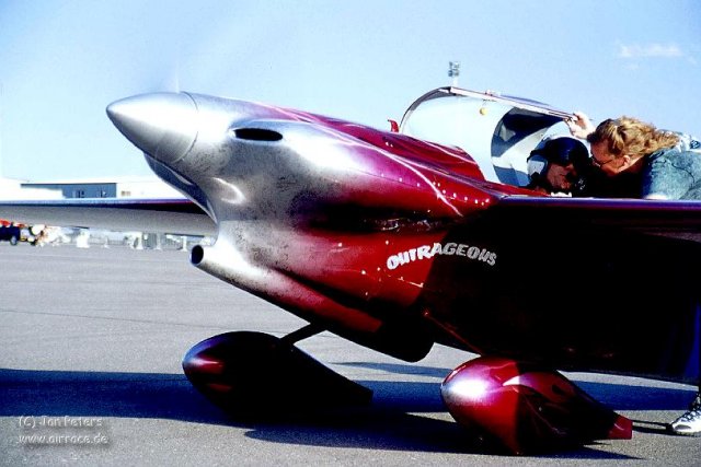

As long as you worry about inlet -NOT the oulet path - you are missing the boat .
No air is forced in the cowl---
none
zero
nada
A DeBolt speedmodel from 1950 will show you what you really need
as will a quick look at 1930/ 1940's inline engine o rpresent full scale racers .
as long as there is a good setup for the high speed air flowing over the fuselage, to extract air aft the engine - it will cool.

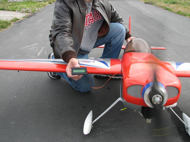

remember -- it ain't the size which matters - it's knowing where to put it ----
frankly the size thing on cooling is such a vague thing - for getting the job done right - I never use it.
the attached photo shows another setup which worked .
essentially the new upper inlets flow , allowed a shorter path around rear of cylinder
as you might guess, the rear of the cyl is the "hot spot"
On the second setup --the scale inlets get blanked off.
on last picture --the inles getblanked - note the duct aft the muffler - it creates a low pressure in the cowl abofe th muffler - this is again -to reduce heat at rear of cylinder .
lots of techniques --
moving the prop as far forward as possible from the cowl, is another good idea.
it is a full scale practice - not in any model airplane books --yet

Posts: 2,025
From: Tulsa, OK
Lots of good info here and it seems the right size in the right place is the key. However, form all the pictures, there is more then one way to get the job done. Here is a picture of my latest attempt and it may get mods depending on what Andy lennon's cowl chapter says or what you guys say.
I used contest balsa and wrapped it around the front half of the cyl. There is a medium size opening in the front with a height of the cooling fins. The cyl head is partially exposed and the tapered outlet to the rear is at least 1.4 times the fin area. This cowl design when finished will be tested on a inexpensive engine before going on a speed engine.

If the speckled grey stuff is your cowl you need to consider streamlining the area around the carb. Streamlining is not just putting a slick surface on the shapes you've got to enclose. What you've got down around the carb isn't really going to do much of anything in the way of streamlining that area of the airplane. You've still got basically a large flat area almost perpendicular to the airflow. Look back at that yellow speed plane's entire front end.
