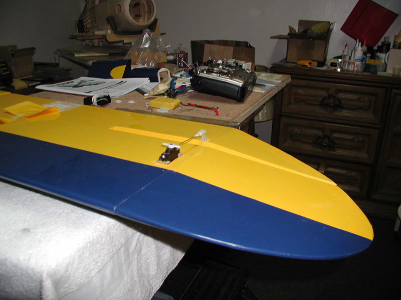

I have a Speedy Bee by Clancy Aviation. It is a shoulder wing short coupled plane. The wing cord is very large and is a flat bottom design (some say semi semi semetrical).
When flying at very slow speeds the plane is pretty stable. However, when the speed is increased the plane will suddenly dive (Bee Tuck). The dive can be recovered with the elevator. This dive is unpredicatable and occurs without warning. Any theories on why this happens?
Two things occur to me. One's the radio, the other is the wing mounting.
If your radio isn't given to twitching the elevator, then I would suggest you secure the back of the wing so it doesn't lift off in flight. Perhaps a screw, or tape, or additional rubber bands.
We see a similar phenomena on high wing planes with rubber band mounts. With only four rubber bands, the front of the wing will lift, and the plane will climb abruptly (usually during a maneuver.)
In a similar fashion, the lift from your wing could be causing it to lift at the trailing edge, causing the plane to dive.

SCAR, thanks for the quick reply. As a matter of fact, the picture I posted is not my plane. I modified my plane to allow mounting the wing with bolts instead of rubber bands. The wing s secured by two bolts - one in front and one in the rear of the wing.
Other modelers who experience this "Bee Tuck" have attributed it to flying too fast. They say the plane was designed as a slow flyer and at high speeds, the main wing turbulance reduces the effectiveness of the horizontal stab and elevator. That is somewhat beleivable, but I thought I would try for a more technical explaination from the experts here on RCU.

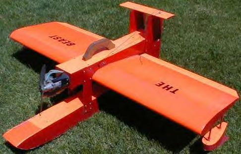

As I was reading your answer to the tuck, a few things from way back clicked. First, Ed Westwood designed a couple of flying wing or partial flying wing seaplanes back in the 1980s. The first was the Beast, a low wing, single float seaplane. It has a reflex airfoil similar to Evans' Simitar airfoil except much thicker. The Beast also had a small, fixed stab mounted atop the twin fins. He (Westwood) said it aided pitch stability.
His second design was the 2 Ugly, a shoulder wing, short coupled, twin float plane using what looked to be the same airfoil except this time he used a very small, low mounted stab and elevator. I just scanned the plans (which I never built) and it appears to be about 10% on the wing area. Both planes were reputed to be good fliers. Both had reflex airfoils and small horizontal tails.
My 3rd item that clicked was my own experience in the 1980s with flying wings. Mine were rectangular plan form with symmetrical airfoils. I had started with elevond, but didn't like the roll characteristics, so I switched to separate ailerons and elevator. After testing and rigging, I found the best set-up was with the ailerons reflexed upwards and the elevator neutral. If I didn't use the aileron reflex, the plane would pitch down if I lost power as the elevator wasn't large enough for total pitch stability and control. I assume that the prop blast was aiding the pitch control.
