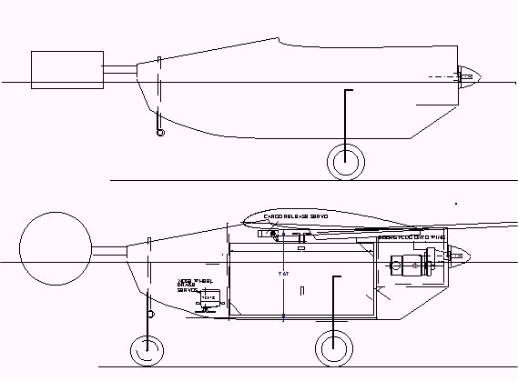

Oh, and by the way, our school wanted to do a twin-boom design like yours for optimal antenna placement, but it is in defiance of the rules to have part of the aircraft's structure obscure the 360 degree "view" of the antenna. I think the only exception is wing struts or landing gear legs. I'm not sure if the SAE competition has different rules, but your A-Tail design would not be legal with the antenna in that position.
I didn't see that fine point in the rules about the antenna view, just that it had to be 3 inches from structure.
A later redraw on mine places the thing with the flat sides vertical, behind the fuselage, so the round side faces the airflow.
And thinking further, it could be mounted on the "sensor" box so that after the box is deployed, it will rotate to the upright position.
Just shows what a leaking mind can come up with!
(Since finding a small r/c Humvee isn't panning out.)
#55
You shouldn't read into rules the intent.
If it's not specified, it's not a rule.
For instance, both these installations fit the rules in my opinion.
Unless there's a clarification somewhere, the antenna need only be spaced off the airframe... orientation not specified.

Paul, the 360 FOV requirement was actually made in the FAQ:
"Question: Can fairings be applied to the fuselage that “in effect” fair the antenna if they remain at least the specified 3” away.
Answer: No. The statement “the antenna must not be faired in any manor” can also be viewed such that the “antenna must have an unobstructed 360 degree horizontal field of view”. An exception to the field of view will be made for the vertical tail(s) and/or wing struts. "
Otherwise, your "ahead of the nose" configuration would be an extremely smart way to go - the wake would impinge on the fueslage and reattach, substantially reducing the drag increment from the radome. Balancing would be the only problem I see, and could be taken care of by moving the payload for that config.

Prop clearance of the deployed payload is a problem. How to get the plane past/over the box after it's dropped, and not have the prop hit it...
The number of ways to skin this cat....
Sound crazy? Yep. It works, though.
#59
Originally posted by Starfire
Not if you pitch the payload out the side!
That's what I thought you guys were doing...

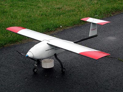

Greetings fellow DBF-ers!
I just want to say congratulations to everyone who was part of the DBF competition this year. It was a lot of work, but it was great fun to see all the different teams and check out the many different design philosophies. I hope you all continue with the competition next year as well!
I've been building models for many years, but this was my first time with DBF and it was quite a thrill. I'm a grad student in chemistry, so there were challenges just finding time to get together with the aero guys.
Below is a pic of our plane... it might look familiar to some of you.
best regards,
David Fee
SDSU DBF '03
Below is a pic of our plane... it might look familiar to some of you.best regards,
David Fee
SDSU DBF '03
