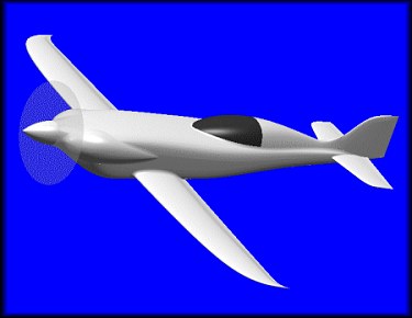

What I'm looking for is optimum high speed wing tip shape with a plane I can safely land.
Is it really that much of a drag reduction advantage to make the wing razor sharp at the wing tip vs just leaving it cut straight off with a 1/2" thick airfoil. The attached image is the Wing planform. Sorry I don't have a better photo of the wing tip.
If the there is sizeable drag reduction in the trade off, it would be worth it. If I'm knocking off 2 MPH at 200mph, I'd rather opt for the nice handling thicker wing tip.
So how important is it to have a thinner over all wing in terms of pressure drag.
How much will drag increase with thickness of an airfoil. Lets say plane "A" has a mean thickness is 1" vs Plane "B" with an average 1.25" thick. Both planes are 36" span, 36" root.
Actually what we are talking about here is pressure drag. Is it really worth trying to get the thinnest wing possible. I guess what I asking is, Is it more the smooth airfoil that's going to make the difference in overall speed or is it actually how thick the pressure drag that predetermines how much drag is created?
Thanks to all who have answered!
Blue Skyy

If you check out this link to the Polish designed PZL-130 "Orlik" advanced miltary turboprop trainer, I think you'll be impressed by the wing tips: http://www.pzl-okecie.com.pl/orlik.htm This type of wing planform (although the aspect ratio is obviously stretched considerably) is often used in high performance gliders where streamlining and drag reduction is crucial. This is one very efficient low drag wing tip and overall wing planform. Cool looking plane in my opinion!

Old 04-24-2003 | 05:06 AM
Posts: 604
From: WinnipegManitoba, CANADA
Default Nemesis Nxt
Wow - your pictures of the carbon fiber Nemesis follow on got me looking for their website. Found it at: http://www.nemesisnxt.com/ Hot diggety dog that's some high tech kit concept they have going there. Amazing that a person will actually be able to buy and assemble this as a kit plane! This is about as slick as a personal aircraft can get. see image

This is one awsome plane. A legend in it's own life-time. I hear it won every race it completed. Is this true? What great lines. It certainly looks right, therefore it must be.
I went hunting for 3 views of the plane, but no luck. I'd love to scratch build one and some day release it as a kit once the kinks are out.
