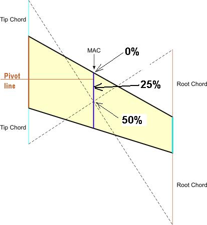

Don't know why the previous posting was deleted, perhaps the person who deleted it could tell me why?
Anyway, I was trying to determine if it is better to have an all flying tailplane pivot along its aerofoil centre line or pivot from a position some distance away from the centre line as per the image. I am building a 1/6th scale BAE Hawk and the fullsize pivots along the aerofoil centre line. I have also looked at a couple of other similar models and they don't pivot below either.
I know the pivot method is used on some T tail gliders, but is it best practice for a heavy jet (20lb)? I am concerned at the extra possibly unnecessary force applied to the servo trying to move the tailplane with an already built in turning moment. I am told that jets suffer from large loads on the elevator, so anything that can be done to reduce that is welcomed.
It was suggested that being at the MAC point is more important than the pivot moment, is that because it reduces the moment, or what?

As for an answer to your questions.....
What you've drawn is a bit of a puzzle. Where is the connection for the pushrod. That location might give a hint what the designer had in mind.
Quite frankly, if that stab pivots on the hole you show, then the designer has caused himself a number of problems. Are you building an existing model design? a kit? or designing it yourself?
Very often, the symmetrical airfoils used most often in model pivoting surfaces lead the designers to place the pivot point as near to the center of pressure as possible. That way, the lift created by the airfoil does not create a moment. And the forces required to drive the surface do not have to work harder to hold the surfaces, only have to work to change the orientation, and encounter almost no induced resistance thanks to the pivot location.
I'm not sure what you're saying with, " being at the MAC point is more important than the pivot moment". The mean aerodynamic chord point really doesn't have much to do with the problem. So I'm guessing there is a problem with terminology.

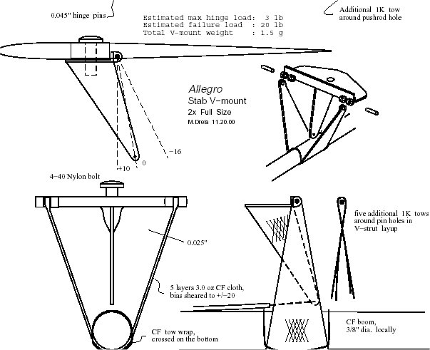

This one uses a Dr. Mark Drela design, which when properly fabricated is quite good. In this instance, the pivot point was well behind the 25% mac. and the airplane had a serious stop-to-stop oscillation on the horizontal, leading to a total crash.
The drawing shows the proper way to have done this.

Good idea to put it on the centerline.
To help a bit with the terminology, you actually wish to place the pivot at a location that is at 25% of the MAC. Designers figure out where the MAC lines up relative to the centerline of the surface and then measure back 25% of the MAC's chord. That would be 25% back from the LE of the chord of where the MAC would be if it were projected to be at the center of the span.
An old concept was called the Center of Pressure for an airfoil. This was where the airfoil could be "suspended" such that all the forces in front and behind that point were balanced. In other words it didn't try to pivot at all. This concept fell out of favour because at the zero lift angle for any of the airfoils the Cp could be shown to be infinitly to the rear of the airfoil. And physicists don't like dealing with infinite values at all.
The old Cp concept was replaced with a standard using the aerodynamic center that is located at the 25% chord point and then the airfoil is given a pitching moment value or torque value that describes now much it wants to try to diverge when pivoted at that point for various angles of attack.
Now here is the reason you want to pivot it at this point.... on almost all sort of normal symetrical airfoils the pitching moment is very close to 0 over a wide range of angles of attack. That Pm = 0 means you will see the minimum load on the servo and that's a good thing.
I modified your pic. You don't want to go aft of 25%mac, or you'll have an unstable control surface. You can go slightly forward though, and as a positive effect, the surface will become slightly stable. On the other hand, you'll be starting to make the servo work a bit harder. Also, to your original question, the F-100 Super Sabre has a physical pivot point above the flying surface itself... It then had an actuator that would move the surface fwd/aft (following a slight circular arc around the pivot point.) [8D]

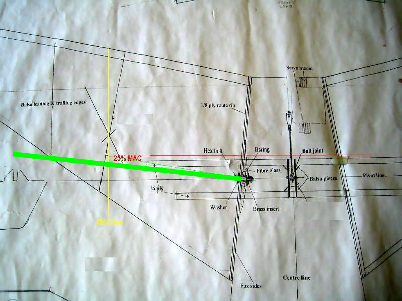

Just working out the MAC, and have attached a photo of the plan. Should the pivot line be the red line or the green line?
(Excuse the line drawn, not exactly straight. The mac line is also out of alignment to the airflow I assume)
Just the way you show it.
Both halves are rigidly connected to the horn.
The pivot looks OK, but I'd align it across the airplane, not with the slight angle you show.

As shown on the plan the pivot is actually ahead of your layed out 25% mac so all would be well with the original design in that regard. It was your original sketch that got the wolf pack all riled up. The picture of the plan (complete with glue blobs
) shows that the designer wasn't on drugs and all is well. The sweepback working to move the MAC to the rear enough that the pivot is now comfortably in front of safe point.
The hinge point above the surface is still a pretty funky way to do it but it would definetly work. It's just that the surface would sort of rock back and forth a little like an upside down cradle instead of just pivoting. No ills would come of that other than a slight extra servo load. As long as you're using something strong both in output and gear toughness it would be fine with no redesign. In fact since this is for a ducted fan or turbojet I'm guessing it was done like this to keep the linking rods below the outlet pipe or duct.

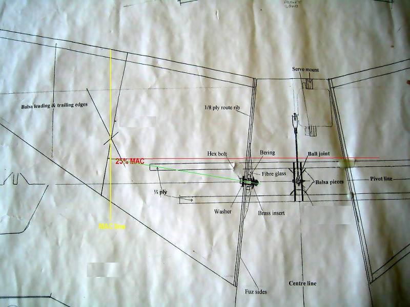

I had to rummage around to find the plans as the tailplane had already been built months ago, just have never been happy with the way it fitted.
Yes it is for a turbine, so lots of heat just below the servo. There will be plenty of thermal insulation around that section.
I am slightly concerned, as a few of these kits have lost their tailplanes in flight, no one really knows why either. Another simply nose dived in to the tarmac! Not wishing that to happen to mine, I was suspicious about the connection and the whole teatering tailplane idea.
So, would it be better to have the tailplane hinge point/pivot along the red line, as opposed to the design shown on the sketch? It would certainly make a much stronger hinge point as the thick ply cross bearers could be used as opposed to the thin 1/8th inch ply plates supplied.

I've drawn the pivot line on the plans. It is designed into that stab pivoting hardware to be perpendicular to the joint the stab makes to the fuselage.
You can think of it as if it were a hinge line. If the stab was actually a stab/elevator with a hinge line, it would be along the heavy green line I've added to the plans. And as shown, it passes at the .24C MAC point.
I did a quick proportion check of the plans and the point on the MAC the pivot line runs through shows that point to be 30/125 or 24%.
The main problem with the design is that the pivot axis is actually not in line with the actual rotation of the stabs that are being held and rotated in a different plane.
You are correct to dislike the design. It shows little understanding of the geometry of the tail. And is quite a lot of work to do, that could be done more easily in a number of ways.

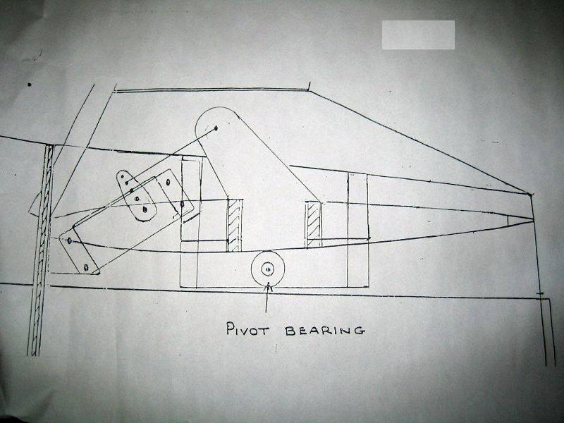

The hardware used to connect it is 1/8th ply root doubler, and a 5mm bolt running through a bearing. One side is shown on the original plan, obviously there are two one each side.
I have attached the side view of what it all looks like and you can see it sits a few fractions of an inch above the jet tube and all that heat!
It wouldn't be hard to make the whole lot pivot/hinge along the centreline of the aerofoil using the joining bearers as hinge/pivot mounting points.
