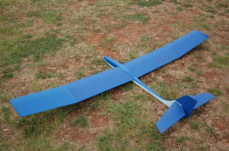

A wing with the identical airfoils was covered with Monokote so I could compare surface textures. By building what was as close to identical wings that differed only in the texture of the covering, I had at least a fighting chance of having a sensible test setup. Unfortunately, testing out in the world blows that fighting chance. I knew that, but it was still fun to pretend that I'd be able to tell a difference if it was significant enough. Yeah, right.......
