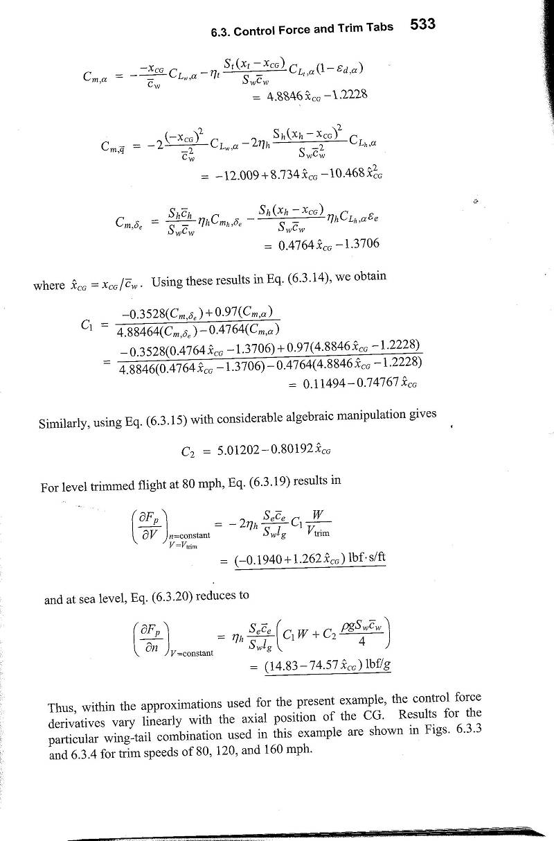

Hi, I would like to know of some powerful free grahping packages. I want to plot equalities and formulas such as the ones in this attachment below- hard ones, ones that aren't in the f(x)=y form. Please let me know of any good grahping pacakges you know where I can plot such equations and formulas.

Which flight controls book is that? That page looks familiar.
You could prepare plots in Microsoft Excel. Thats what I would do. Since only a few of those symbols are actually going to vary, it would be fairly straightforward to set up a spreadsheet for that.

This is Mechanics of Flight by Warren F. Phillips. Great book I tell ya! Also, do u know of any tutorials for excel because I am no good with it.

Those equations are really only a function of one variable, the CG location, the other symbols represent empirical values that are characteristics of the airplane and don't readily change for a given airplane, such as the wing and horizontal tail lift coefficients and the volumetric coefficients.
