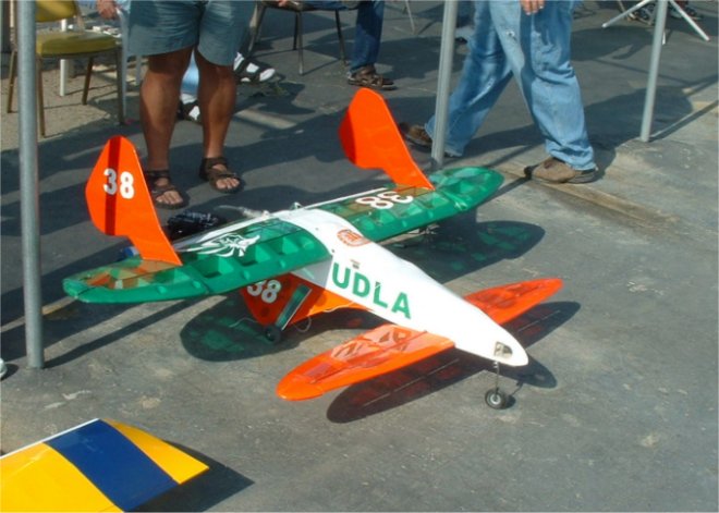

Angueto, at the SAE Aero Design West 2003 this weekend in California, this one from the Universidad De Las Americas would have earned the "Best Try Award" had we had one.
The guys spent 5 days working out the problems beginning with the lack of directional stability.. first attempts were without the vertical fins added to the wing.. Then the aft wing lifting first and forcing the nose into the ground on takeoff attempts.
Sunday it made a good take off and got quite high, but I think something in the control system failed, and it pitched down into the runway.
A very good effort regardless!
