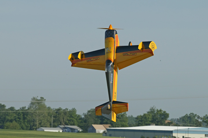

Here is an example of dual SFG on an airplane from a gentleman from Mexico at the last XFC contest. I forget his name right now. His were removable. He set up this configuration to work at the altitudes of Mexico City and at the altitude of Indiana it would do nice knife edge square loops. It reminded me of one of the little foamy indoor models.
The change in chord forward at the tip was an attempt to adjust the aero center at high angles of attack. The airplane flew pretty nicely as it was very light and over powered (again to cope with Mexico City).

I put big tip plates on a pattern model in the early 1970's. The results were zero because the airplane crashed on the first flight due to radio failure. Oh well ........
Remember when using tip plates, even those I had the photo of, that the lift isn't going to be a great amount. You can calculate the lift based on the total areas - just assume it's a small wing of the same area as the two plates added together. Look at the typical 30% scale aerobat doing a low knife edge pass. It will have an angle of sideslip of around 40 degrees. That flow angle over the fuselage side is giving the lift. The fuselage isn't nearly as efficient as a winglet planform but it can give you a guess as to what to expect from the winglets.
The indoor flat foamy airplanes usually have very deep fuselages and large (very large) winglets and in the case of biplanes upper and lower wing supports. They fly almost as well on the side as upright and are a delight to watch in action.
Our large models of the CAP, etc., simply haven't gotten the big sizes of winglets to be super effective. You might try the two winglets per panel approach and vary the size of each but think about going big. The airloads will be fairly high so make the mounting setup fairly strong. It might look strange at first but if the results pay off then it would look great!

It all depends on what you expect the tip plate - winglet - to do. If it is to stop outboard flow at higher angles of attack almost any size will be better than non at all. I think that in pattern work they aren't used because the typical FAI type of pattern ship doesn't do any high alpha work. A plain wing works fine for their maneuvers.
If you are stooging around trying to win the XFC then they will help give an edge with almost any size you put on - the bigger the better like the dual SFG of the Mexican entry ( until the judges start thinking they look funny and get prejudiced against the airplane). After all in a contest like the XFC the airplane spends a lot of time in extreme flight/airflow-conditions. Last year I saw a roll after takeoff as soon as the wing tip would clear the ground. That might have been the last level flight during the whole flight!
If you expect a decrease in sideslip angle in knife edge flight then the big ones that Dick had in the first photo are the way to go. If the full wing will pull 10g or more then the big SFG have enough area and can get enough sideslip angle to fly level flight nicely. But the airplane won't suddenly fly level in knife edge flight if they are small like the other photos.
A nicely designed SFC/tip-plate does look good.
