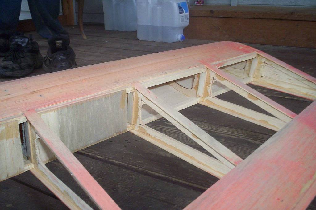

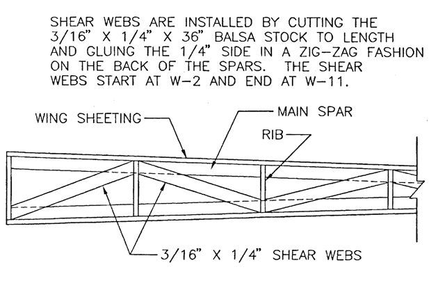

I recently built a Juno Tsunami which utilized a style of shear web I'd not seen before. I was quite impressed with the strength and rigidity this approach provided. I think it addresses both spanwise and vertical support very well, plus very little weight gain and simple to implement. I'll substitute this approach on any built up wing I build from now on.

Most of the load IS in the 45 degree direction when it comes to the actual primary function of webbing. However there's a second load direction that doesn't seem to receive the same attention. This is the tendency for the upper spar to want to buckle inwards when put under a lot of compression. For this aspect vertical grain is by far a better option.
Even better is where the webbing is located between the two spar caps and has a good fit as opposed to being glued to the front or back edges of the spar caps. And the thinner the wing the more important this aspect becomes. On a big aerobatic ship with a thick section you can easily get away with glueing to the faces. But on a thin sailplane wing the shallow spar cap spacing multiplies the effect of the same amount of G load and glue or balsa will easily fail if you're relying on just the joint to hold. Hence why sailplanes all go with vertical webbing located between the spars.
Joined: May 2008
Posts: 759
From: Foxfire Village,
NC
Diagonal web "truss" bracing that I mentioned earlier supports that 45 degree stress as well as the vertical and span wise. The size and density of the brace material can be matched to the level of support required, and glue is only required at the end points. I've used 1/16" sheet webbing many times before... never again. Faster, stronger, lighter. Works for me. The Tsunami wing I mentioned earlier is a high aspect very thin wing (for a sport pattern model) that I fly very fast. No problemo.....

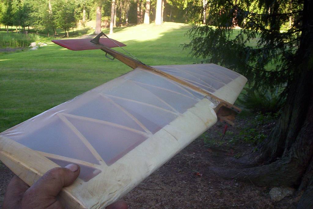

Hey Combatpigg,
Looks like a scratch combat wing. Nice work. Reminds me of a Granderson design (I think it was) that I campaigned for a couple of years. High AR with a chubby front 1/3 of the chord. Turned pretty good. Didn't have much straightline speed but that didn't matter, did it.
DaRock, I'll go with careful wood selection, too. I've also got engineering books, with all the vectorial stress analysis tables...but their value is dwarfed by looking over just ONE proven model aircraft blueprint for whatever your interested in. Neither book of mine has a chapter devoted to balsa though.
The previous photo is of the SuDoKoi designed by Tom Stryker for Morris Hobbies, a .45 to .60 sized 3D profile. Awesome plane, a pioneer of 3D flight for the masses.
The plane pictured here is closer to the "Granderdog" you speak of. It was designed by Norm McFadden and campaigned for several years by Norm, Bob Carver and myself.
10 ozs without engine, AMA fast Combat with a 2HP .36.
BTW, these planes did have horizontal grain webbing, but it's main purpose was to give the foam LE gluing surface. These planes exploded if anything didn't go as planned, so there wasn't much point in any heroic efforts as far as shear webbing goes. The average combat match lasts about 20 seconds. I built them in batches of 6 to make it through a 2 day contest, because win or lose your plane could be toast.
