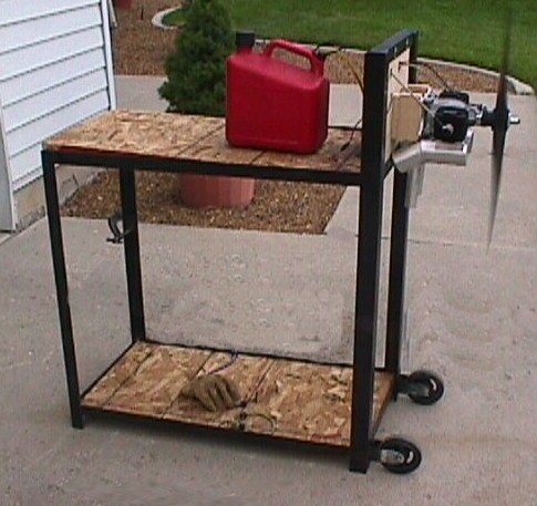

is this a serious post - "a Fuji in a Telemaster?"
me thinks it is in jest.
I once did a review with one of these boatanchors
at 2800rpm -my heavy all steel test stand would walk across the concrete -driven by the vibration at that speed.
