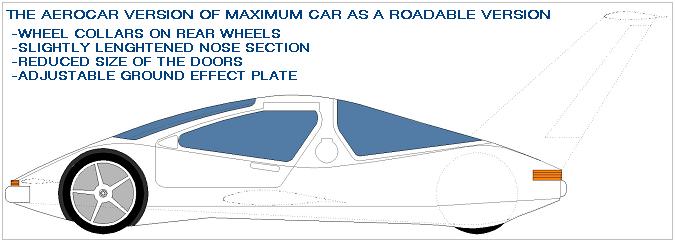

I tried to figure out how to make a real small drag into a 4 seater car, thus going 55 mph at 0,5 gallons / 100 km ( MPH 124 ).
I had roughly drag coefficient 0.17 here. This mean very low and clean body...not very practical for inner city driving.
Dimples would certainly lower the drag.
topspeed,
It's possible that dimples would help reduce drag for that shape, but it depends on several things. If the flow tends to separate early, say around the top edge of the backlight, then forcing the flow to transition to turbulence before that point could delay the separation, thus reducing drag. However, if the flow is already turbulent by that point, then adding dimples probably wouldn't have any effect. It's also worth noting that there's nothing special about dimples; other kinds of surface features can be used to generate turbulence. For example, a fairly small ridge at the top of the windshield, which might exist anyway, could be an effective turbulator.
If the boundary layer naturally stays laminar and attached all the way back to the sharp rear edge (unlikely, I would guess), then no kind of turbulator would help. There's no way that the boundary layer would stay attached past that point, turbulent or not, so inducing turbulence in that case wouldn't reduce drag at all.

Exactly as banktoturn says. There's nothing at all magical about dimples. They are just ONE form of turbulator that happesn to work on golf balls. Raised pimples would work just as well but the clubs would beat them inward so dimples are used to avoid being damaged by the impact with the clubs.
In airplanes a wide number of variations on turbulators or invigorators are used. They all work just fine.
Topspeed, instead of the shape you show what you should be doing is running the upper surface shape through something like Xfoil and design it to avoid any sudden pressure transitions that would lead to the need for turbulators. Some fudging on the car would be needed due to the extremely small aspect ratio. Also it's been shown in a number of other efficiency cars that cowling in the wheel wells is highly benificial to better mileage. Or if that isn't practical as on the front then smooth wheel hubs and a curled in rear edge to the wheel well to aid the trapped air to get back out onto the outer side skin could be benificial. Also by far the more aerodynamic design is the long tail that extends well back and tapers off to nothing. This was proven very ably by the old Porsche long tail LeMans racers. They swept the field and within a year or two an overall length or maximum overhang length rule was introduced. But since those sort of tails are not practical the Kamm cut off tail is the best compromise. And best of all it helps pull up air from below the car and thus aids traction at higher speeds.
Your wheel wells will also need blisters above them. As shown you do not have a realistic clearance for suspension travel.
Otherwise it's a highly interesting doodle though. Nicely done.

Right I was able to reduce the drad further when I tried to see how a flying car version of that low D car could look like.
The suspension could be like in Gumpert Apollo. It also seems to have almost no room to work for the suspension albeit it has 700 hp engine on it.
I am afraid that this car would produce a significant amount of lift. Lift equals drag and worse, it make it very unsafe at speed.
To design a car, you need to look at as a three dimensional object. Also, I don't know where you are getting your drag "number" but I don't believe it.
