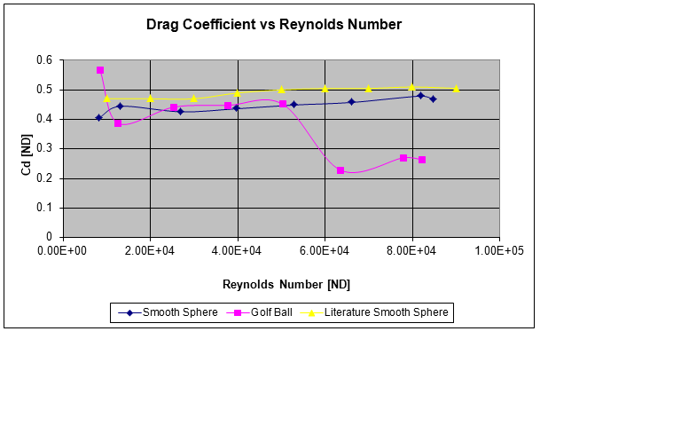

Based on the wind tunnel tests I have done using golf balls, the reduction in drag occurs only at higher reynold's numbers. There is a lot current research going on to include such flow control techniques in the latest aircraft but the problem is there is not enough data on how they will perform in actual flight. dimples on a wing will surely reduce drag but it would have increased icing effect which could lead to a catastrophic crash.
For one, dimples don't cause a turbulent flow they induce a turbulent boundary layer that reduces boundary layer seperation for high reynold's number ( higher velocities) . The flow is still smooth . I have some velocity and turbulence intensity graphs to back this up if you want.

A turbulent boundary layer IS turbulent flow. When dimples are used to reduce drag, they do so by causing turbulent flow in the boundary layer, which in turn delays flow separation. The flow within a turbulent boundary layer is not 'smooth'.

The results of your tests are the opposite of what one would expect. The CD of a sphere tends to go down as the Reynold's number increases, because the boundary layer becomes turbulent earlier at higher Reynolds numbers. This would reduce the impact of dimples at higher Reynolds' numbers, since the dimples have no effect once the boundary layer is turbulent.

Actually the results obtained are what are expected. The CD of a sphere is much higher for higher Reynold's numbers. the flow becomes turbulent due to flow seperation which increases CD. The flow around a dimpled sphere is still smooth inspite of the turbulent boundary layer. At high reynold's numbers the flow is around dimpled ball is smoother than for a similar sphere.

I recommend that you take a minute to do a Google search for CD values of a sphere. You will see that the CD clearly decreases with increasing Reynolds numbers, unless some mechanism is used to force transition. This result is well understood to be a result of the turbulent boundary layer keeping the flow attached.
The word 'smooth' is imprecise in this context. A turbulent boundary layer is not 'smooth', although the flow may appear to be smooth, since you can't see the turbulent fluctuations that occur at very small length scales.
It would be interesting to see the graphs you mention.

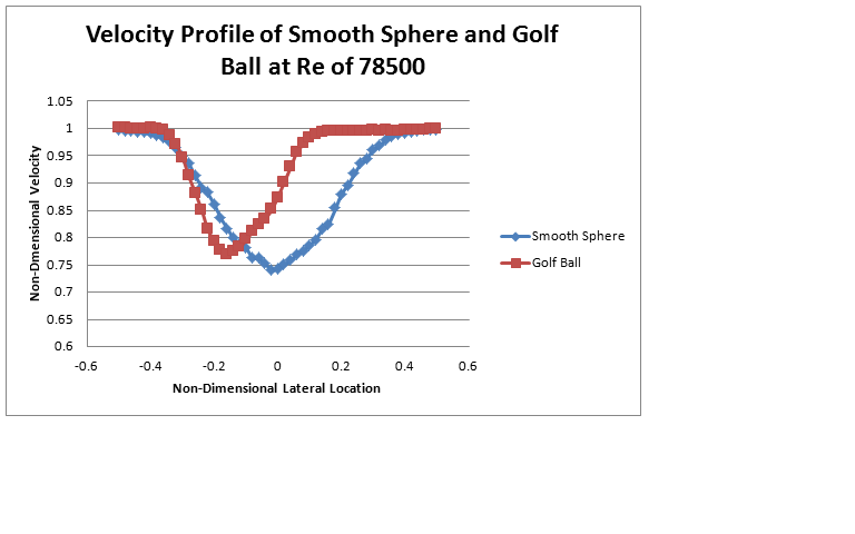

Sorry , I notice I made a mistake Imust have said the drag force is higher for higher reynold's number and not the Cd . The drag force on sphere is higher than drag force on golf ball for high reynolds number . Iam guessing the Cd goes down as it is inversely proportional to the velocity.
I have attached my graphs. This is similar to what others who did the same experiment obtained as well.

Sorry , I notice I made a mistake I must have said the drag force is higher for higher reynold's number and not the Cd . The drag force on sphere is higher than drag force on golf ball for high reynolds number . I am guessing the Cd goes down as it is inversely proportional to the velocity.
How are you generating this data, and where did you get your "literature" values for CD? What you say is found in the literature is not correct. Try this site:
http://www.princeton.edu/~asmits/Bicycle_web/blunt.html
It gives a nice explanation, and shows data resulting from well-accepted drag measurements for a sphere at a range of Reynolds numbers.

If you look closer at the graph you will actually see that the graph show in figure 2 of the link you just gave matches the literature graph in the plot I attached. Match up the reynold's number values. The graph doesn't include data for all reynold's numbers at the figure in the link. Also your link doesn't compare the data given for a dimpled sphere which is what is being discussed here.
And all the data was obtained using high precision instruments at the University of Illinois.
And Dimples reduce drag only for higher reynold's numbers. For low reynold's number the drag due to flow seperation is not significant.
PS:This is my last post in this thread.
