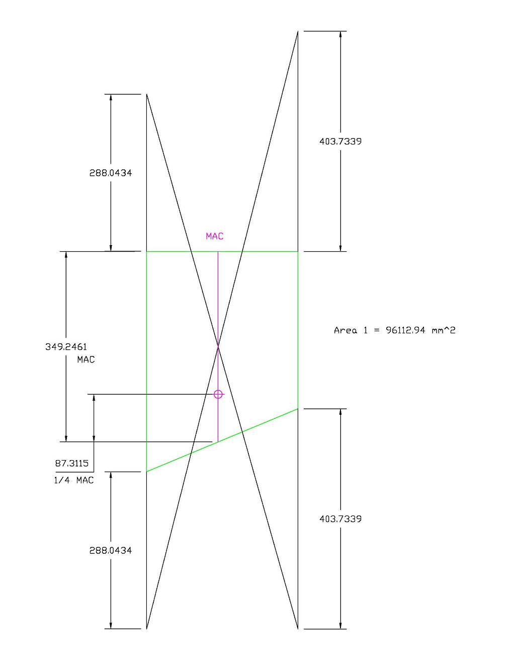

I maidened an plane for a gentleman the other day (his own design) and it was a beast. Although the elevon throws were overly sensitive, in both roll and pitch, I think the primary problem was a rearward CG as opposed to too much throw. At cruise speed, which was about 1/4 throttle with an MVVS up front swinging a 12x6 at about 18,000 rpm, the plane was sensitive but relatively controllable. and I was able to get in several circuits and trim the plane without too much difficulty. However, when slowing the plane for landing the pitch control became significantly more sensitive to the point that pulling back a click on the elevator would put the nose at about 60 degrees and likewise pushing a click would put the nose down about 60 degrees. As a result, the only way I could attempt to manage the glide slope for landing was to throttle back to try to get the nose down which then would result in a nasty tip stall to the left. About 20 attempts later, I did finally get it down without damage but I think it was more luck than skill. Before this thing goes back up, I want to make sure the CG is really correct. I had checked it on the ground and it seemed ball park to me, at least for a normal plane, but cursory research indicates that a tail-less plane may require a significantly more forward CG than a conventional design. Currently, the plane balances at the front most tan stripe on the wing tip. Is there a CG calculator out there that handles this type of planform or is there a good rule of thumb that I can apply.
Thanks, Tony

Now, for the CG location, you need to:
1) Determine the MAC of each area that form one half wing
2) Divide each MAC length into four equal sections, and mark the first one closer to the wing’s LE.
3) Use the formula in the attached schematic to calculate the length of the MAC of the full wing, which should be located in the central line.
4) Repeat #2 for that MAC; that is where the neutral point (NP) of the full wing is.
5) Mark the CG range between the 10% and 20% closer to the forward point of that MAC.
Check these old posts as a reference for determining the MAC of each area graphically:
http://www.rcuniverse.com/forum/fb.asp?m=9268143
http://www.rcuniverse.com/forum/fb.asp?m=9265664

Looking at the graphic layout so nicely done by LNEWQBAN it's apparent that the CG was at or even a hair behind the NP. Shifting it ahead by a goodly amount will likely turn the tiger into a far more agreeable play thing.

Thanks to all, especially LNEWQBAN, for some great information. Will run some calculations and give it another shot. Stay tuned.
