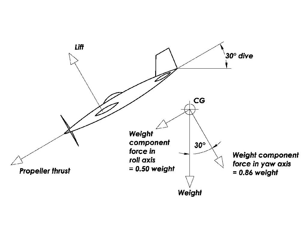

Good clarification, da Rock!
Static thrust means the prop's baldes are working at the max AOA.
Once the plane start moving forward, the AOA gets smaller until reaching a min at top forward speed.
This happens because the air hits the prop at a smaller angle when the plane is moving.
No, the plane of reference is not relevant, since force is force, whatever the direction is that it is applied towards.
Gravity is just a force, which we call weight.

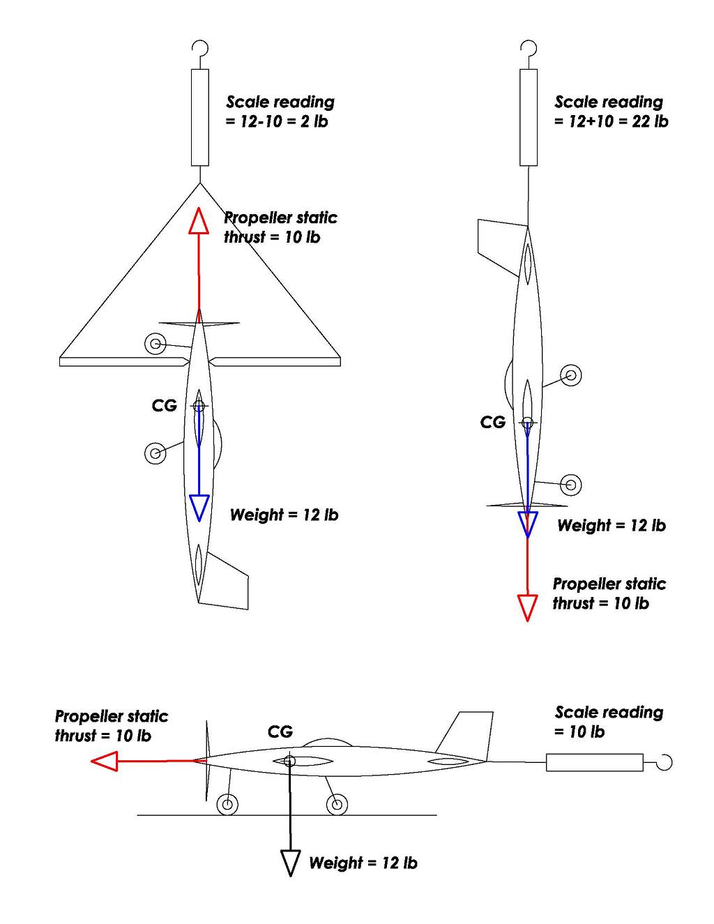

Thanks again. I grasp the nuance between static and actual thrust but that is not what I'm wondering. I've seen some rather high numbers it seems to me posted for static thrust figures and I'd certainly not impune the offerings, but do wonder about technique yielding the numbers.
To clarify... What I'm wondering is this. If a motor, prop and cradle weighed 10 lbs and was hooked to a scale in the vertical position and yielded a measurement of zero, the static thrust would be 10 lbs after factoring gravity weight of the motor, prop and cradle but what would the measurement be in the horizontal plane? Would the scale measure 10 lbs?
Old 07-29-2010 | 08:18 AM
Lnewqban's Avatar
Joined: Apr 2007
Posts: 4,057
From: South Florida
Default RE: Help me understand static thrust
Sorry, I did not understand the question correctly.
Absolutely yes.
