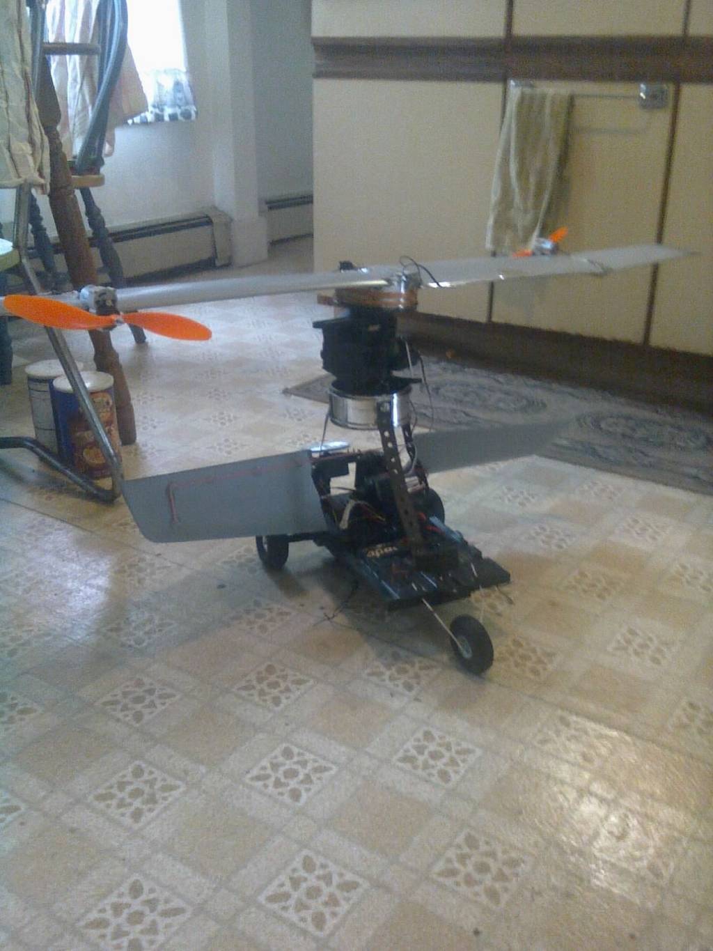

so, if I look at the R. or L. half it has a 6" clip on the wing tips - making the cverall shape of the 1/2 wing - a screwed up rectangle. I think it's what is referred to as a TRAPEZOID
According to a variety of research - my DELTA is now at 780 sq. in. and just around the 10 lb. area. Accordingly, this all important number is coming in at around "30".
If I were around 1/2 that size - say 36" WS and in the 6-7 lb area. the loading is almost the very same!
A small .40 ENYA i used to have in the late 80's made the 36" version kick out at about 45-+50mph.
This LARGER version of the same plane - as I say - is 60" WS.. I now have a ROSSI .81 DF to power this larger bird.
The DF is for "DUCTED FAN". - with a tuned pipe!
From what I've seen so far, the old ROSSI engines are like running straight TURBO.
Now then, PROPS - I have an 11/7 MASTER AIRSCREW (PUSHER) on it - I also have some smaller ones, too
What to do?
I've run the ROSSI a couple of times but I'm waiting for a solid BULLET for the nosecone. It'll thread right INTO the prop shaft.
Right now, I barely have enough threads to keep it on

Yer right CP. I guess we shouldn't trust Marwen's math at face value....
The average chord is (48+6)/2= 27. 27 x 60 = 1620 sq inches or 11.25 sq feet. So the wing loading is actually a feathery 14.2 oz/sq ft. That's just barely over thermal soaring glider wing loading territory.

Bruce: The formua I used was pretty close to what you had above. What I have here is a TRAPEZOID.
I measured my root from the imaginaty point (that isn't there) of my DELTA point to the trailing edge. That was 48". Add the 6" for the wing tip length = 52" /2= 26 (AVERAGE CHORD)
WING AREA = WING SPAN X AVERAGE CHORD
WING SPAN IS 60" - A TRAPEZOID ONLY MEASURES 1/2 OF THE WHOLE WING (WS/2=30)
26X30=780

Could you do some calculating on this.The Rotating wing has a 6ft. span re-inforced foam with 6 inches from leading edge to rear edge. meaning 3 ft. on either side of the hub.I just want to get this in the air and flying.Upgrades will follow.I have planes for a powered steerable front wheel for Taxying and short trips without rotating the wing.Electricity would be switched from wing motors to front wheel!!
I have a Question but, I have some numbers for you.The Aircrafts weight is 4 pounds with everything battery for motors,battery for reciever weight of wing and weight of body including gimble.The Rotarywing is 6ft.in span 3ft. on either side.And 6 inches front edge to tailing edge.Can you tell me at what r.p.m. it will lift off at ?
