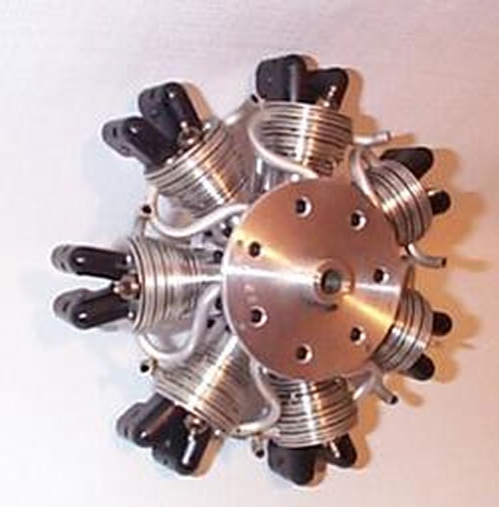

Lonnie:
Looking back I see I didn't answer you question about the intake on a radial.
If you have an engine you can look at, you'll see all the intake pipes running to the crankcase. Just inside there is a centrifugal blower, some would think it to be a super charger. While it can be, its main purpose is to keep the intake mixture agitated, so the gasoline vapor does not condense and slog the lower cylinders. The fan is called the "Diffuser." Some smaller radials don't have a diffuser, but I don't know of any that don't use the common chamber in the crankcase as an inlet manifold. None of our model radials, so far as I know, use a diffuser fan.
I've attached pictures of two different Technopower radials, two of a 7C with ignition for gasoline fuel, and tow of a 7A set up for glow fuel.
Bill.

Bill thanks again for all of the info. Those radial engines are quit different than automotive engines .I mean the same principle but they go about it in quite a different way.What are the big pros and cons of the radial
