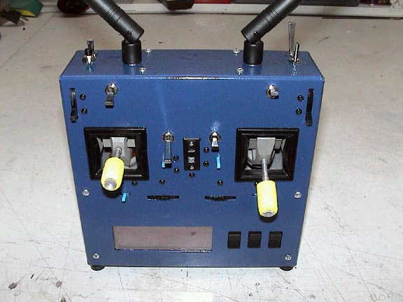

Point the antennas at each other and tell me your range. Have one antenna pointing horizontally and one vertically and tell me your range.
Range has many factors.
Transmitter Power
Transmitter Antenna Gain/Polarity (in the direction of the RX)
Path Loss (as stated here, very high at high frequencies)
Receiver Antenna Gain/Polarity (in the DIRECTION of the Transmitter )
Receiver Sensitivity
Here is Gen II (second flyable prototype transmitter)
