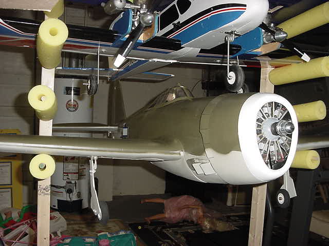

I installed the top flight dummy radial. the radial is a bit larger than the cowl. I had to use the dremel to grind the radial down quite a bit to get it to fit. Had to take the tops off a few cylinders to get it to fitt right with my OS91. Noethless, you cant see it and it looks really really nice. I even wittled a wooden chin to put in the cowl. Definitley recommend the radial and homemade chin.

TwoStroke that radial looks great in your jug! I am looking at the instructions now and it says to cut one of the cylinders off for cooling. and to cut out the engine shape in the baffle backplate. Did you do this ? Becaause looking at the picture I can't tell.

I just removed material in-between the cylinders for cooling the engine. It proved to work well as the engine cylinder was directly behind one of the openings. Remember to have twice as much open area behind the dummy engine as you do in the dummy engine for venturi action, so the air is drawn through the cowl past the power plant.

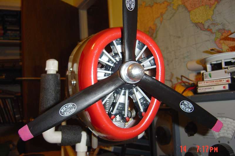

Thanks for the info on the dummy radial! I just got mine installed in front of a Magnum 91 four stroke. Now on with the air retracts and 3 1/4" dia. wheels.

Yours looks better than mine. Nice job! It will fly better than it looks, you'll like it.

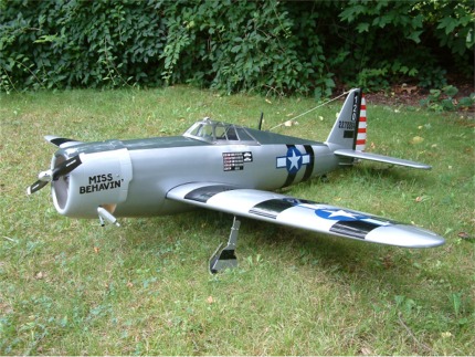

skyking424 - NICE looking airplane. I'm flying mine with a Magnum 91 also, and it's got plenty of power.

Here is a another pic. I am waiting on the brown truck to bring my air retracts and 3 1/4" dia. wheels. I want to fly her now but I keep telling myself to wait until the new gear is installed. Your's looks good! I made up my own decals so it is a little different. Thanks to Twostrokes I got the dummy radial in. I am waiting for my VQ Model P-51B to arrive
