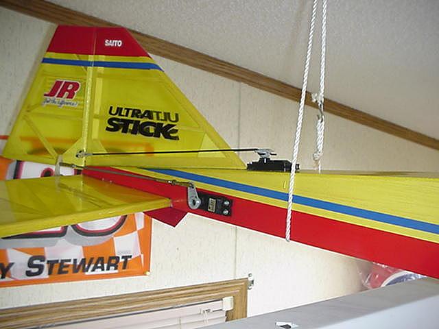

Need some help in the placement of the elevator servo, Rudder should not be a problem, was thinking of using a pull/pull system. How about the elevator? I don't know where to mount the servo or how to position in correctly? Any input?

Here is what I did with mine. After making the holes for the servos I glued ply strips inside the fuse for servo screws. I used pull-pull system on the rudder with rods and one servo for the elevator. Hope this helps you.
