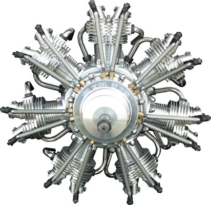

here is a pic of the ST7-35 and the ST7-70

A Radial would look fantastic in the cowl.
35cc may be a perfect size but I think 70cc would be way over powered.
As Andrew from KMP let me know that their 32cc would be fine for the plane, than this 35cc I think would be close to perfect.
Hard choice to make as to what would be best engine as no one else seems to have info on flying them so hard to gauge performance.
Look forward to see what you choose and how it goes.
Regards Greg

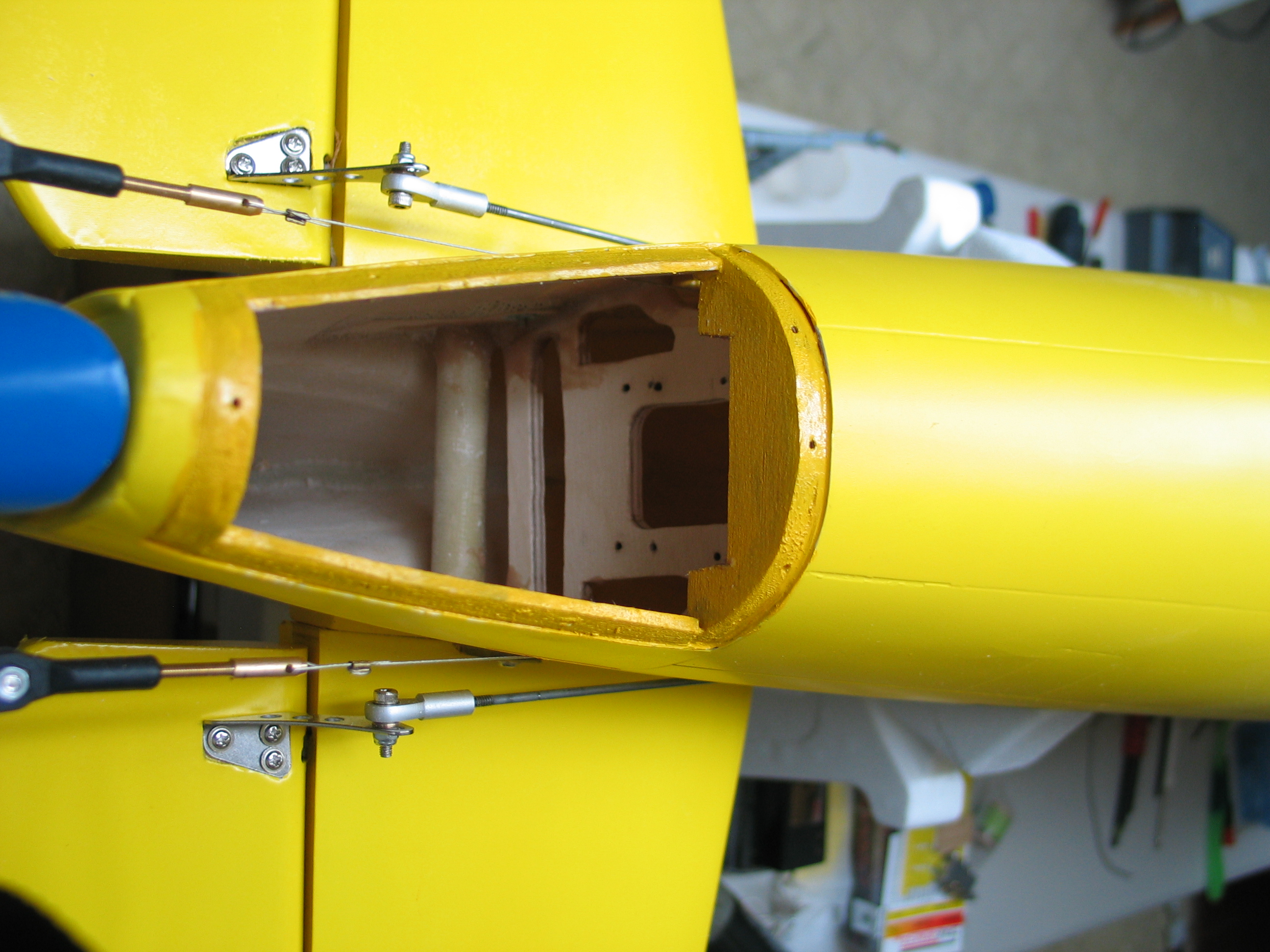

ok, here some long awaited pics of the build

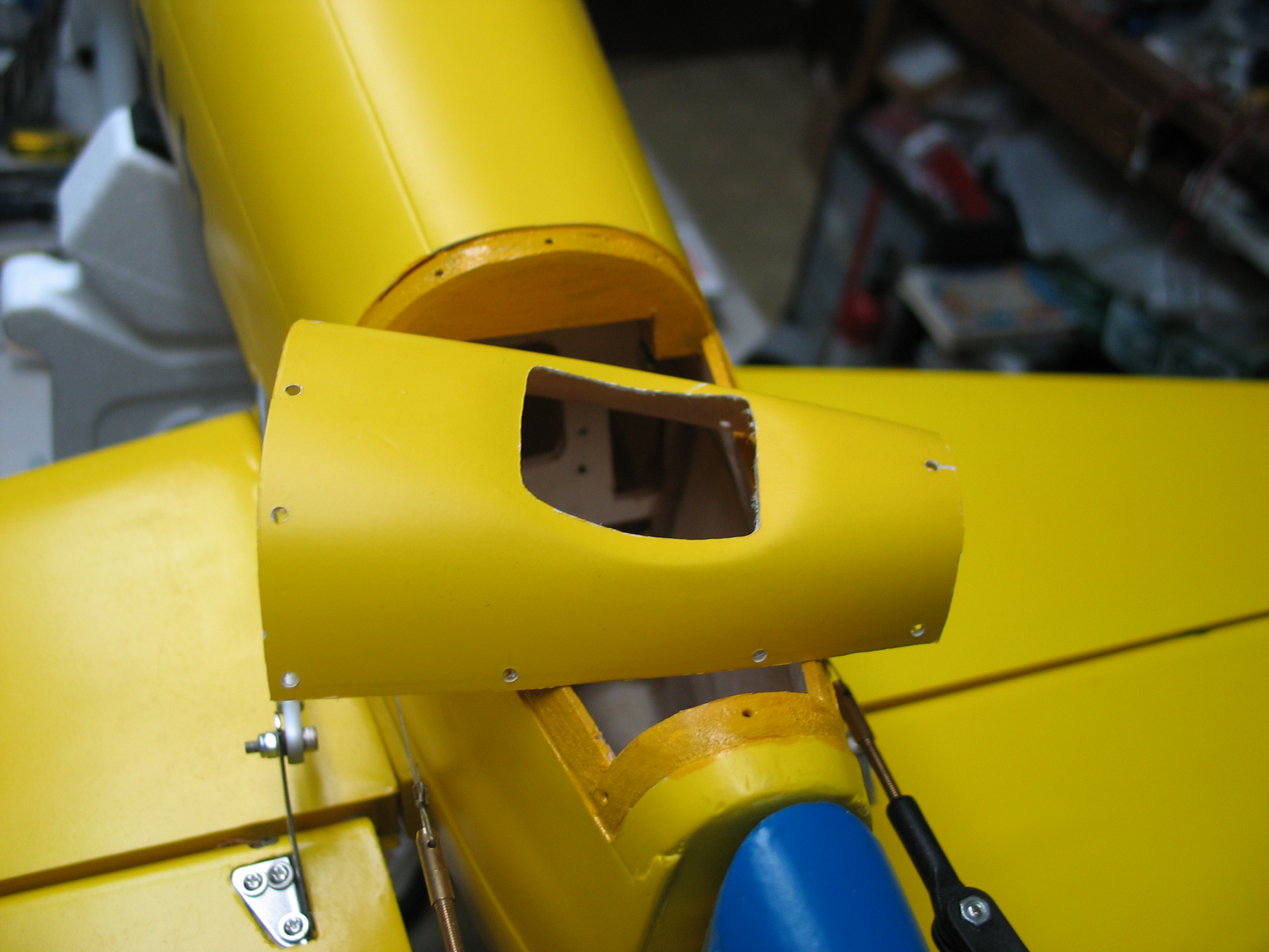

Hi Greg, it came with this colour scheme. The engine was suppose to arrive yesterday, but held up in customs so they say it should arrive today, keeping my fingers crossed. I decided on the siedel ST7-35 which is a 7 cylinder 35 cc engine which will perfectly in the cowl.
the door for the switches, I had to remove it to change the hinges to offset hinges, it was binding.
There is no tail wheel former in the back, so Andrew is asking the plant to add it, it's going to be hard for me to put it in, but I'LL get it in there.
As I get her done, I'll keep posting pics.

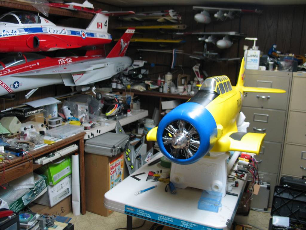

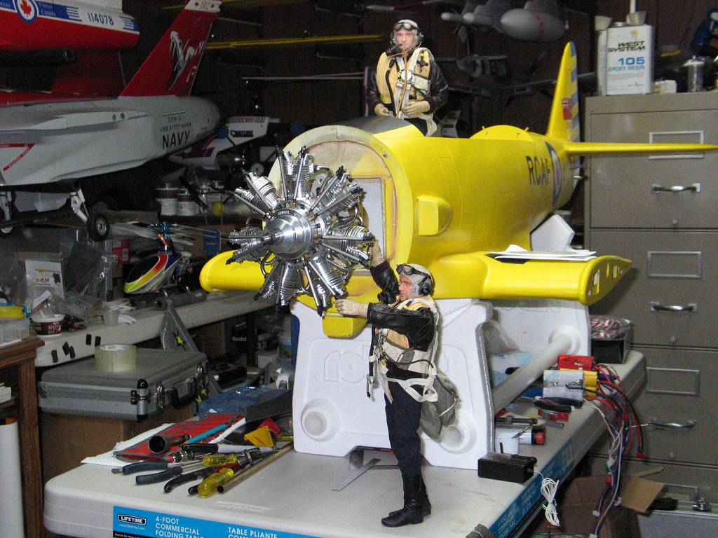

ok, here she is just installed with new engine for now to set up the correct distance.
now I am looking for a scale prop hub nut/spinner and prop, I looked hard for a variable pitch prop hub, but no go
got other goodies coming for her too next week, will post when arrive.
Paul

That motor looks like it was built for that plane.
Looks stunning.
Will you be able to put a scale exhaust outlet in the plane?
keep the info & pics coming.
What is the quality of the product like? Is the Fiberglas fuse good or what other things have you had to do to the plane?

I got two more helpers that came in today to try and get this plane finished

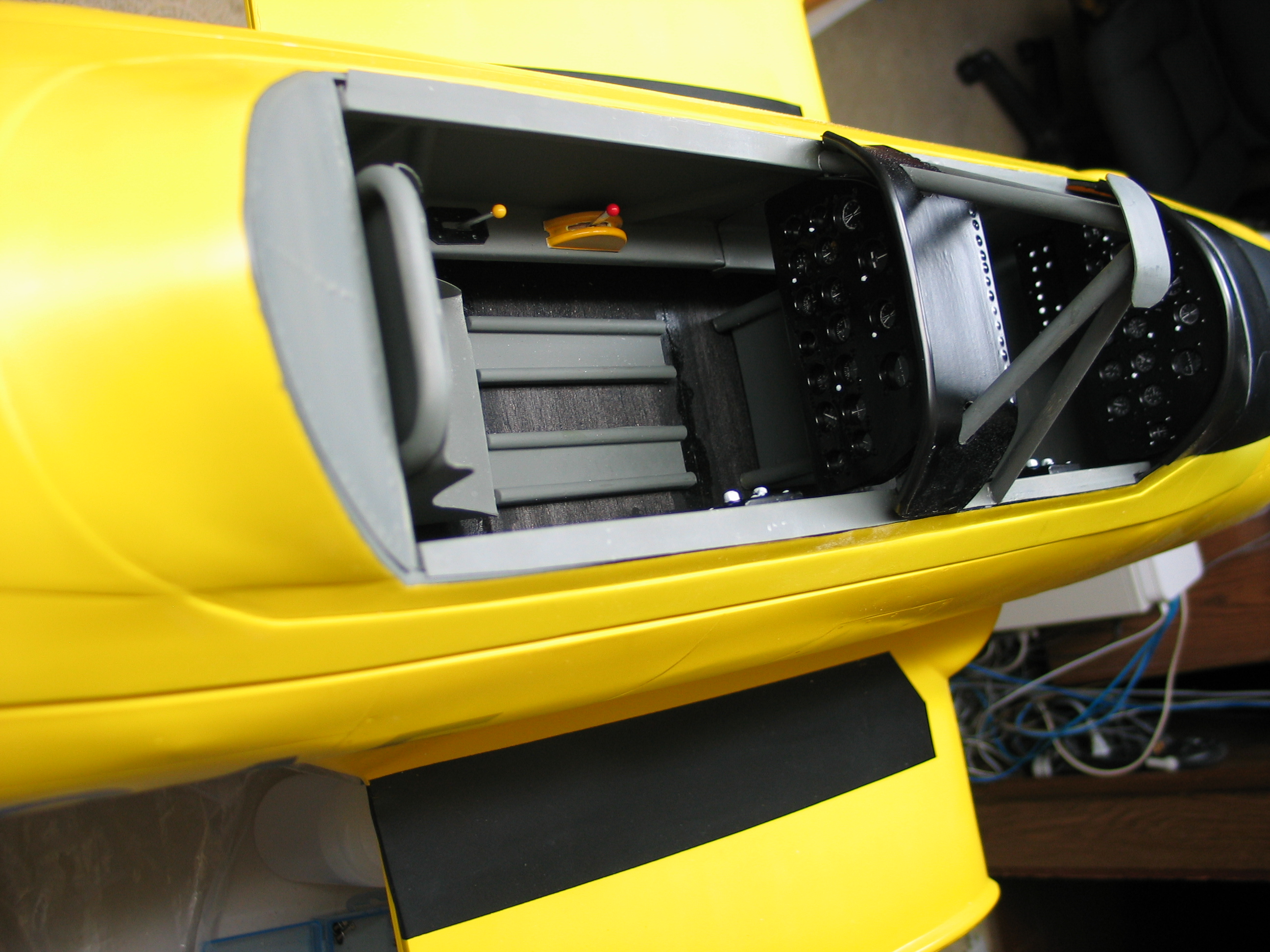

Default RE: KMP Texan
Hows the build going Paul,
Any more pics, Are you going to do a full cockpit install as well?

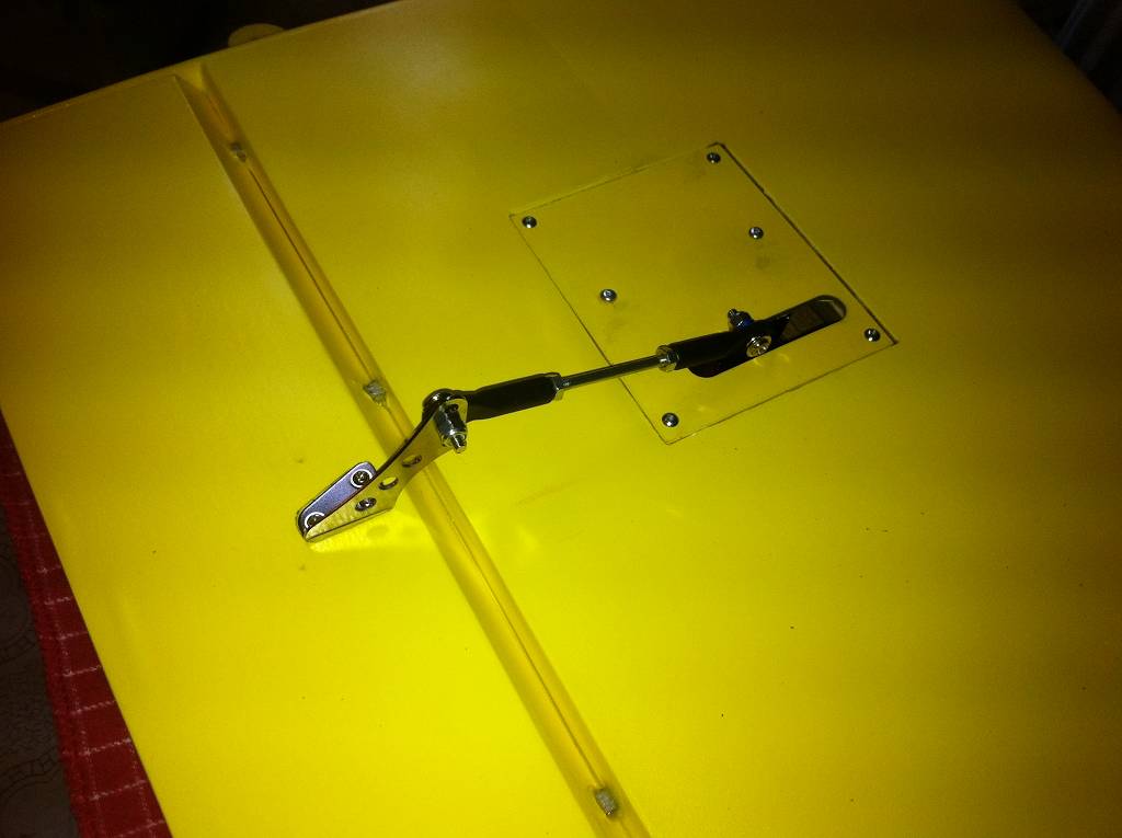

Well I continued to build and making progress every day, but been very busy at work, so sometimes too tired to do too much. but here are some pics of the progress.

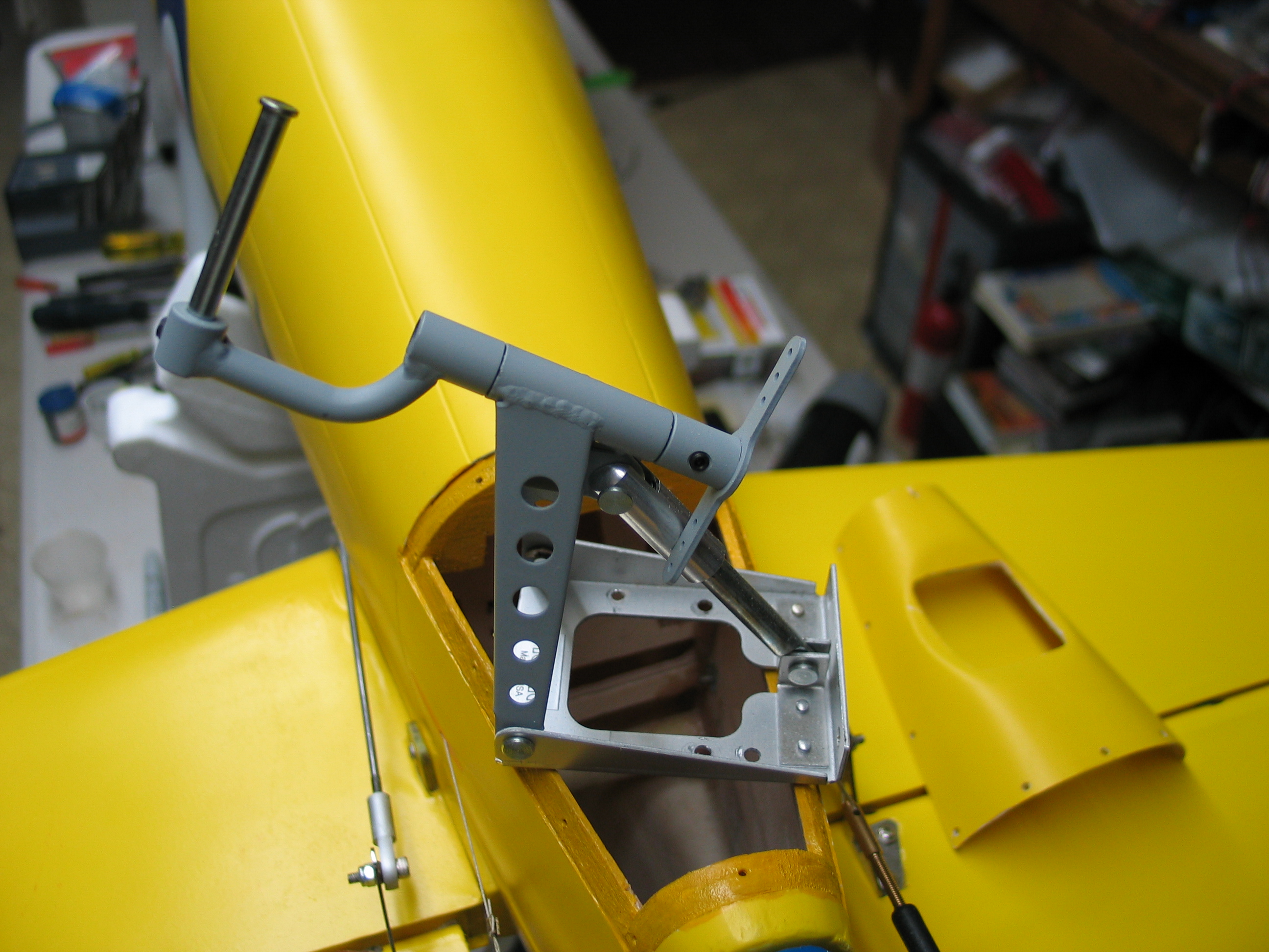

Oh and to answer some of your other question.
1) The fuse in glass work is very good, paint seems to holding ok.
2) The engine mount area seems to have that famous large hole to except that cylinder engine mount you talk about, that I did not get and won't use anyway. I will take a pic of it tomorrow and post.
3) Like a said before the idots did not put a former for the tail wheel, I guess they wanted you to put some cheap wheel on the bottom and wait till it fell off, So I cut the area under the tial wheel and made and installed a former to accept a scale looking tail wheel, Robart AT-160 Fixed, picture later (getting late here)

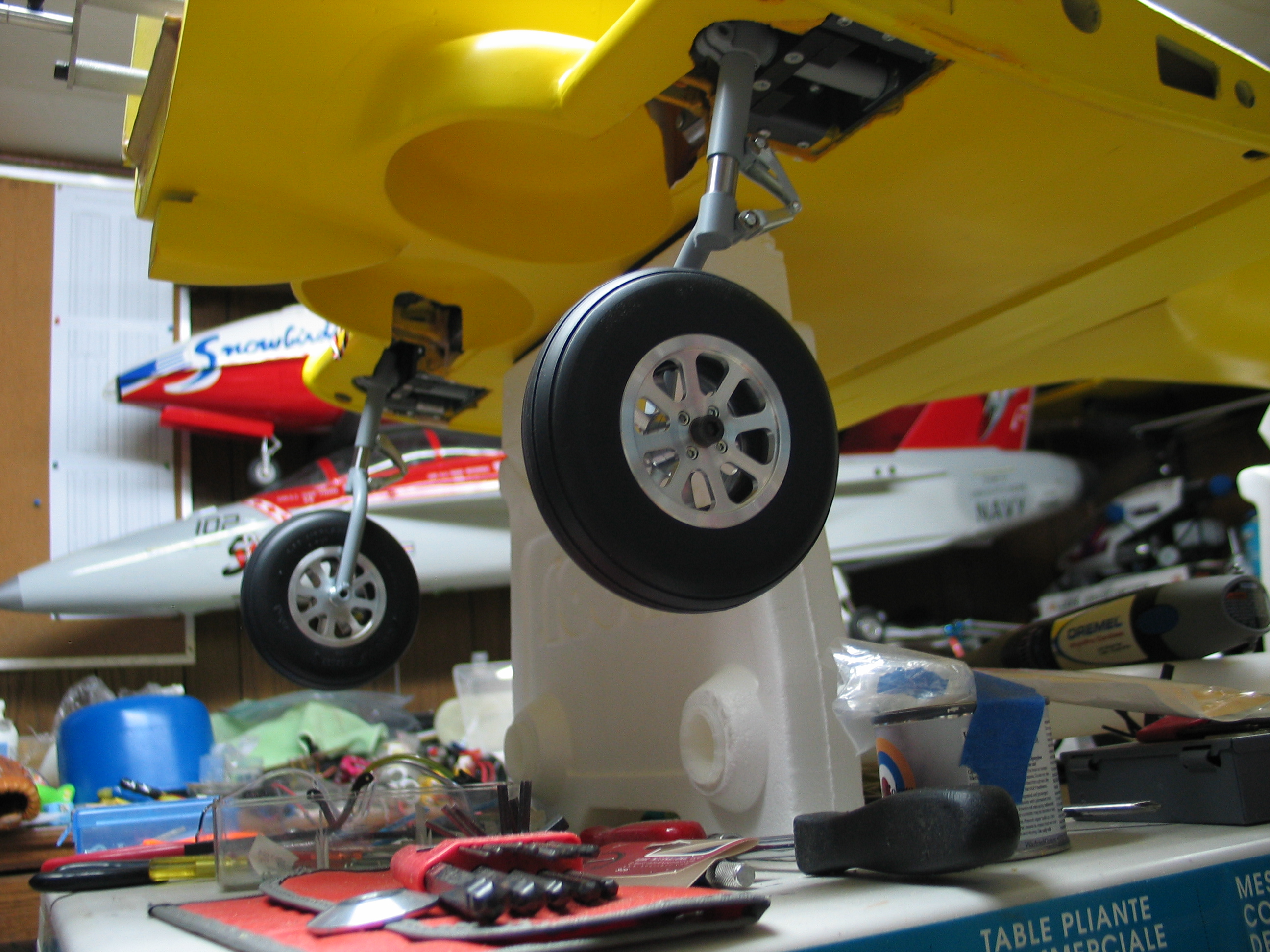

4)Fitted the Robart landing gear, had to do a alot of domore/doless to get them to fit, OUCH !!!!
5) Added cloth carbine fiber to wign area above the retract to strenghten it.
Here are some pics with more to follow.

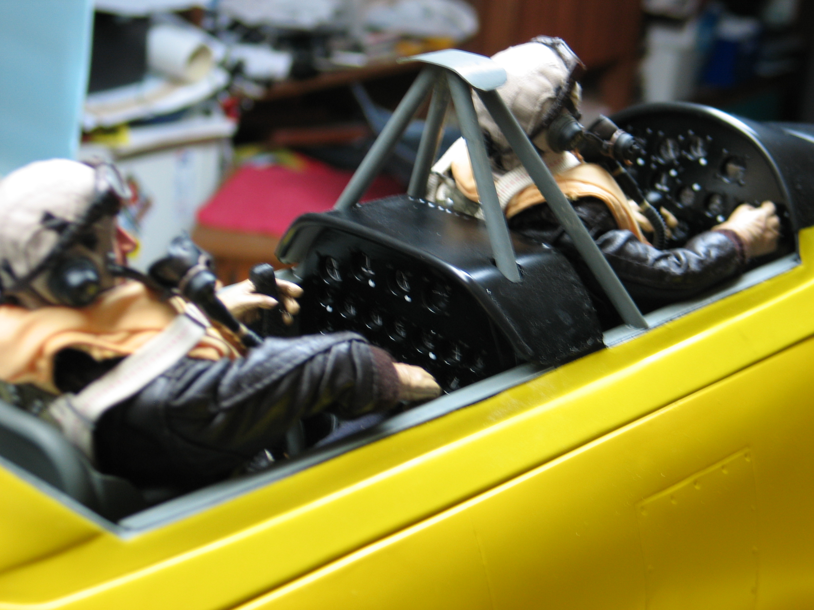

Hi Paul.

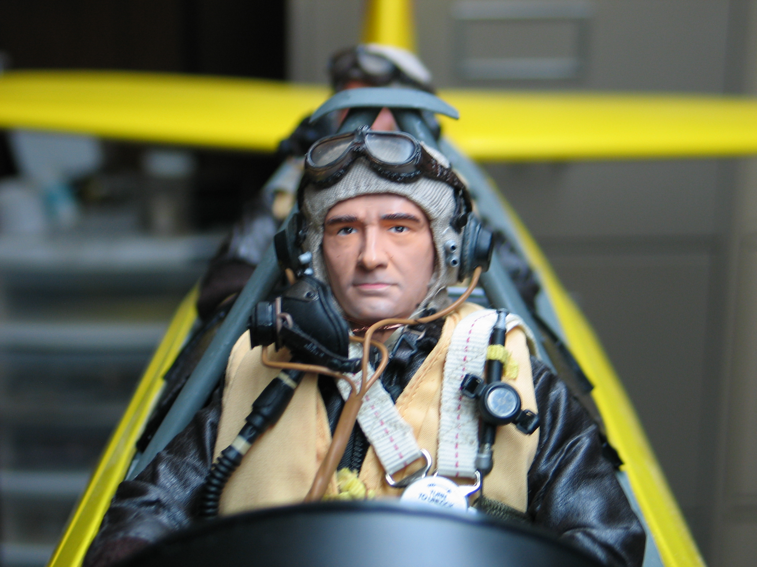

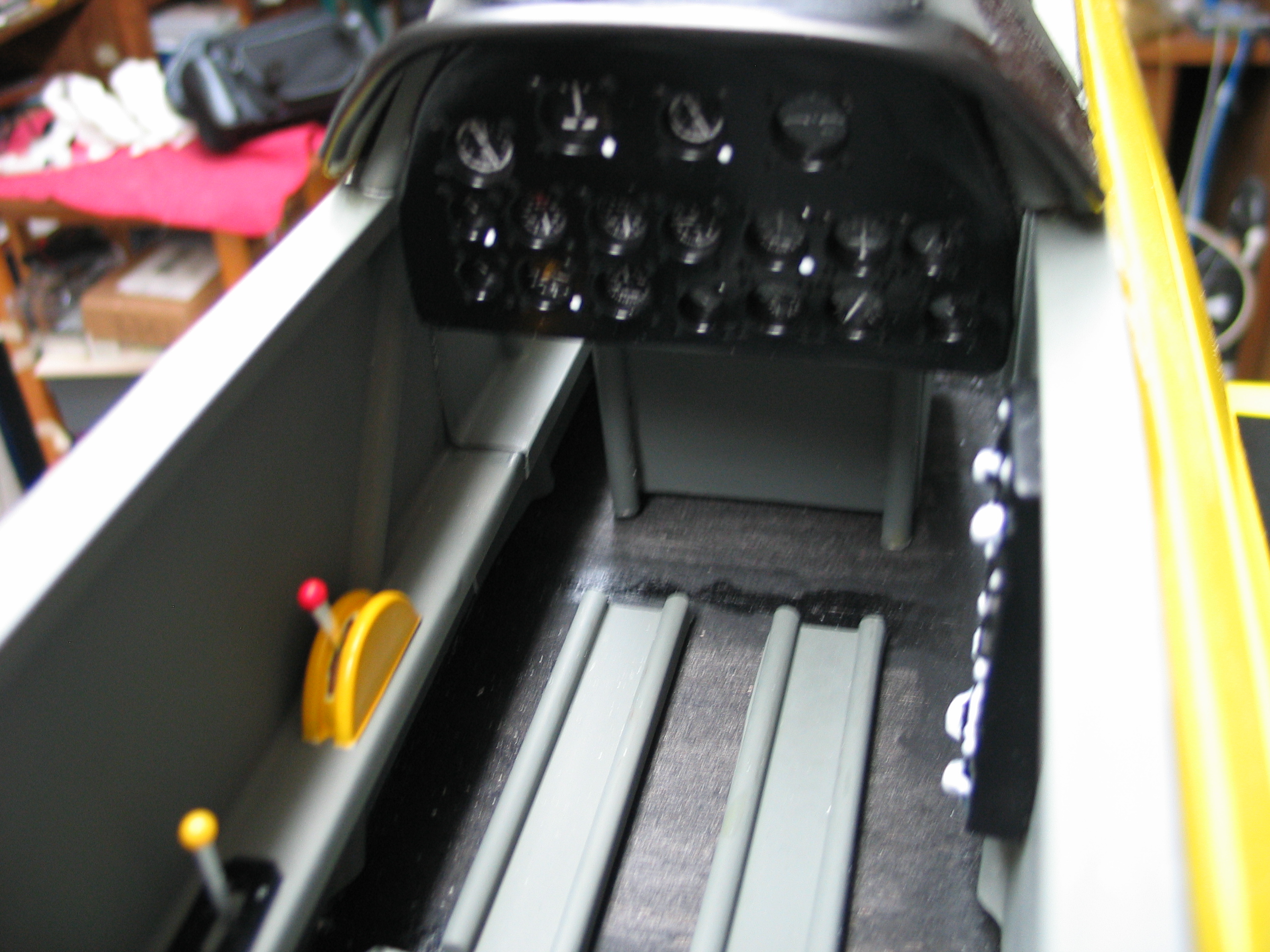

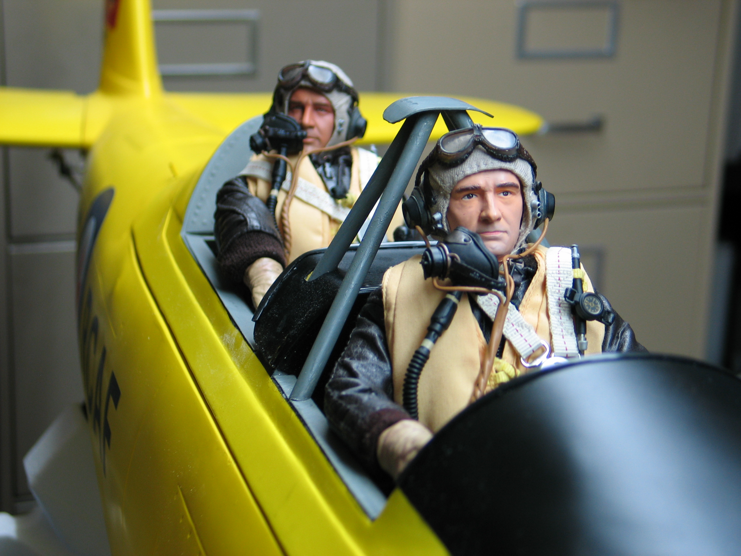

You are doing a great job on the Texan. Did you build the cockpit yourself. Looks great. I like the rollbar behind the pilot looks like the real thing.
The pilots look like they could come to life and fly it.
Was the Robart gear the set for this plane. Or a set you got from Robart? Been told you can only get the Robart retracts for this plane from KMP as Robart don't sell these particular sets to customers?
Is the paint finish Gloss or Matt? Looks like the black is a satin finish.
I like the colour scheme.
Great looking plane
Regards Greg

Goodmorning gentlemen, (well it is here LOL)
thanks for the great comments,
As for the the kit, your correct lifer.
the Paint finish is matt, giving that more scale look.
the retracts are Robart but you are correct that you can only order thru KMP as they have a contract to sell them, but at a great price, deal package.
the cockpit was a build up kit from Dynamic Balsa, It was a large bag of vaccum form parts and balsa, but it all came together.
more pics to come today, stand by.
Paul

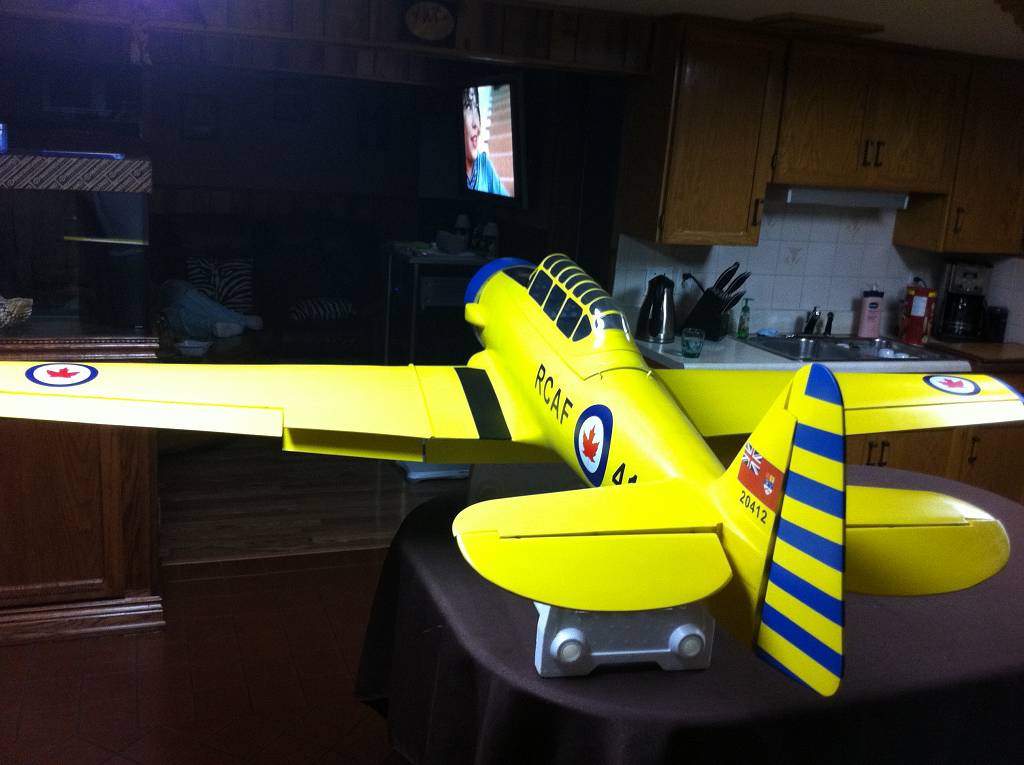

Here are some more pics
ID:	1562650   Click image for larger version
ID:	1562651   Click image for larger version
ID:	1562652   Click image for larger version
ID:	1562653   Click image for larger version
ID:	1562654   Click image for larger version
ID:	1562655   Click image for larger version
ID:	1562656   Click image for larger version

Hi Paul
That motor looks great in that above shot.
The tail wheel mod looks good, Is that a tail wheel strut functional. looks like a bit of suspension movement available.
I know that the wings bolt on with 2 bolts on each wing but what type of bolts are they and what do you think of the set up.
Regards Greg
