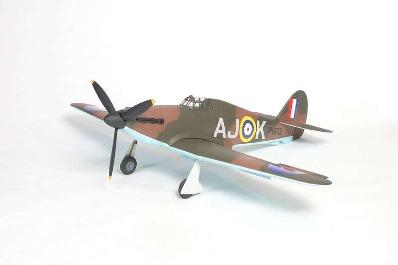

Here's a new picture of the KMP Hurricane coming in February (Hopefully Jan.) This one has a 72 inch wingspan and is designed for 1.20 FS power.
