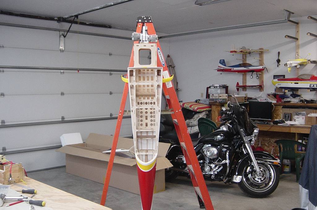

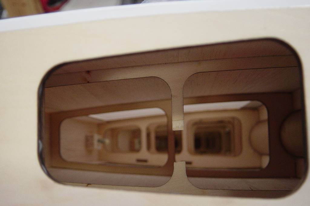

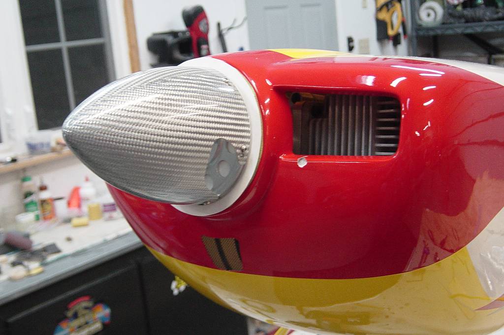

There were 2 problems with the plane upon inspection.
The cowl had a chip in it right up front where I can see it and there was a piece missing from a rib. I decided not to return anything and fix it myself.
A real close inspection with a flash light didn't find anything else wrong. This is a Quality Plane.

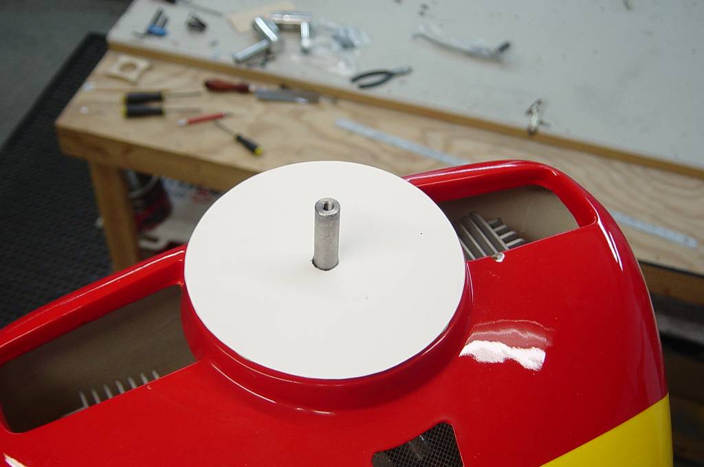

I decided to mount the engine first. I had to take it off of the Engine break in stand that I built. I had the engine for a while. It's a YD Aero 112cc. I'm also planning on putting Cans on here. I picked up a used set from my friend Ryan. I don't like to use templates to set the engine. I made a template out of poster board and stood the plane up against my 8 foot ladder and bungied it so it couldn't fall over. Set the engine on the firewall and located it to the cowl. Scribed around the mount with a #2 pencil and drilled the mounting holes.
RCu has been acting up for two weeks and wont let me upload anymore pictures for now. I'll edit them in later.

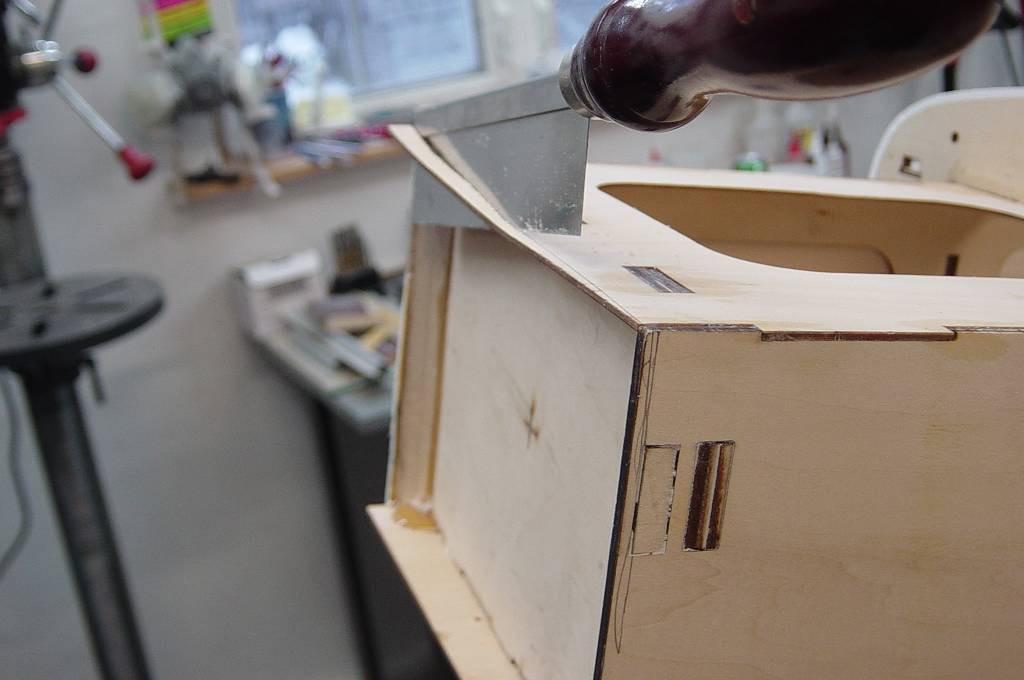

I had to make a little modification to the front of the motor box to clear the rear mounted Cylinder.
Thats as far as I got so far. I'll get back to it after Christmas.
