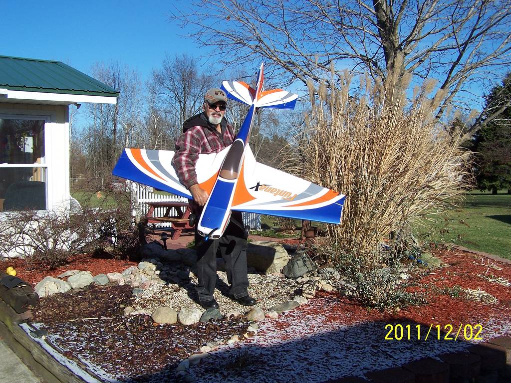

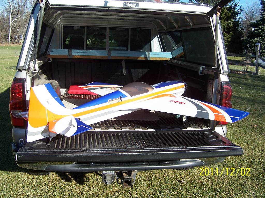

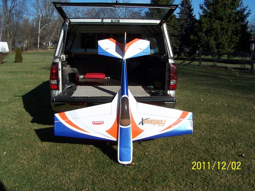

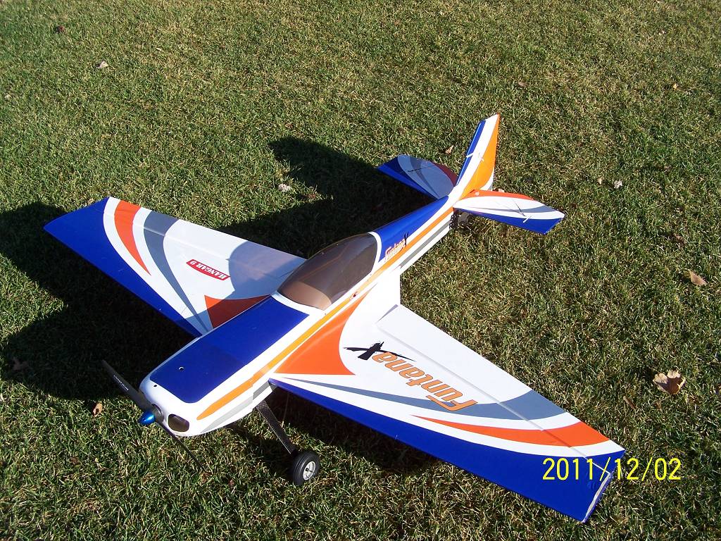

Some photos of my Funtana 100x I took today 12/2/2011. It was cold and there was a slight amount of snow on the grass this early am. Capt,n
#32
I think it is the stock landing gear that came with it. I bought the airplane used (crash victim) and done lots of repairs. I will call the Guy I bought it from and ask. They seem like nice landing gears. So in all I got a airplane cheap...had to do lots of repair...and it is a nice flying airplane, but has to be handeled carefully and landed smooth. I do like it for now....but there is far betterI am sure. Capt,n
