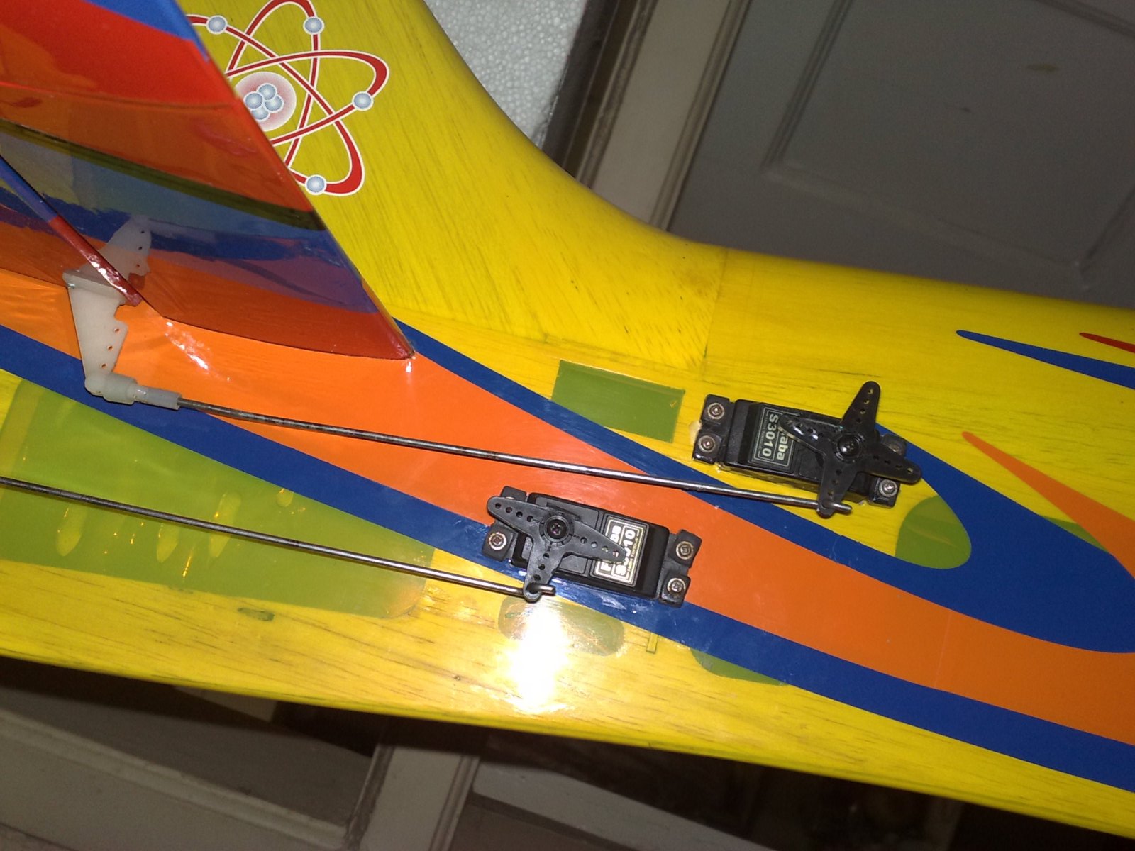

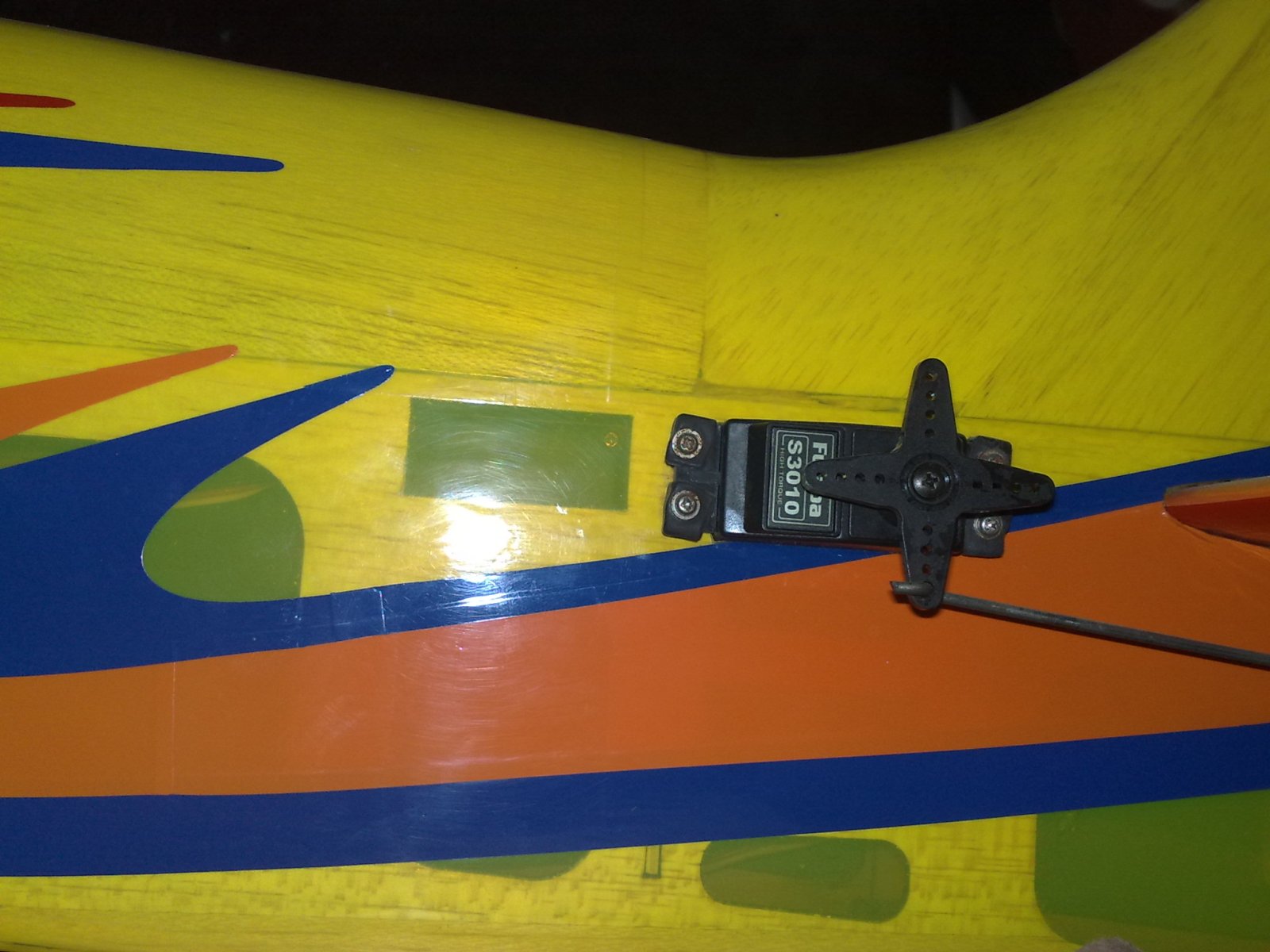

I will setup the servos on 1st and 8th (I think) channel to turn in the same direction, then mechanically oppose them. i.e. on one side the pushrod z-bend will be in the servo horn hole on the top side and on the other it will be on the bottom side. I will either use the 6-armed horn or aluminium horns from GP similar to the one I need to use on the Reactor Bipe. Since I will use the "1" numbered arm on both sides, the servos will move in sync. I will do the same with the ailerons
This is where I need advice.
1) I read somewhere that the two standard sized servos will not fit into the fuse as the tail is not wide enough and the elevator servo holes are in the same place on both sides. If this is so, I will have to get the more expensive low profile servos.
2) Will the 3010s be enough for the rudder at 6V or do I need to get different ones. After having a number of problems with Hitec I have given up on that brand, so Futaba it is
3) Do I need to replace the elevator and rudder horns with aftermarket ones- ball-link or cotter pin type or something (Sorry, I am not much into types of horns)
5) What else do I need to replace or strengthen

The elevator servos need to move in OPPOSITE directions to each other for both elevator halves to move in the same direction.
The aileron has no such requirement so you could opt to hook them both up to a "Y" cable and run them off one channel.
With the elevators you reallyl need to use one of the techniques I mentioned above.
IMHO the WORST choices are to put each servo on a separate channel or to use a cheap servo syncronizer cable.
The elevators end up with a lot of travel for 3D, and the delay becomes very visible at stick extremes. Mechanical opposition is still better than both of these options.
As Ahicks mentioned standard servos fit just fine.
Z Bends work fine, if you set them up as per the instructions and use "keepers".

Ok, I correct myself, the elevator servos are setup on the same side and reversted through the radio's programming. The aileron servos are setup as described above. I am attaching pictures of the Reactor's setup for reference

As I mentioned previously I do not like the separate channels for the Elevator servos as you are intending.
Communications from the TX is serialized so moving up the channels introduces a slight delay.
e.g. Channel 1 gets transmitted, then 2, then three, then four, then five... etc.. so by the time you hit channel 8, you may have a 80us delay or more in play....
Normally this is so small that it is not noticible, but it does produce a big effect on the elevators.
Not so on ailerons because their surfaces tend to be thinner, and even if there is a lag, the leading aileron doesn't really affect the trailing one.... e.g. you CAN fly a plane with only one aileron working and hardly notice the difference in some circumstances.
With the elevators having one out of sync imparts a small rotational difference that comes into play during manouvers.... harriers, hovers, etc.
I know the newer JR TX's have a provision that minimizes this effect, where linked channels are transmitted in adjacent bursts.

Actually, you dont need to electronically reverse the servo or use a syncroniser. Let us take the LHS servo looking from the tail- if it turns counterclockwise with the pushrod connected to the servo arm above the pivot point, it will pull the elevator down. Now consider the servo on the other side. Here also the servo rotates counterclockwise but has the pushrod connected into the same horn hole but below the pivot point.
Again I would NOT suggest doing this with the Funtana. You CAN do it, and the results ARE better than say using different TX channels, but with the large control surface movements of the Funtana you'll still see that one side will rise higher or lower than the other... and that will result in a tendancy for the plane to roll slightly at high deflections....

I have the Funtana 125, built it this last summer and it has descent hardware but mypush rodswere short, the spinnerdoesn'tfit the motor and it came and it came with CA hinges.I'mnot dogging the plane because I like the plane but Hanger 9 and Horizon leave some to be desired.
~ Its a heavy plane but seems to be quite durable
~ The manual has a many places that are wrong. When you fly your plane make sure...and I do mean make sure the thing is nose heavy because the CG specs are off. I fly mine not too far from the forward CG.
~ Be sure to go light on the tail.I am using the Hitec 7775MG low profiles all around but recently switched the elevator servos to the 225MG to lighten the tail as the plane will fly tail heavy at their recommended CG.
~ You will want to shave weight when possible if you are going to fly this plane 3D.The plane will be heavy with an 8s setup if you do electric. I have mine that way now and am in the process of changing it to a 6/7 s setup and I am going to try and run the AXI 5320/18 as it fits the power 110 mount perfectly. I am using the Hitec 7775MG.I changed the wheels, and anything I could to get the plane down in the mid to low 9lb area and on less batteries it should be lighter. Use a Extreme Flight spinner (lighter than Dubro) and a 18x8 or 18 x10 xoar prop (43g) vs (73g).
~ itdoesn'tcome with the SFGs. You will want to use these as the plane will have significant rock at low speed.
With all that said its a good plane if you can overcome a few of the frustrations. I also had the servo lag issue with the dual elevator and am going to go with the Smart Fly Equalizer to do the servo sync as the Dx7 seems to not mix equally.
