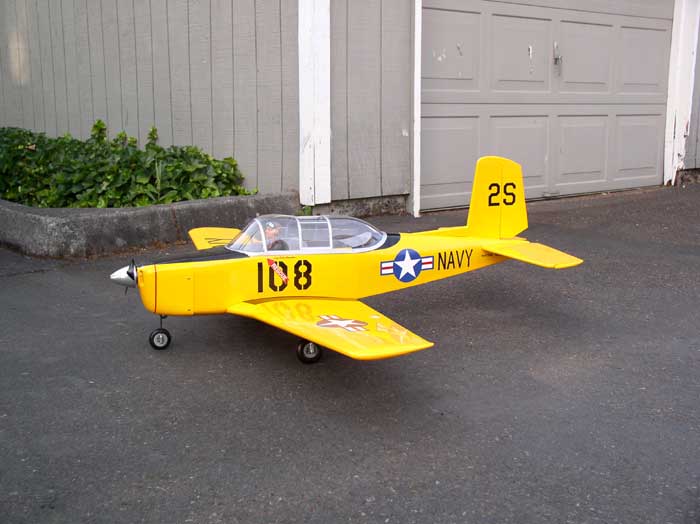

Old 08-09-2003 | 03:04 AM
Posts: 6
From: Battleground, WA
Default Hagar 9 T-34
Here's a pic ready to go. The Hitec retract servo works fine. Scale for this pilot is 1/6 and seems to be about right.

Old 08-09-2003 | 03:08 AM
Posts: 6
Spinner size is 2-1/4"

Old 08-09-2003 | 07:53 PM
Oregon Craig's Avatar
Posts: 666
From: Sandy, OR,
Awesome, RickA! Thanx for pix! Which engine is that in there? Let us know how it goes.
