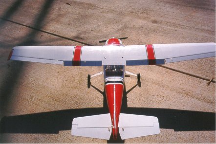

Old 06-09-2002 | 09:46 PM
Badge's Avatar
My Feedback: (21)
Posts: 850
From: Richmond Hill GA
Default My Baby
Heres a few pics of my baby:
