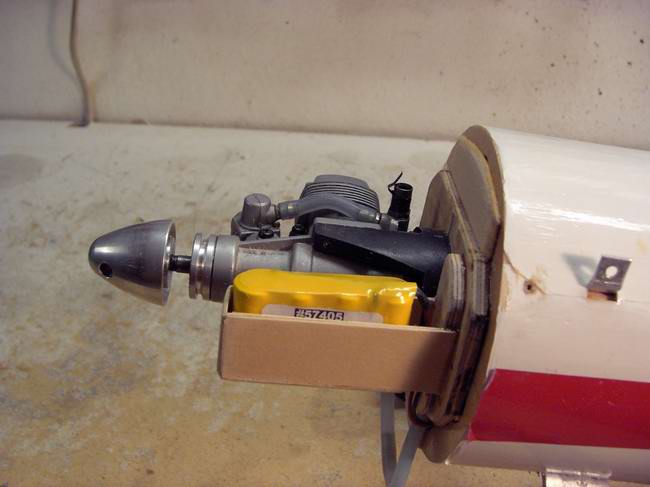

Have you thought about moving the battery to the engine mount? I have one with two packs in the cowl. I mounted a ply board to the side of the engine box positioned to the bottom of the engine. Then with foam and Velcro straps, put a battery pack on each side of the ply. My engine is inverted, but this could work for a side mounted engine, depending on how the motor box is made.

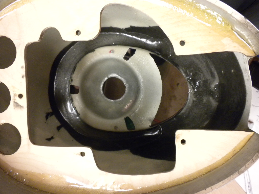

I have a new item that my brother and I are making available. We call it 'Steel Powder'. It is indeed a powdered steel that we mix with epoxy. Very dense, very heavy. Cheaper and easier to use than led. It can be molded, pained on, poured into, anywhere you would use epoxy. Great for using behind firewalls, in cowls, nose cones, and the like. It will not come loose, and doubles to strengthen anything is is applies to. Very easy to mix with 15min epoxy and pour in.
Lead is now considered a hazardous material (DO NOT INHALE FUMES FROM MELTING IT) and will be less available as time goes on. Some states are banning it's use even now.
PM me if you would like more information. Here is a picture of it in my Meister cowl.

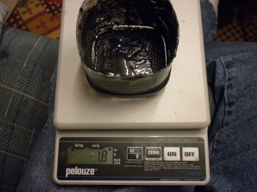

Here is my process. Just finished doing this for my Meister P-47.
I mix the amount I need right on the scale, adding a couple ounces for what sticks to the container. This time, I used 20min epoxy, because i was mixing over a pound of ballast. This gives you plenty of time to mix it well. Then simply pour it in and work it around where you want it. It is very heavy, very easy, adds strength to whatever you put it on, will never come loose, and is completely safe.

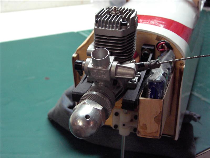

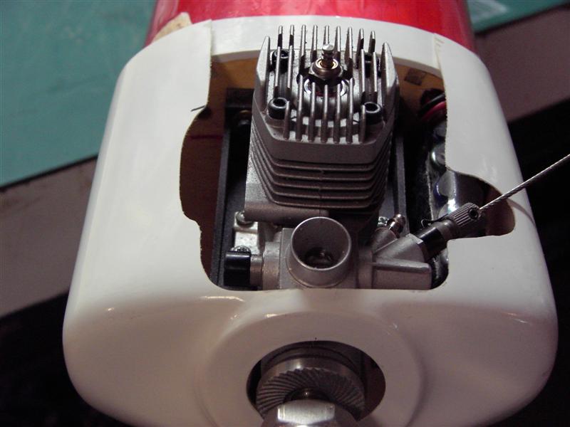

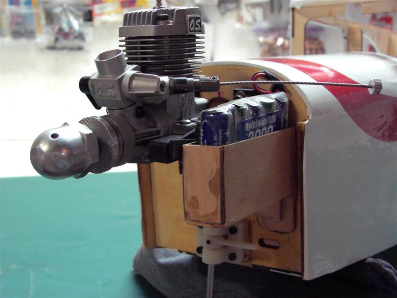

ORIGINAL: Pillzee
I also have the battery as far forward as I can get it. The plane is still very very tail heavy.
Betcha ya don,t have it this far forward and so easy to do
John
