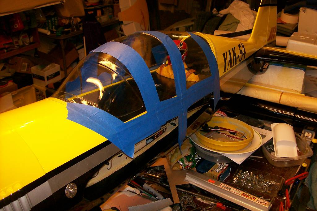

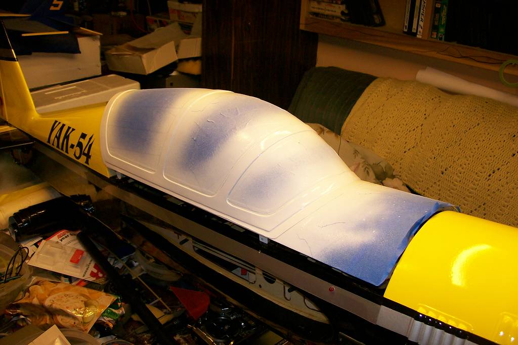

pic 1 - canopy glue &amp;film (Ultracote) - the canopy is glued to the edges of a 1/8" balsa sheet shaped and tapered to match the inside of the canopy exposing 1/8" of wood as seen thru the canopy - so the film was added for cosmetic purposes.

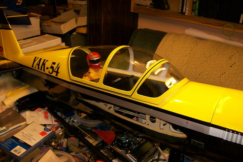

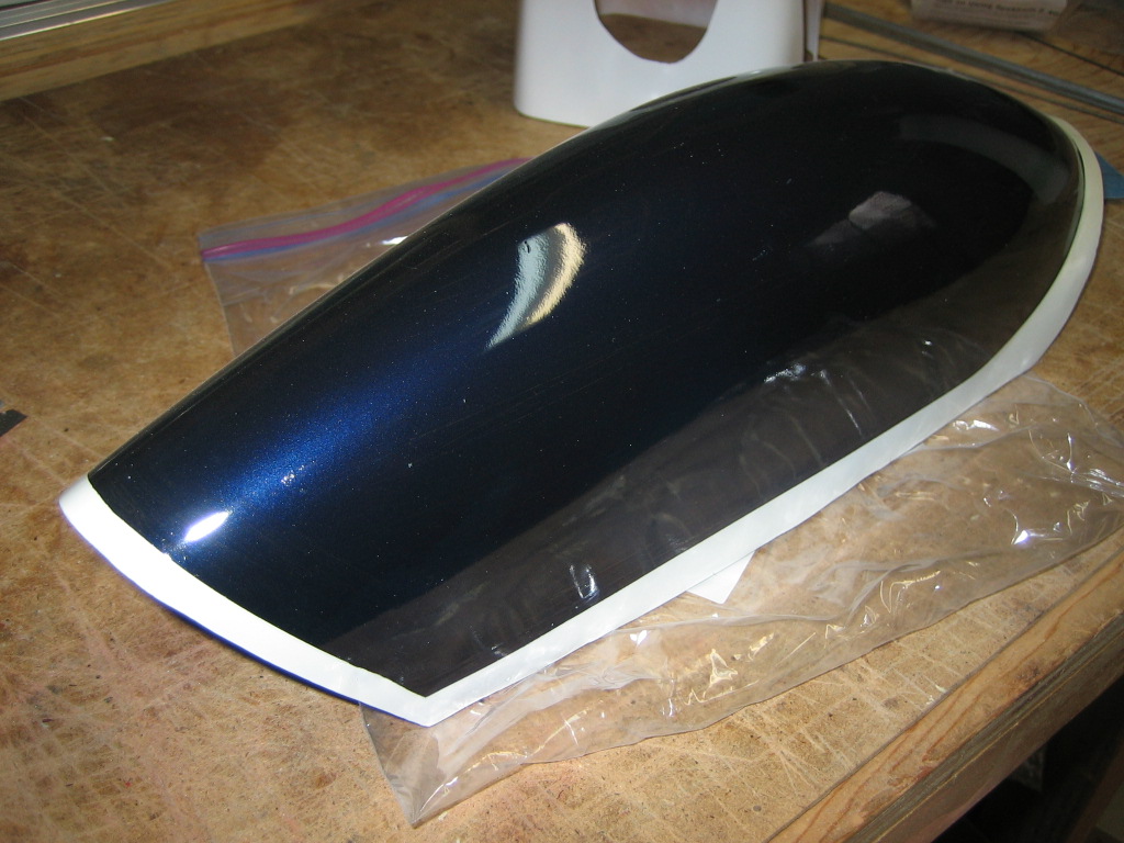

pic 2 - wood screws &amp; tape (tape is Great Planesproduct)

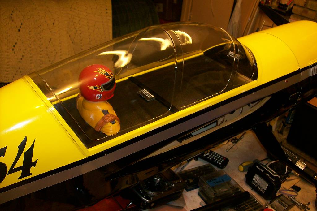

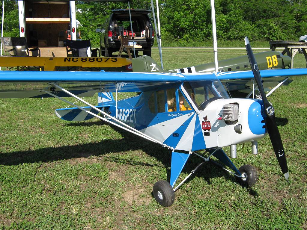

pic 3 - wood screws &amp; film (Ultracote) - this was after a crash-n-rebuild. The canopy was really scratched so Ipainted the inside of the canopy with blue pearl auto paint.
Downside of film trim is that it must be stretched-shrunk to navigate tight turns.
Question to the experts. When working on ARF windshields / canopies, do you cut a strip about 1/16" thru the film exposing raw wood where the canopy meets the fuse or do you just glue over the Mfg's covering?

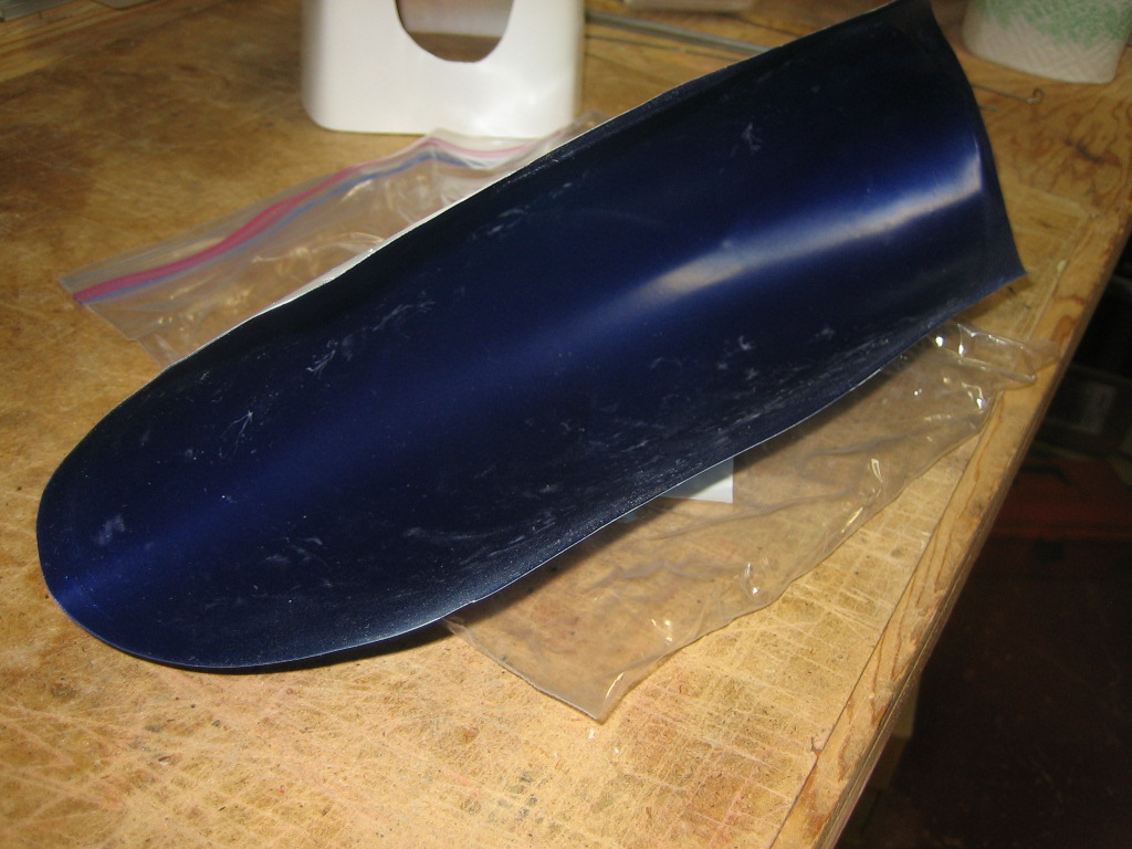

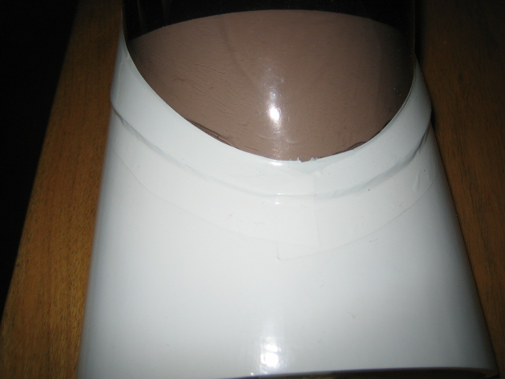

I do not cut through the covering. Make sure it is well adhered to the wood prior to installing the canopy. If it is, it will be fine. here is one I did this way, and then painted.
there is more than one way to do this, but I have never had problems with this method. Been at it over 40 years.

Thank you. Personally, I just don't like screws in canopies. i try to avoid them if at all possible. I recently found out that Elmer's white glue is the same stuff as RC 56 canopy glue. Much less expensive, also dries clear, and works just as well.

Follow up on the use of sheet metal screws to hold on the canopy. In a previous post I included a picture of a ShowTime 50 canopy held on by 6 screws along the sides with film over the leading edge.
I just did an engine run-in on a bench at the field. Surprise, the 2 rear screws no longer help holding the canopy on as the canopy cracked and broke around those two screws. This wouldn't have happened if a canopy glue were used.

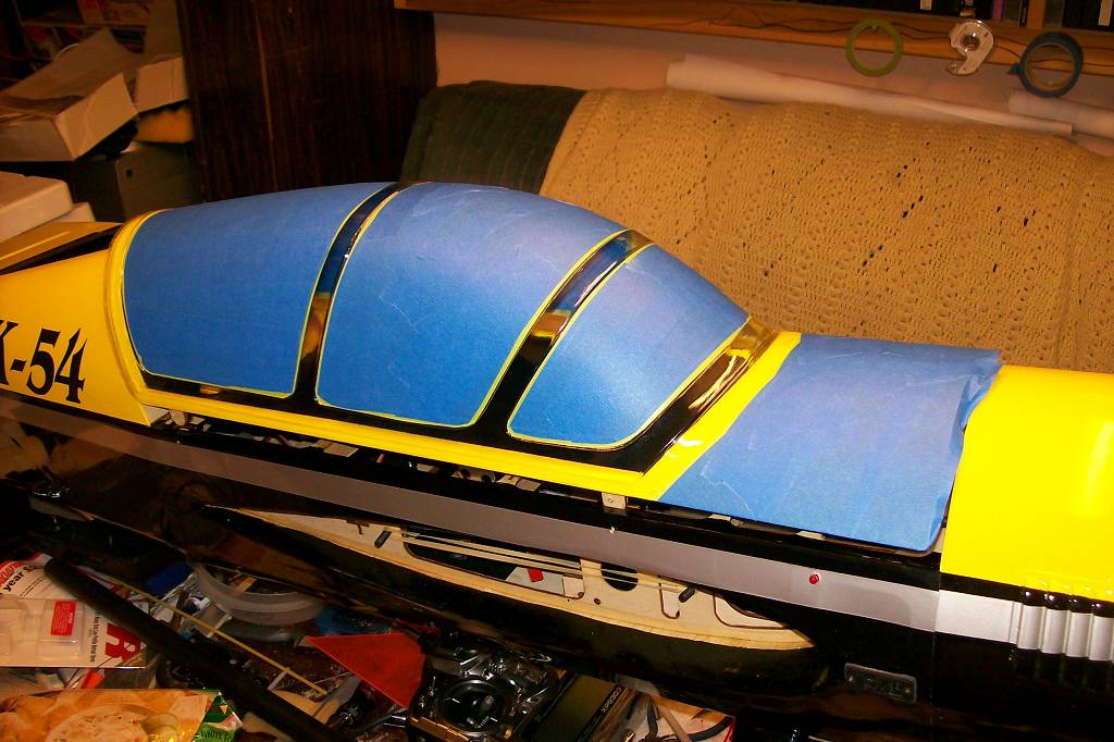

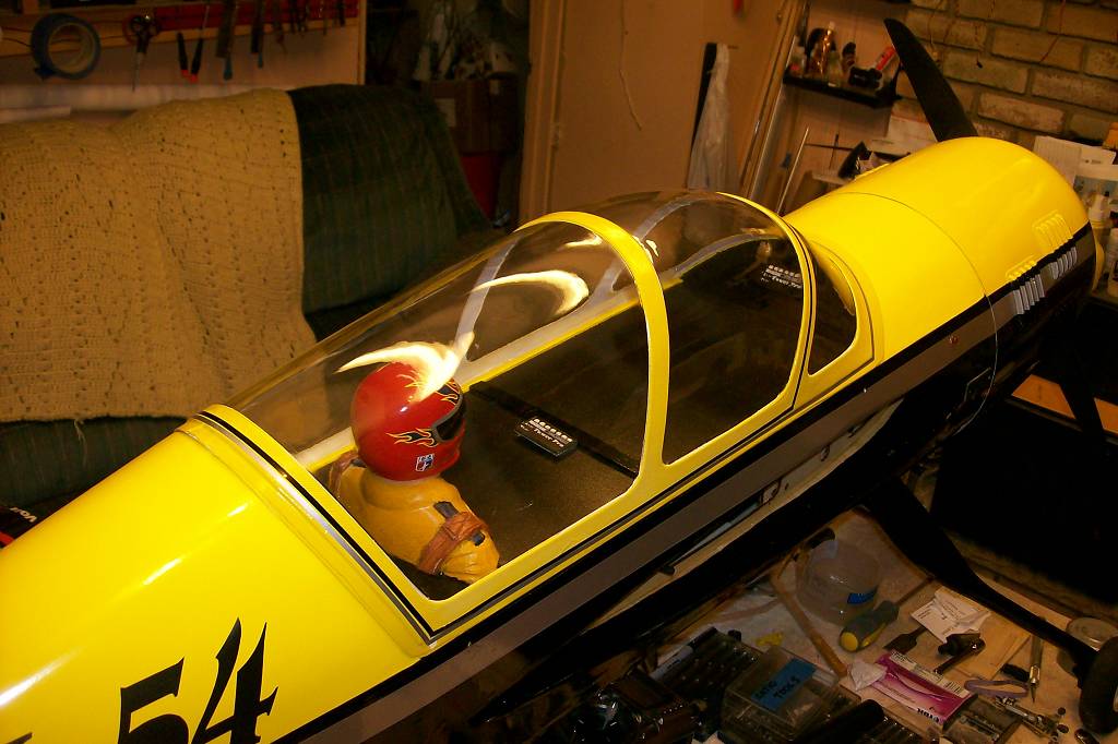

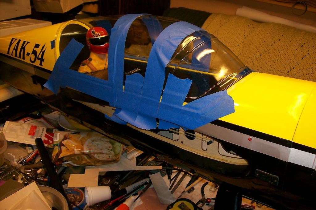

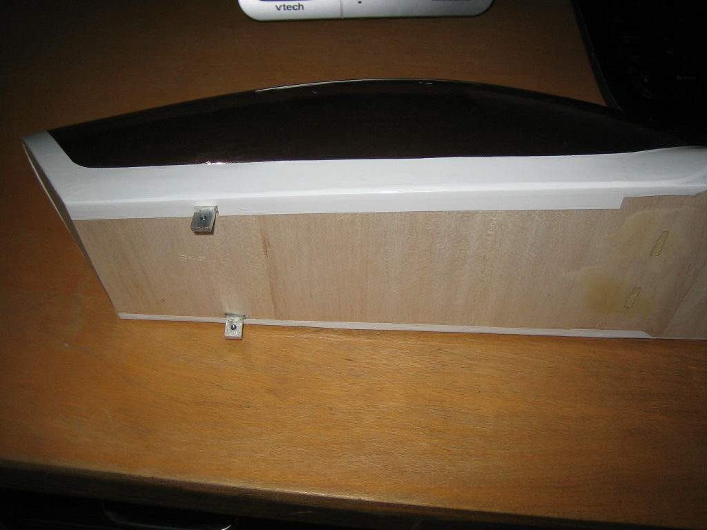

A couple of follow-up notes on using any glue to attach the canopy.
The first is make that the structure being glued to is in its "installed" shape. I replaced the 6 screws with RC56 glue to attach the canopy to the hatch but Idid it on the bench - NOT with the hatch installed on the fuse. As a result the hatch's shape changed enough to mis-align the side hatch mounting screws. When trying to apply a bit of persuasion at the field my finger went through the canopy (I believe that is was significantly weakened by painting the underside with auto paint making it very brittle). As a result I fabricated a new hatch and ordered a new canopy from Hanger 9.
The second installation was done with the hatch afixed to the fuse with the side mount screws. The canopy was dry fitted and then marked for installation alignment. Thin 1/16" strips of Ultracote were removed and the RC56 applied. The canopy was installed using the alignment marks. After the glue dried the entire perimeter was covered with matching Ultracote strips using low heat to avoid warping the canopy. The leading edge of the canopy looks a bit like Donald Duck's bill but it's not bad. Everything will be nicely fuel proof.
TTFN
PS- added the pics of the original canopy after painting the underside
