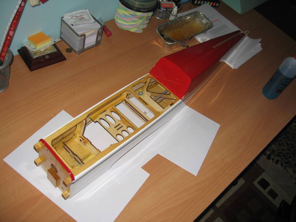

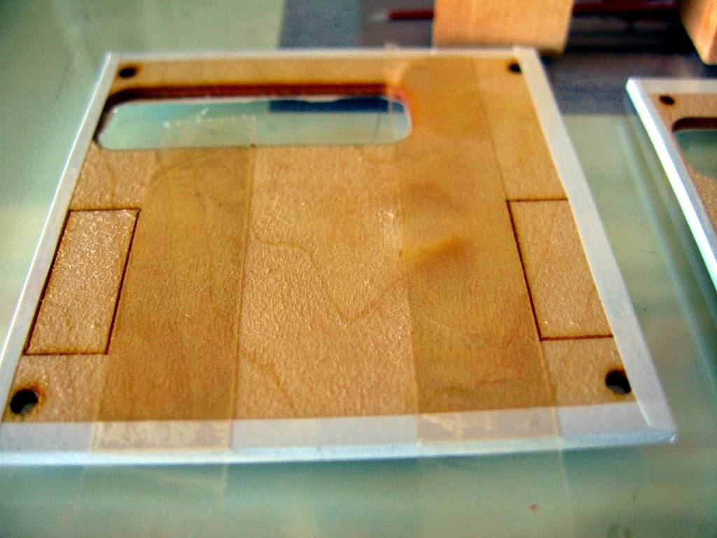

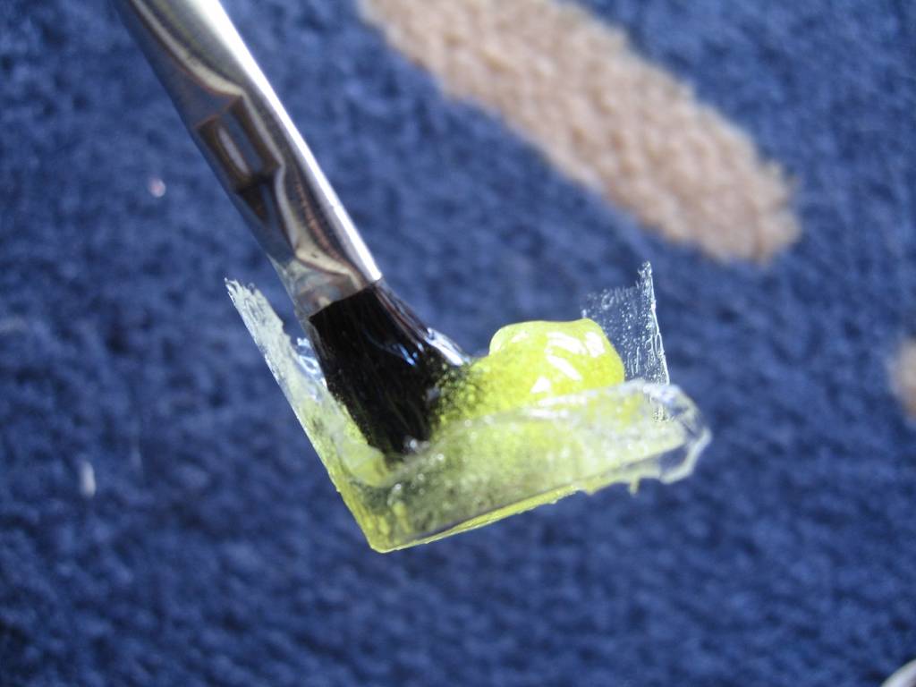

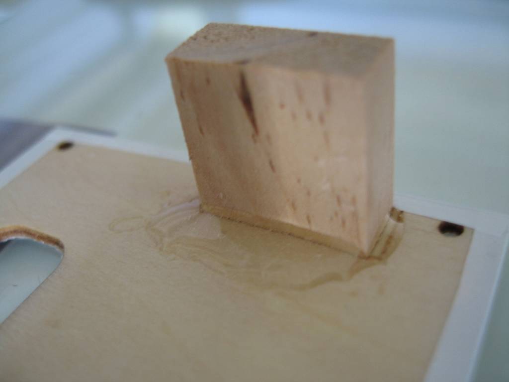

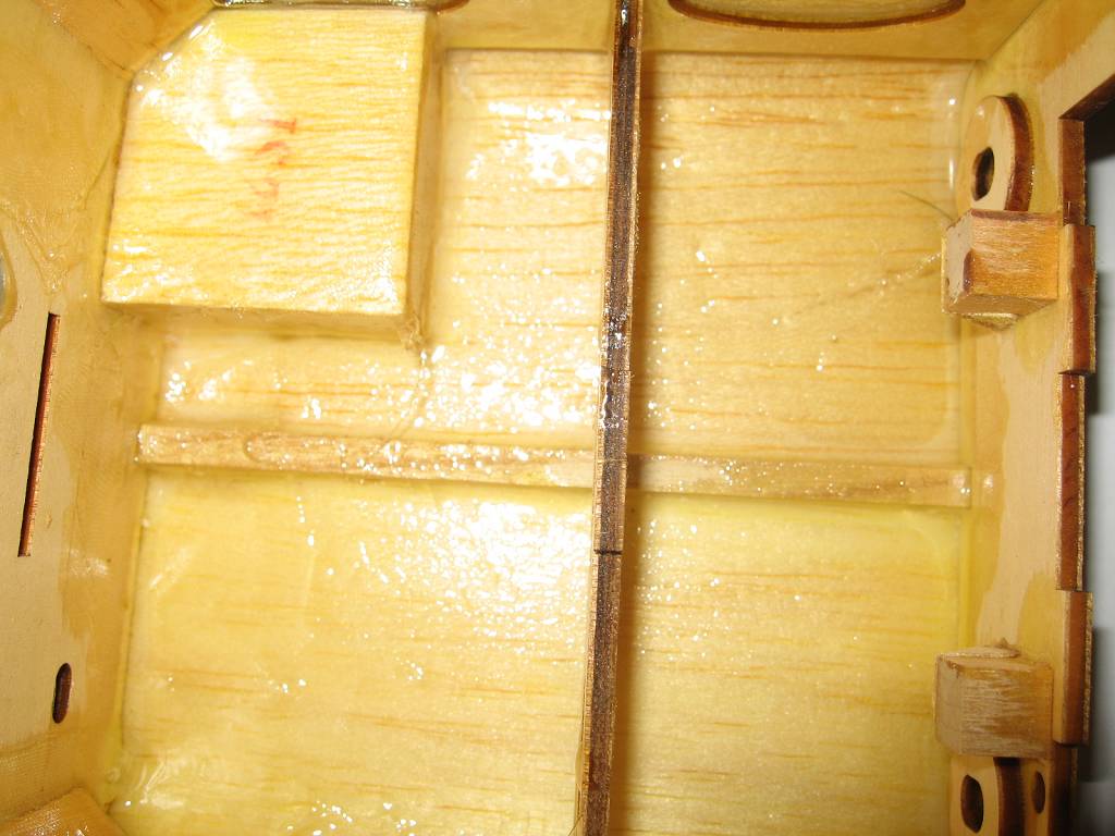

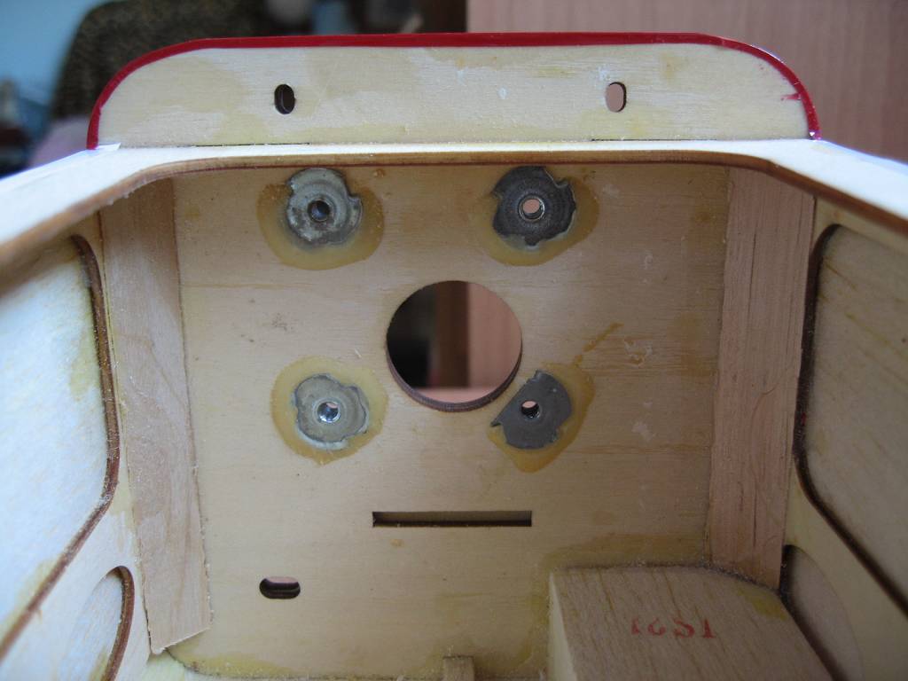

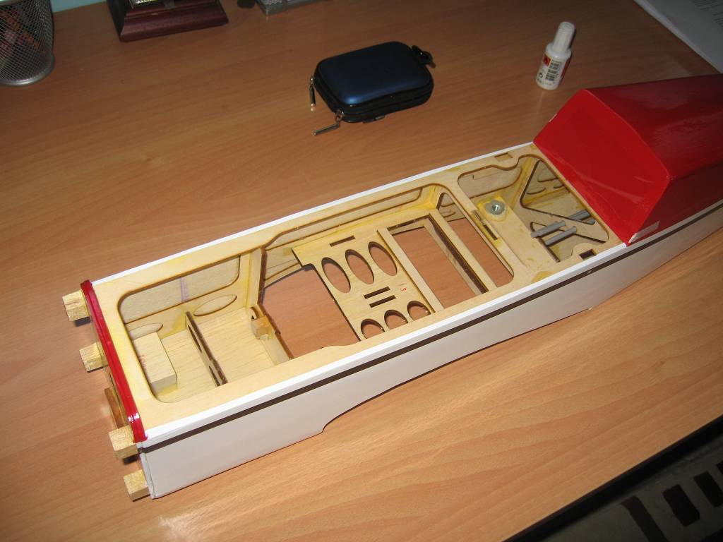

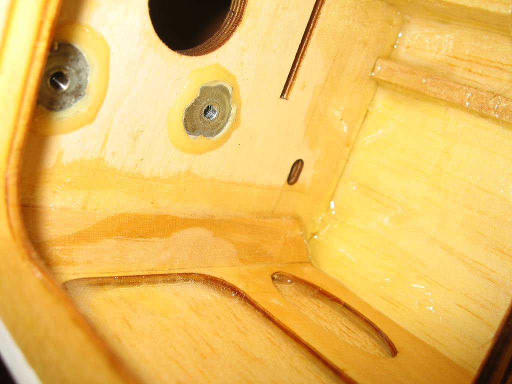

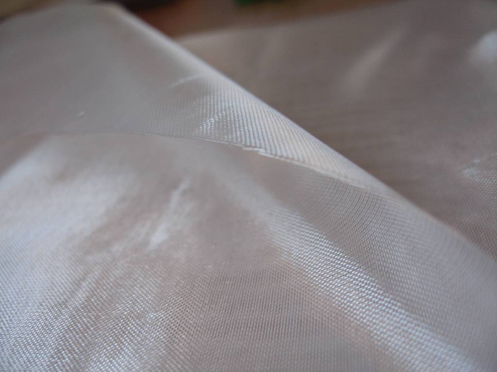

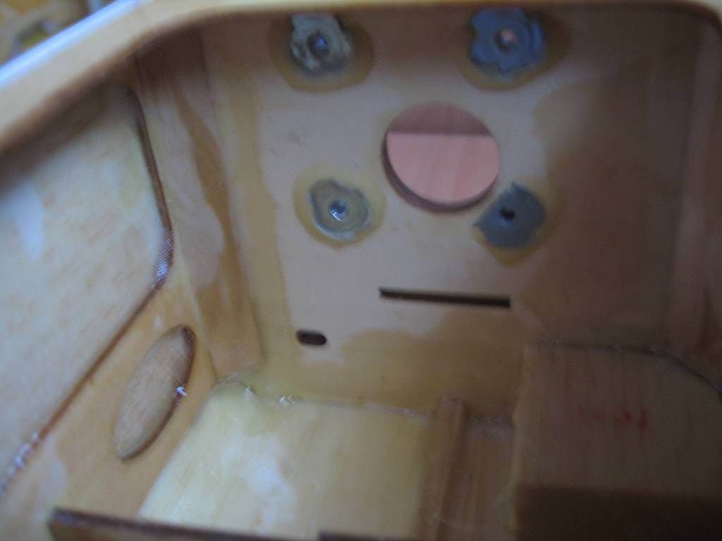

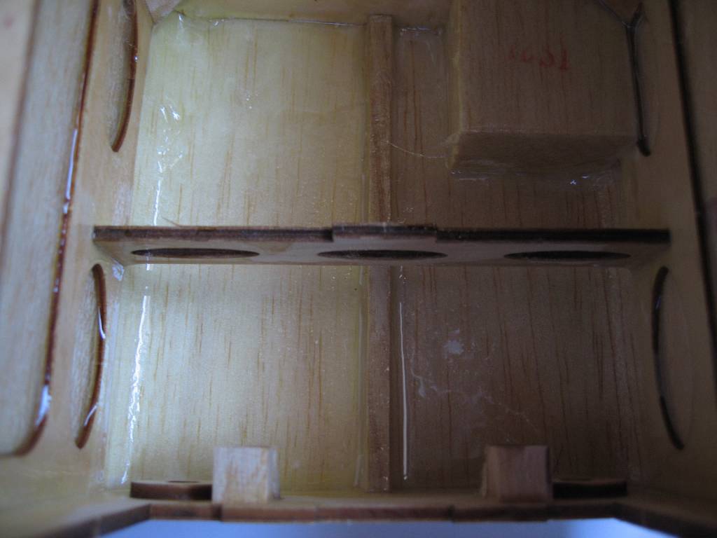

Today i will start assemblying my GreatPlanes Cherokee 40 ARF !
The engine is already bought, a very nice SAITO FA-80 4str.

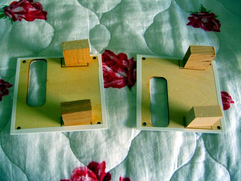

First i am going to strengthen the fuel tank area with thinned Epoxy ( 30' ) & fiberglass cloth...
Enjoy some pictures.

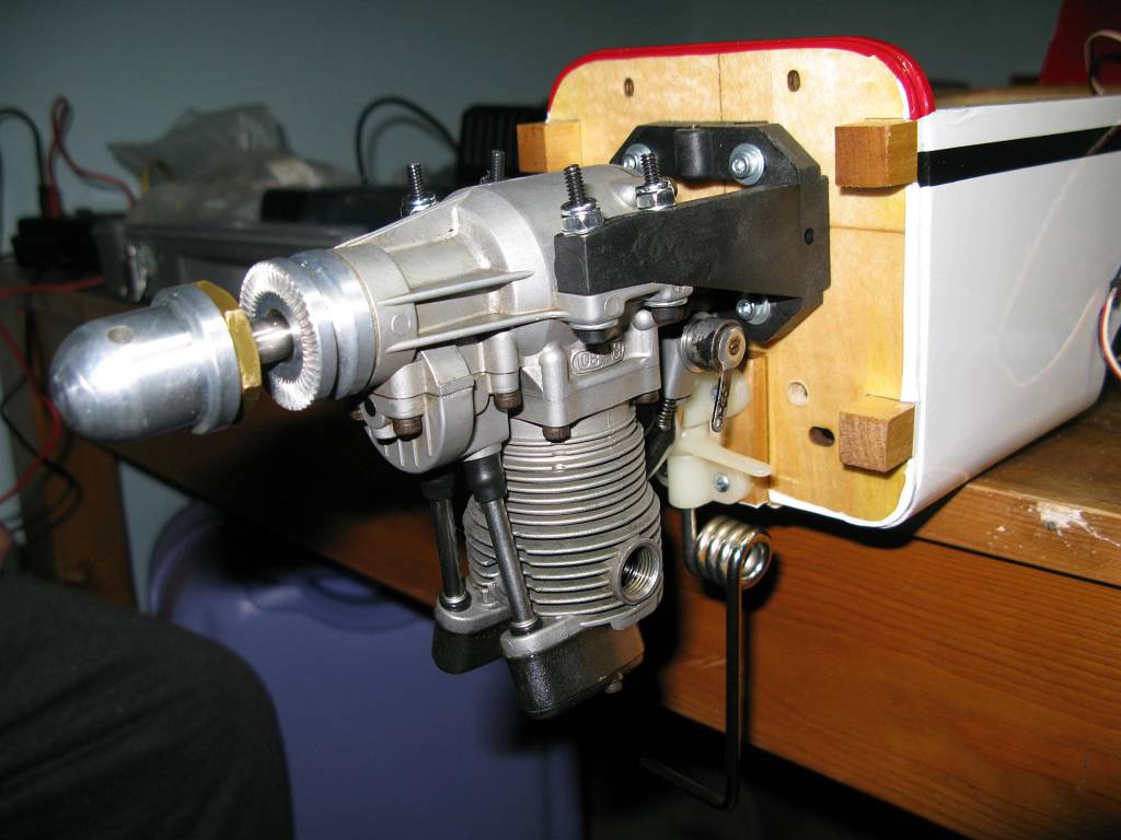

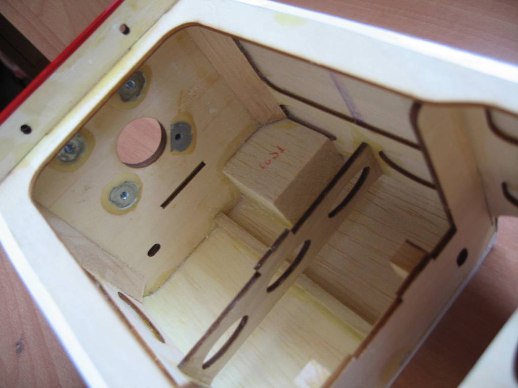

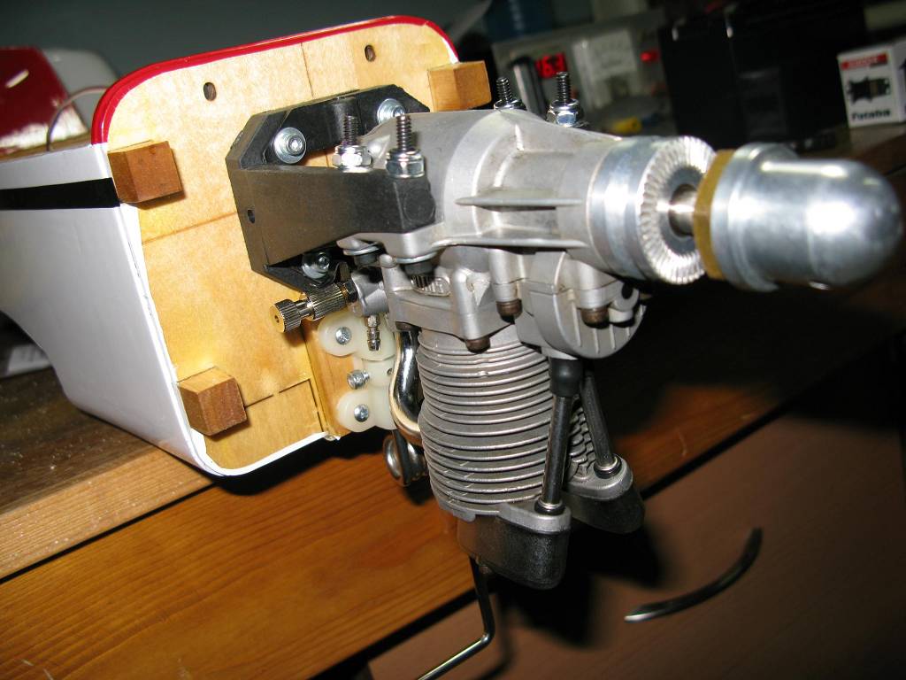

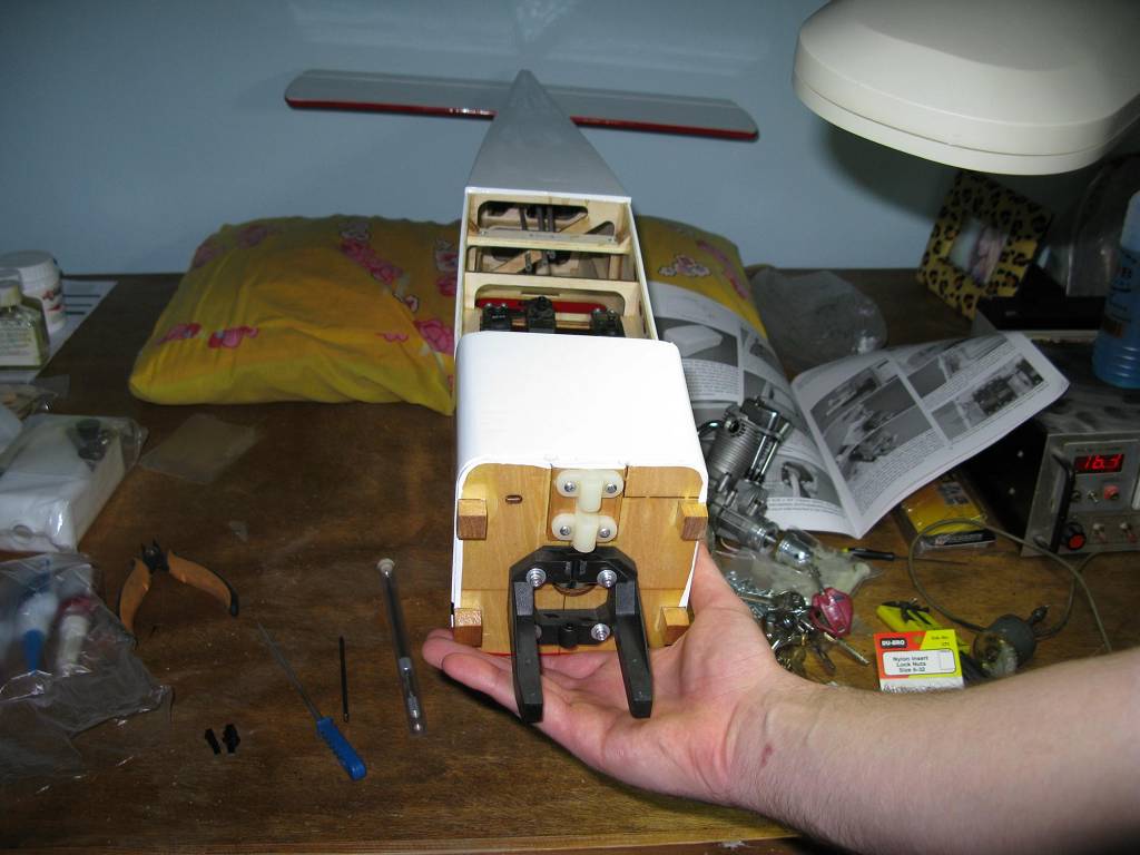

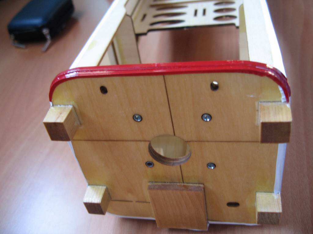

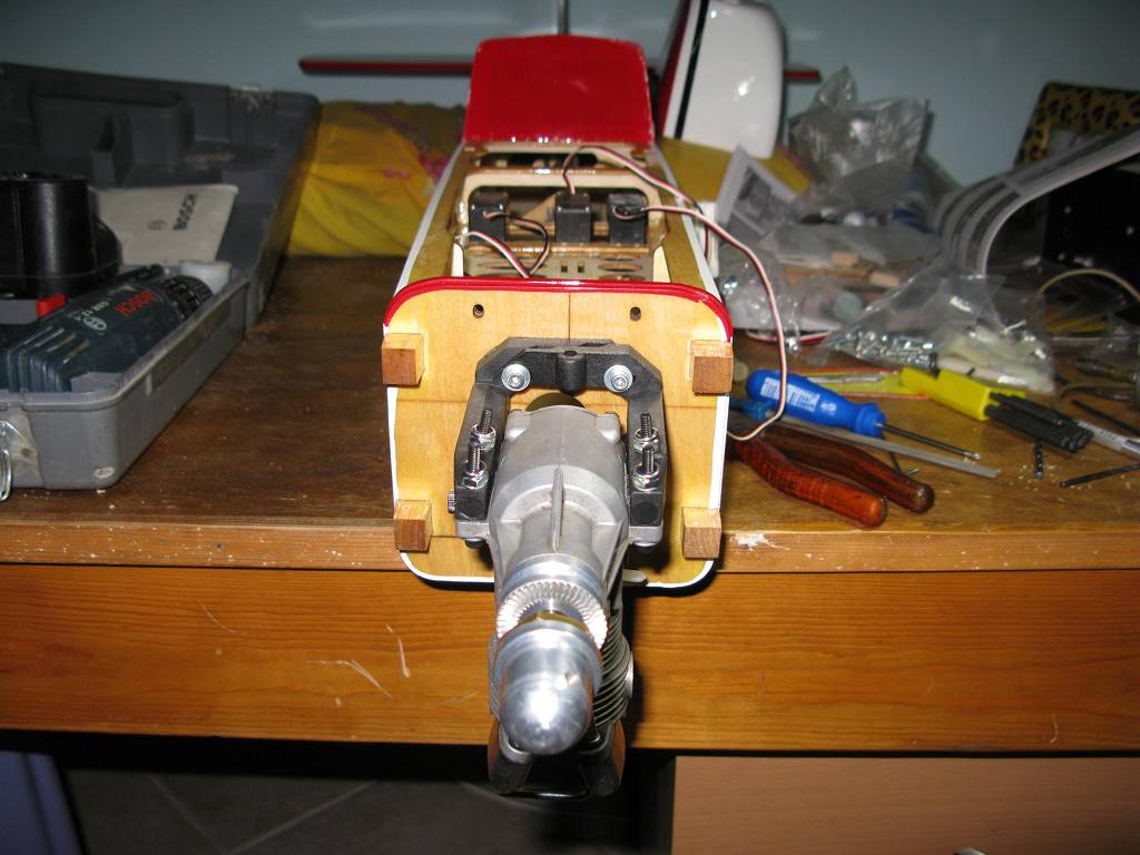

Yesterday,
i installed the Saito FA-80 on the firewall & i used the supplied engine mount.
The beams where a little bit too short because the intake assembly was hitting the nose steering arm assembly.
I installed the engine as far forward as i could,practically at the end of the beams of the engine mount.
I used Dubro 6-32x1-1/2 SHCs , washers and 6-32 safety locking nuts.
For mounting the engine mount on the firewall i used the supplied 6-32x1in. SHCs with success and some thread locking compund.
x3 servos inside the fuselage are also installed,so far.
Pictures will be posted soon.

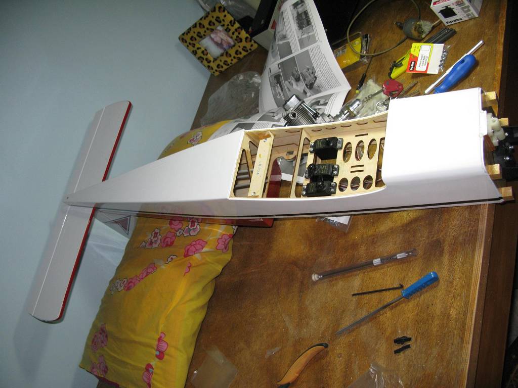

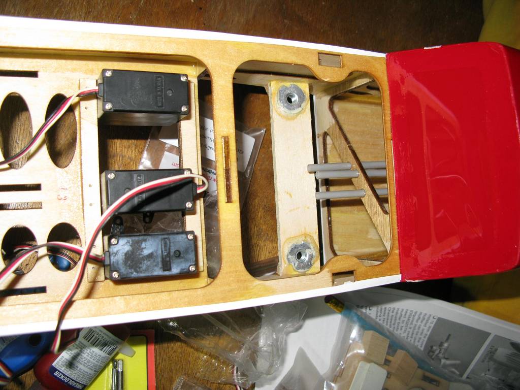

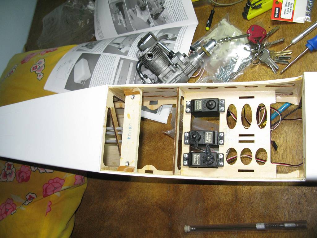

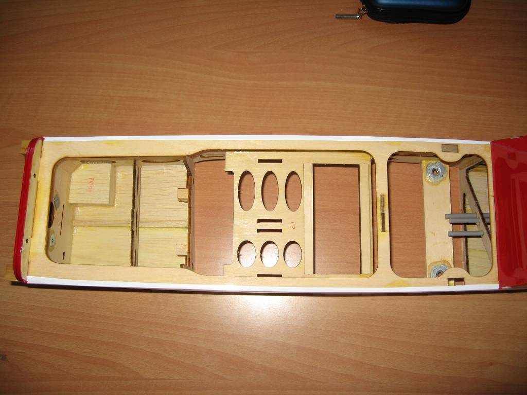

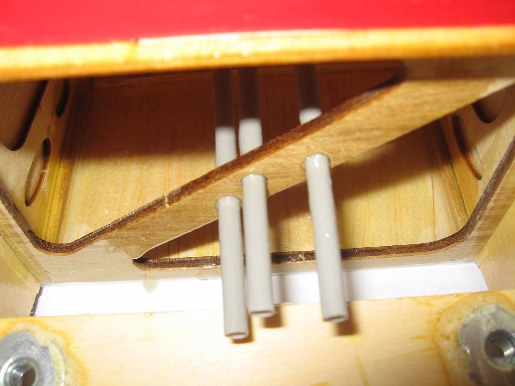

Fuselage SERVOS mounted
I used x2 Futaba S3004 for rudder & elevator and x1 Futaba S3003 for the throttle.

Engine successfully mounted : SAITO FA-80

The one thing that concerns me on your engine mounting is that the engine mount bolts look to be curved when the nuts were tightened down. That looks like it may be because of the angle of the bottom of the motor mount. That bend in the bolts puts some stress on the bolt and while you may never have a problem with the bolts breaking you might consider re-doing that a little bit. When I have run into this I have usually filed or ground down some of the engine mount level where the bolts pass through on the bottom of the mount to make sure the bolts get tightend straight without causing them to bend. In this case I guess you would say it's the top of the mount because your engine is mounted inverted. Just a suggestion .
I would imagine your Cherokee is going to be a screamer with that Saito .80.

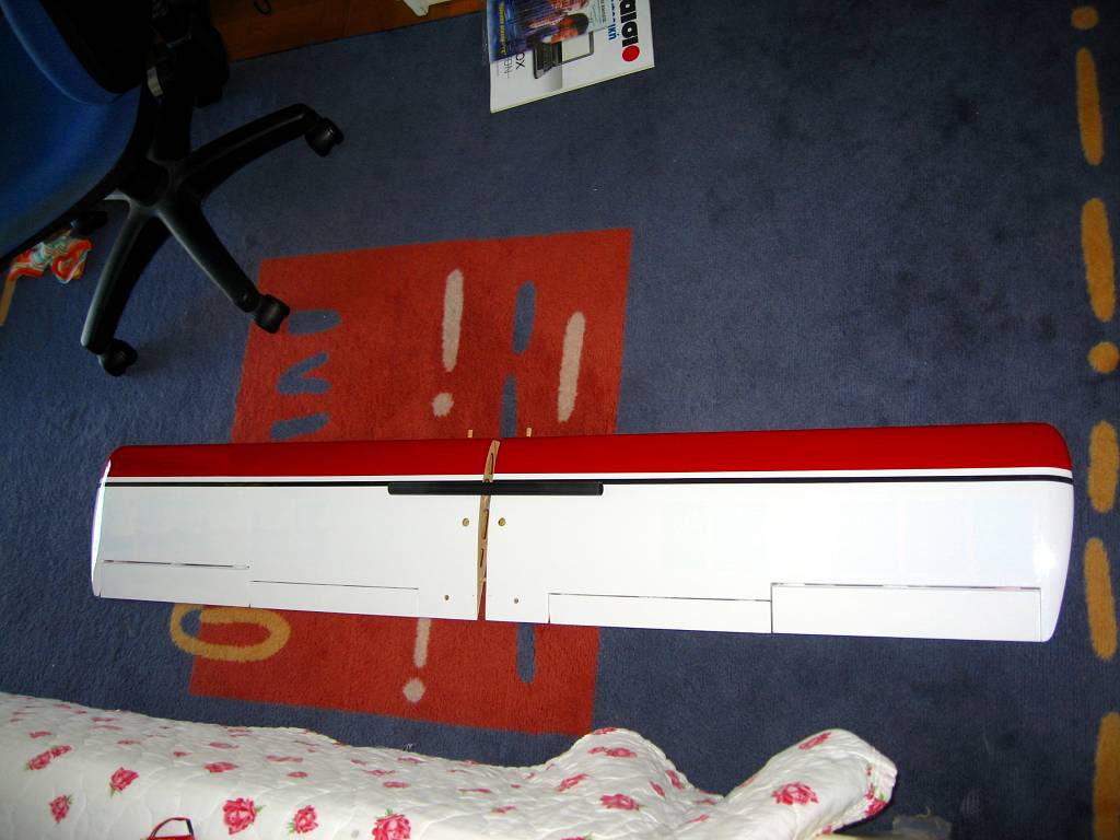

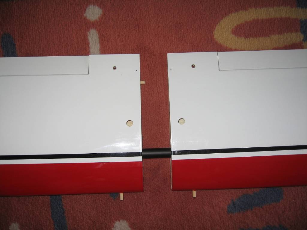

after a short break, i am assemblying the wing....
oh....that wing-tube has a very tight fit inside the tubes of the two wing halves....
Old 05-11-2011, 07:55 AM
Kostas1
Kostas1's Avatar
Join Date: Dec 2005
Location: AthensAthens, GREECE
Posts: 3,566
Default RE: Greatplanes Cherokee 40 ARF Assembly Thread

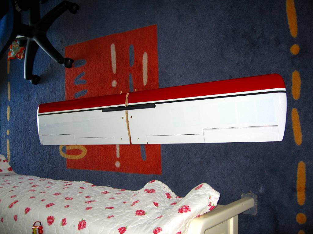

Ok....

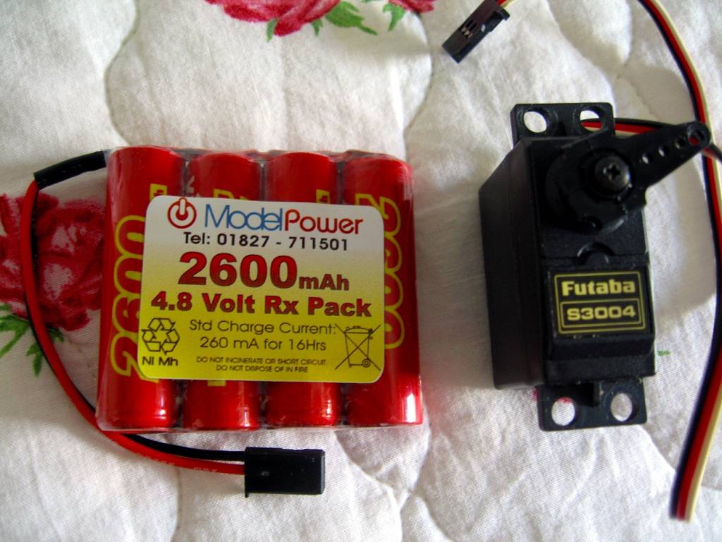

x2 aileron servos installed ( Futaba S3004 ) & x1 flap servo installed....( S3003 )
As i said the wing tube fits inside the wing halves , very tight...But this is good.

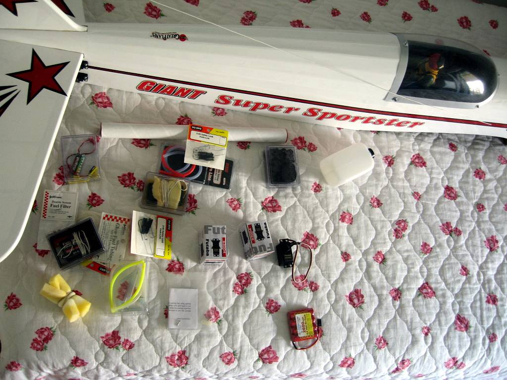

Here is some of the equipment i will use.

Some more....
I used 5' epoxy to glue the servo, rectangular, blocks.
I will also use a NiMh 2.600mAh battery !

Some more.....[8D]
Watch the colour change of the epoxy while it dries.....oh the temperature really goes high!
I also used this "trick", with the clear tape to remove the excess epoxy while it dries,
so as not interfere with the servos.
