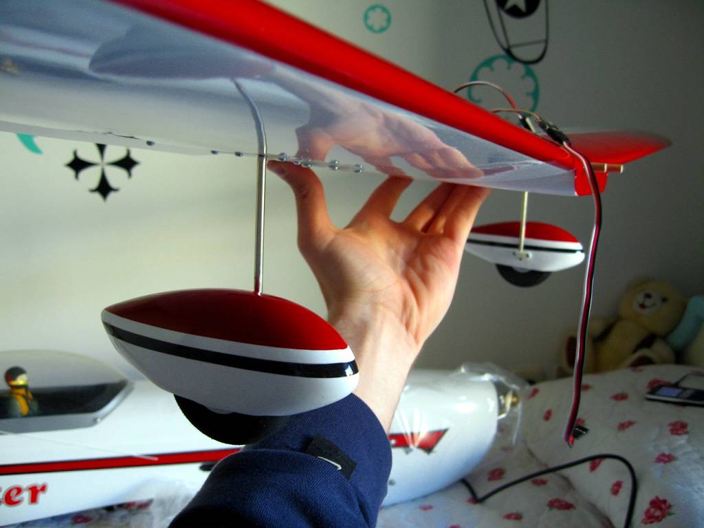

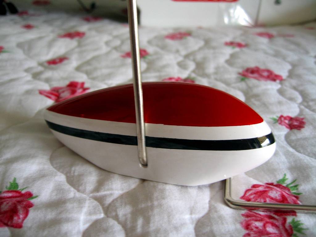

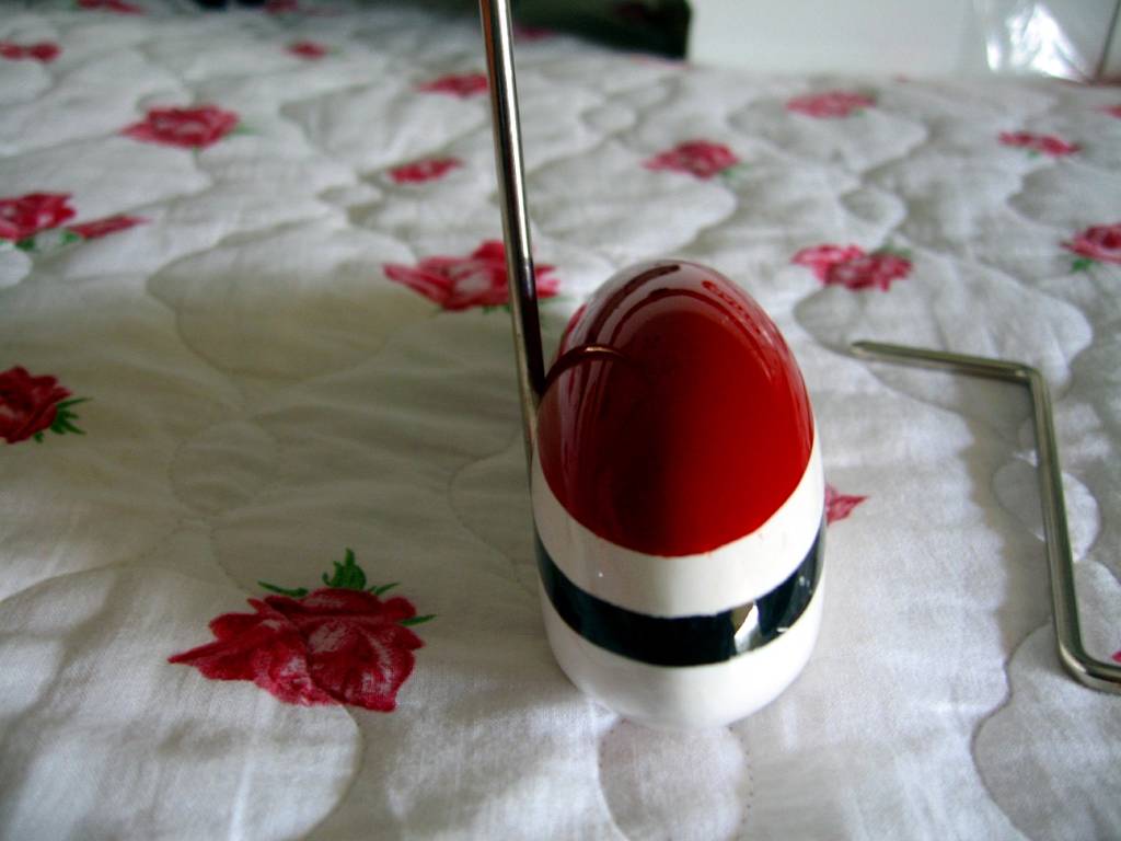

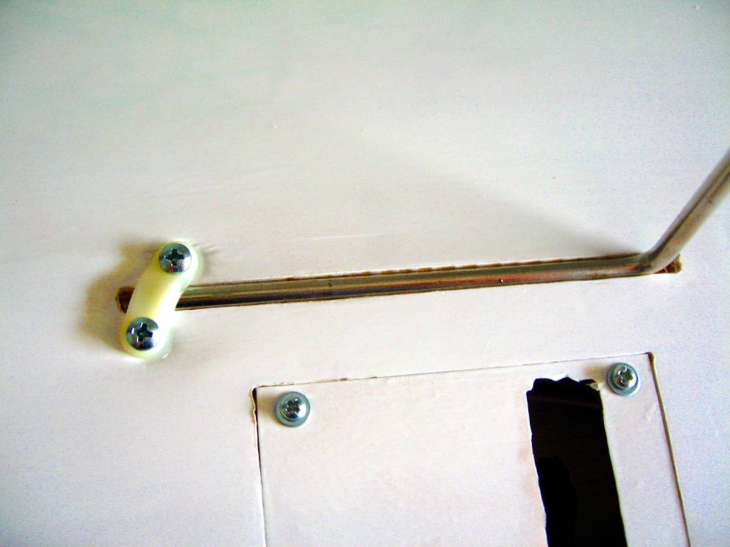

Test fitting the wheel pants.....
ID:	1607528   Click image for larger version
ID:	1607529   Click image for larger version
ID:	1607530   Click image for larger version

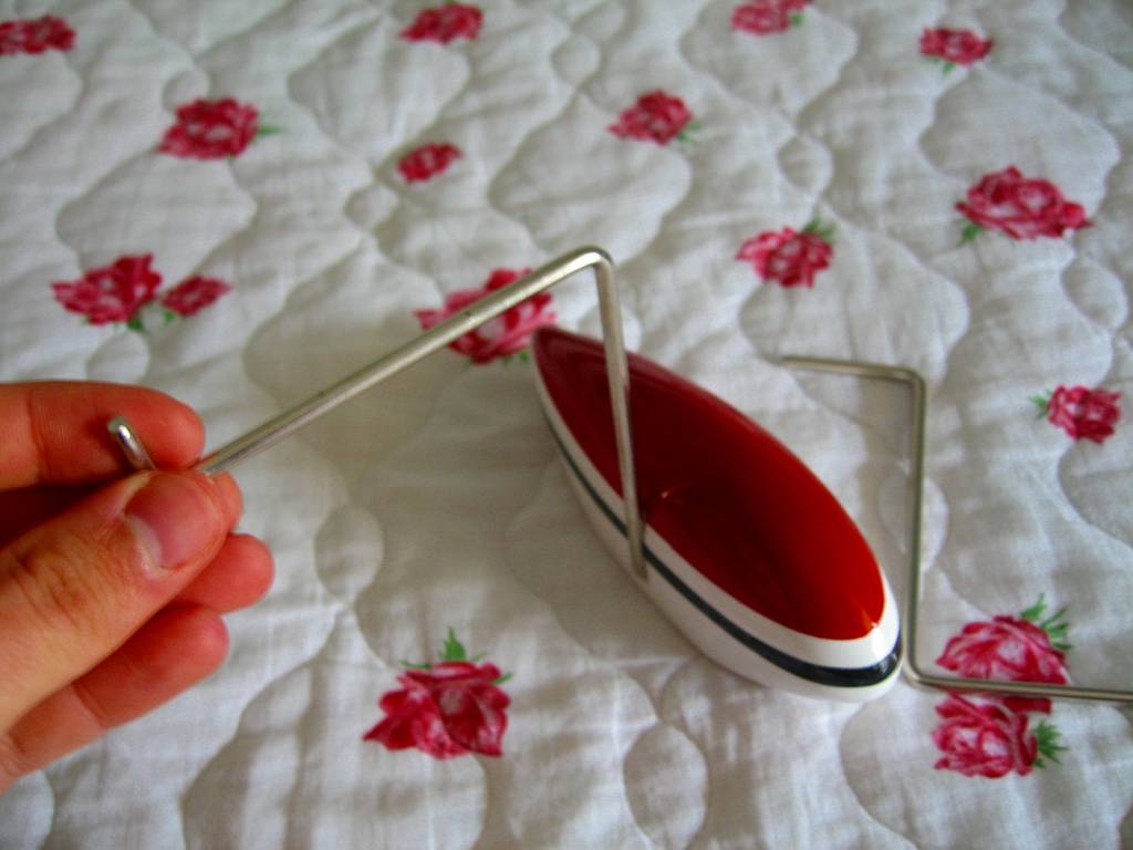

Installing the landing gear.....
Be careful, because the wood is very very hard and snaps if you tighten the screws too much!!!
ID:	1607532   Click image for larger version
ID:	1607533   Click image for larger version
ID:	1607534   Click image for larger version
ID:	1607535   Click image for larger version
ID:	1607536   Click image for larger version

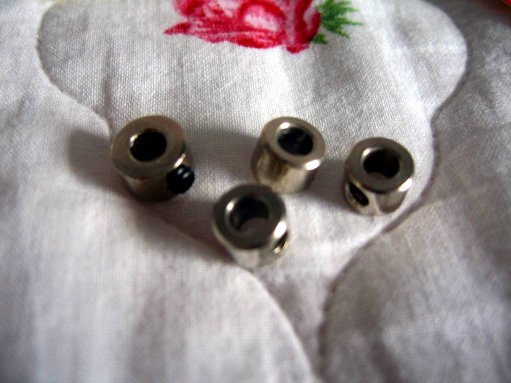

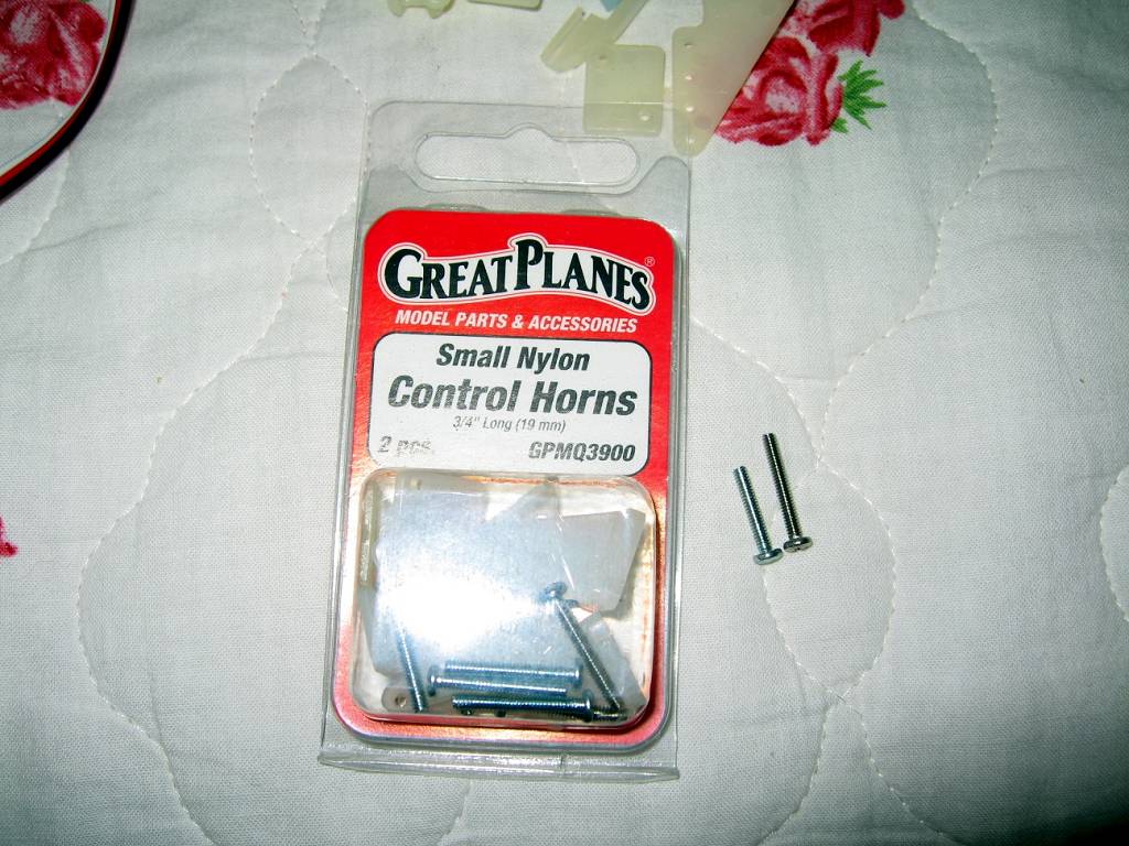

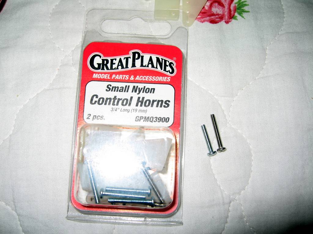

Ohhhh once you open the pack that contains the screws please check if you have the small screw on the wheel collars!
From the x6 of mine only x1 had it!!!

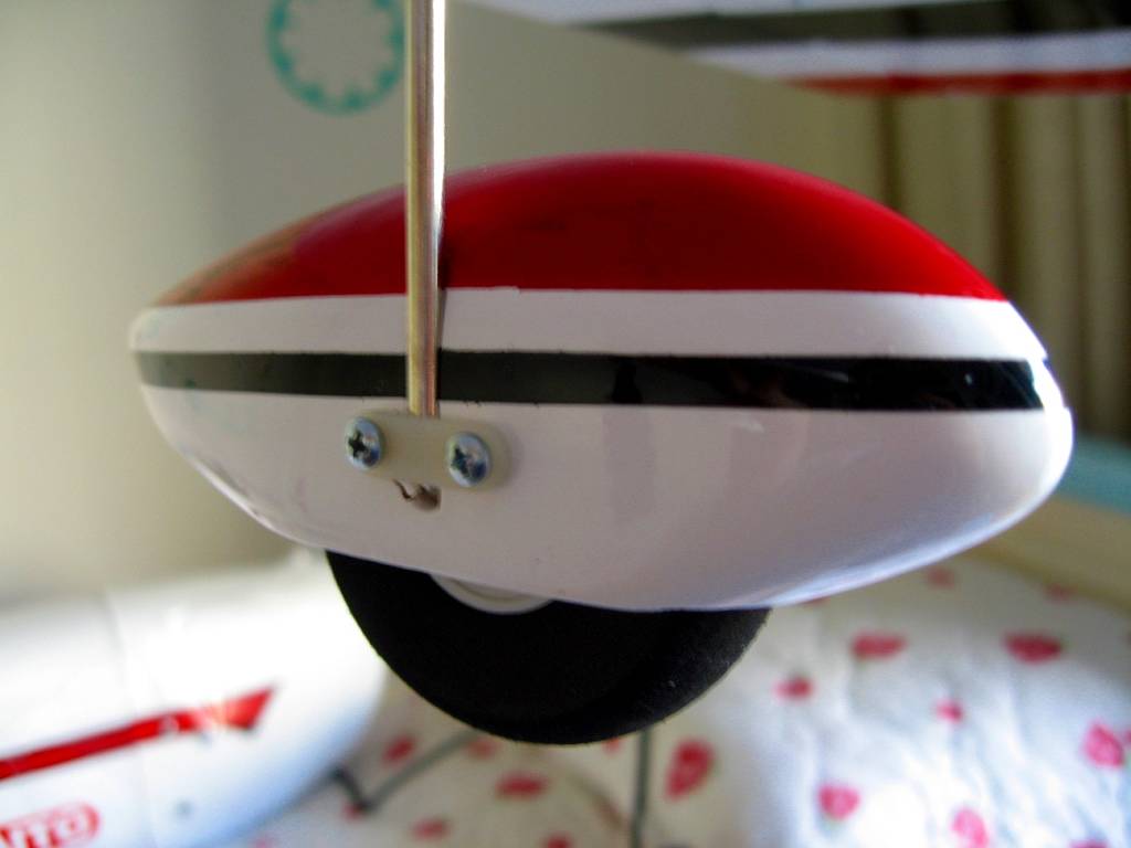

Wheel pants & landing gear -D-O-N-E-

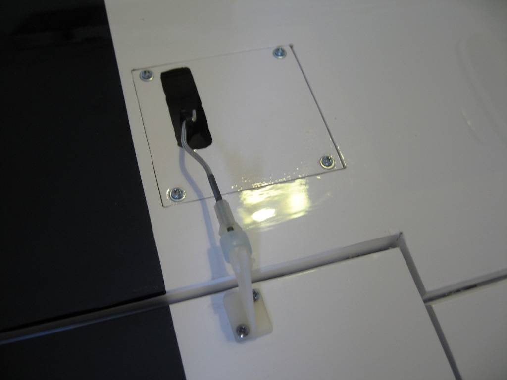

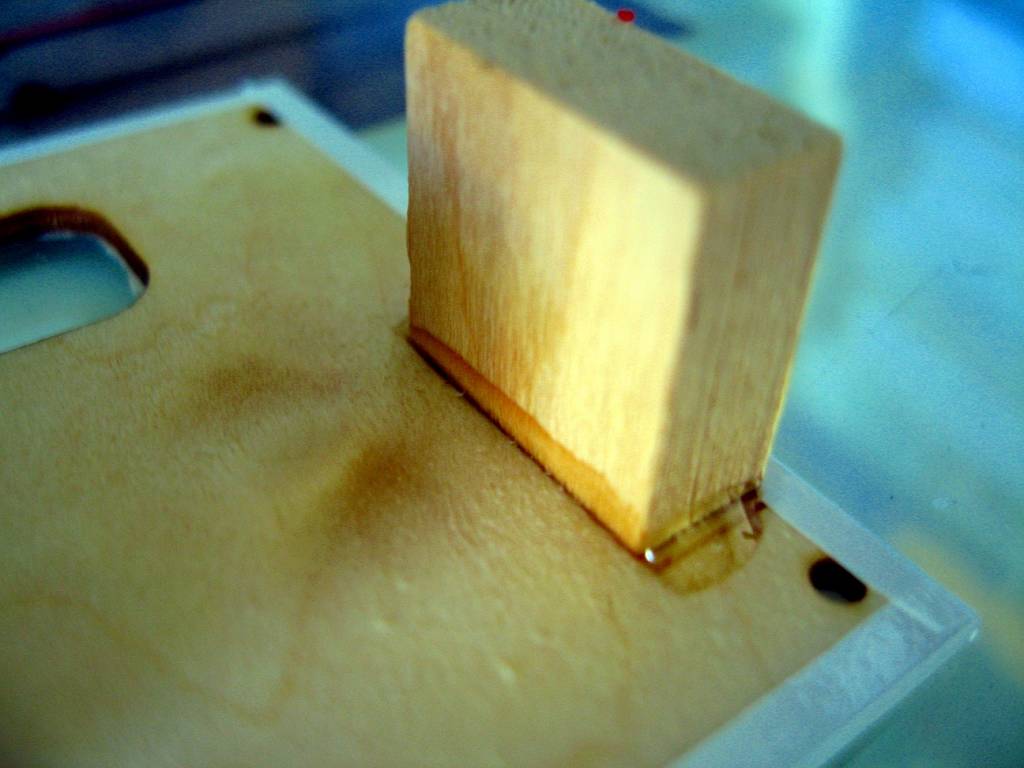

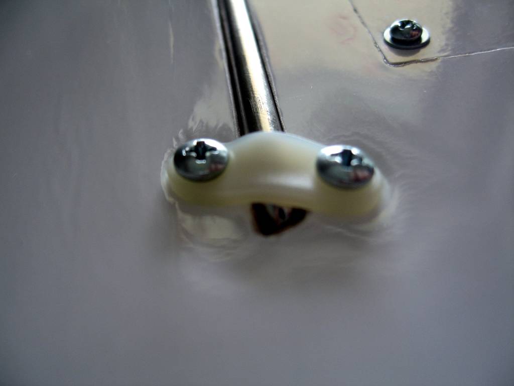

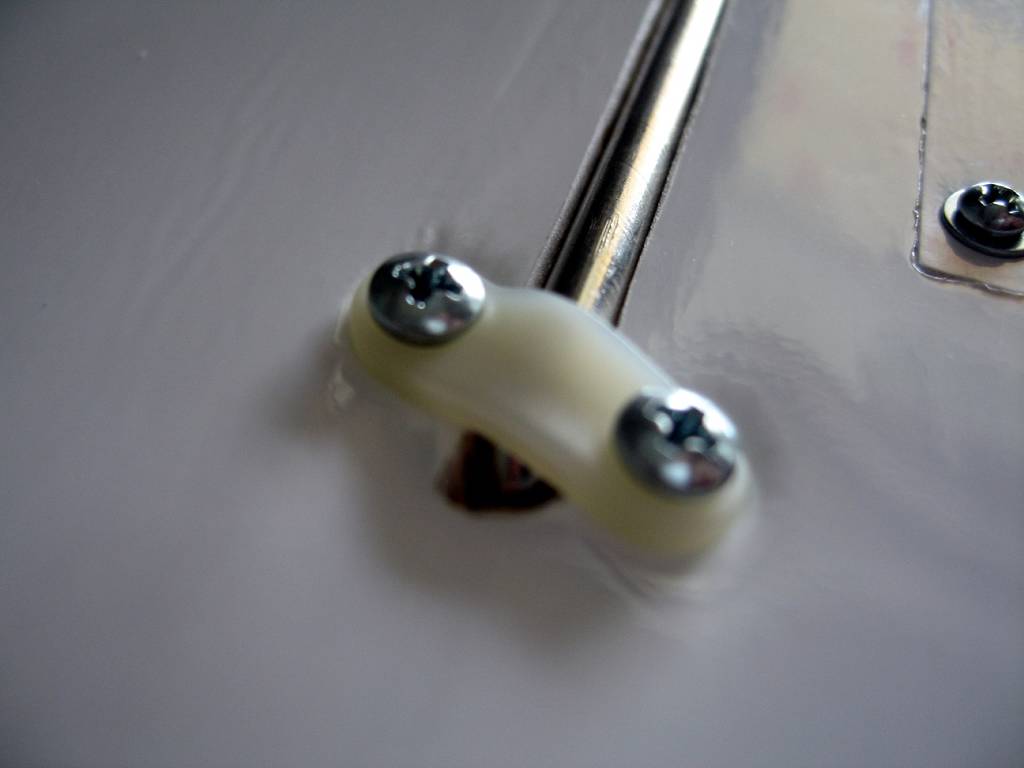

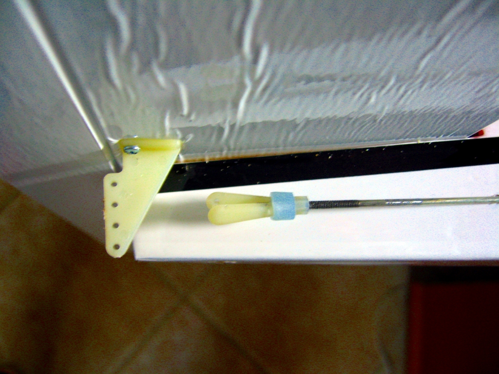

Now to my frustration....

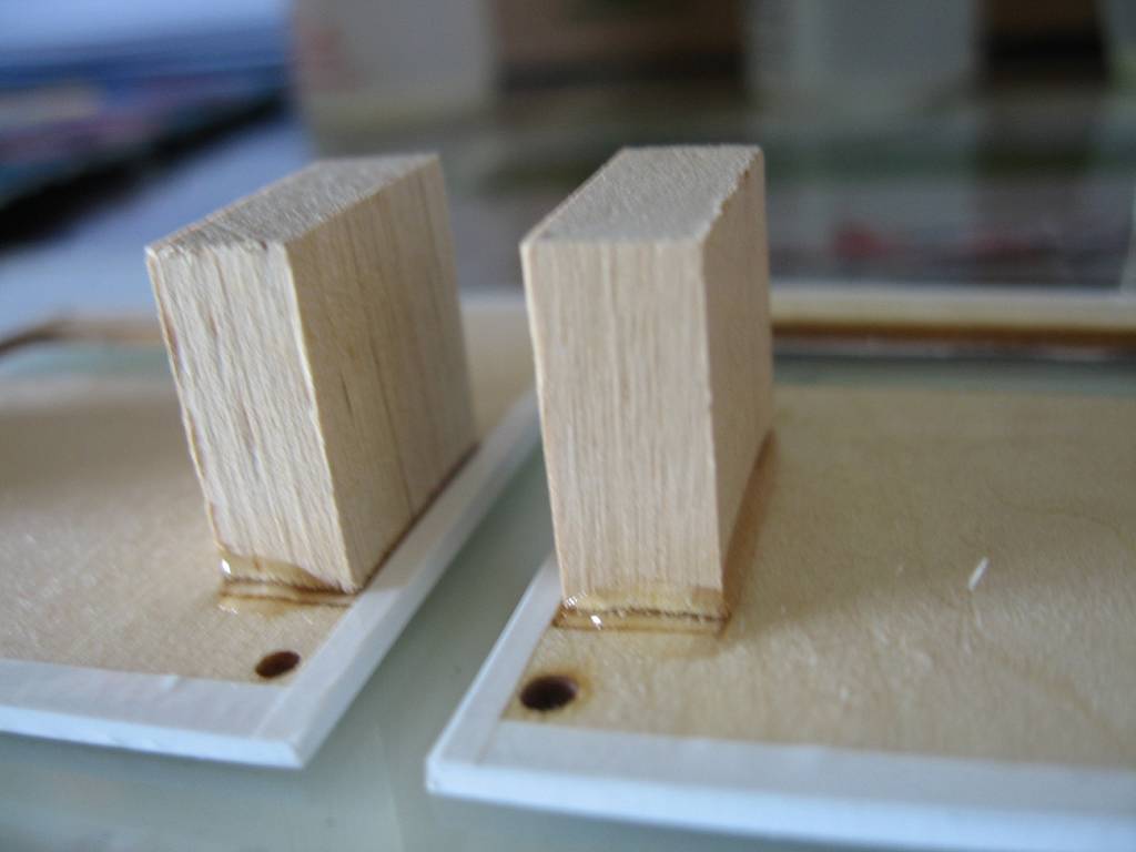

GreatPlanes, after messing with the wheel collar screws, now messes with the small screws that bolt the nylon control horns in place.
There length is not enough for coming out of the other side of the ailerons, so, you cannot bolt the backplate of the horn.
This is also very annoying because the backplate ads to the strength of the whole assembly....
I have used some drops of thin CA+, but i am not really sure if it will hold up.
ID:	1607837   Click image for larger version
ID:	1607838   Click image for larger version
ID:	1607839   Click image for larger version
ID:	1607840   Click image for larger version
ID:	1607841   Click image for larger version

you don't need those screws to come out the other side, the aileron has a hard wood block so you are not supposed to use the backplate. I had this same plane and never had any problem with this configuration.  one question, are you following the manual? I can see you are Z bending the ailerons' pushrods and I'm sure this plane comes with faslink connectors, don't you like them?
Old 05-12-2011 | 09:51 PM
  #34
Joined: Jan 2008
Posts: 302
From: Orange, CA
Default RE: Greatplanes Cherokee 40 ARF Assembly Thread
Not only that, but you should use sheet metal screws, not machine screws.
Old 05-13-2011 | 12:40 AM
  #35
Kostas1's Avatar
Joined: Dec 2005
Posts: 3,566
From: AthensAthens, GREECE
If you drill the holes there is no need for using Self-tapping screws.
I know there is a hardwood there , BUT on aggressive movements i am not very sure if the entire control horn will hold up.
Also guys, if there was no need for the backplates of the horns, they wouldn't supply them.
FasLinks are provided, but only x3 if i remember!
So i will use them on the rudder-elevator and maybe throttle servos.
The Z-bends really work nice + it's a 1' job!

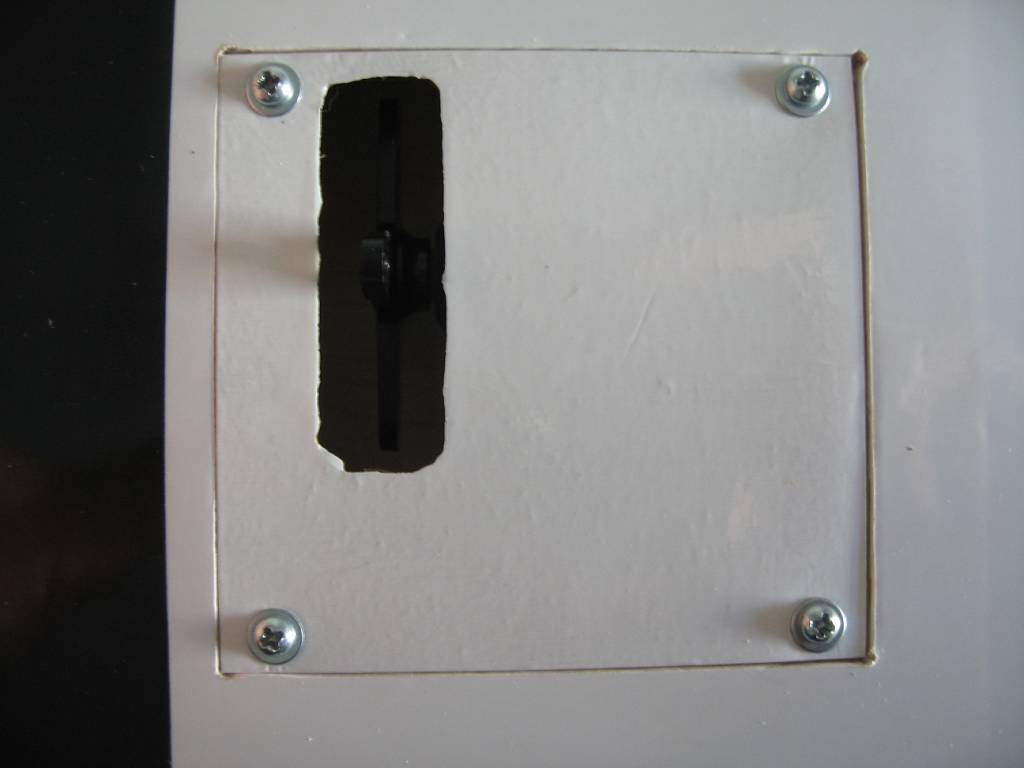

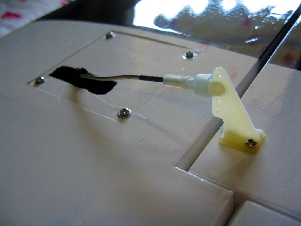

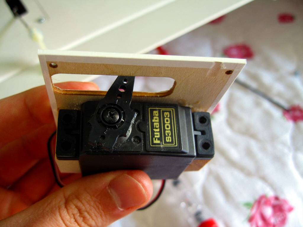

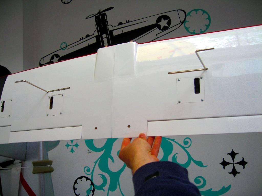

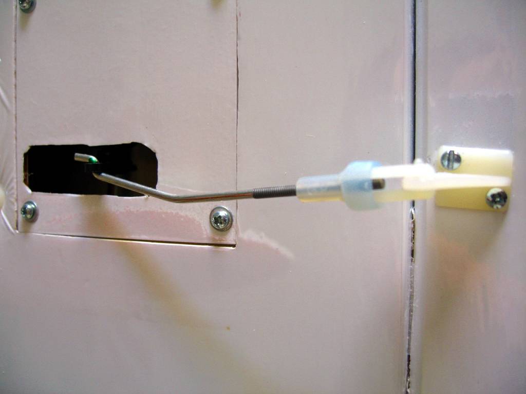

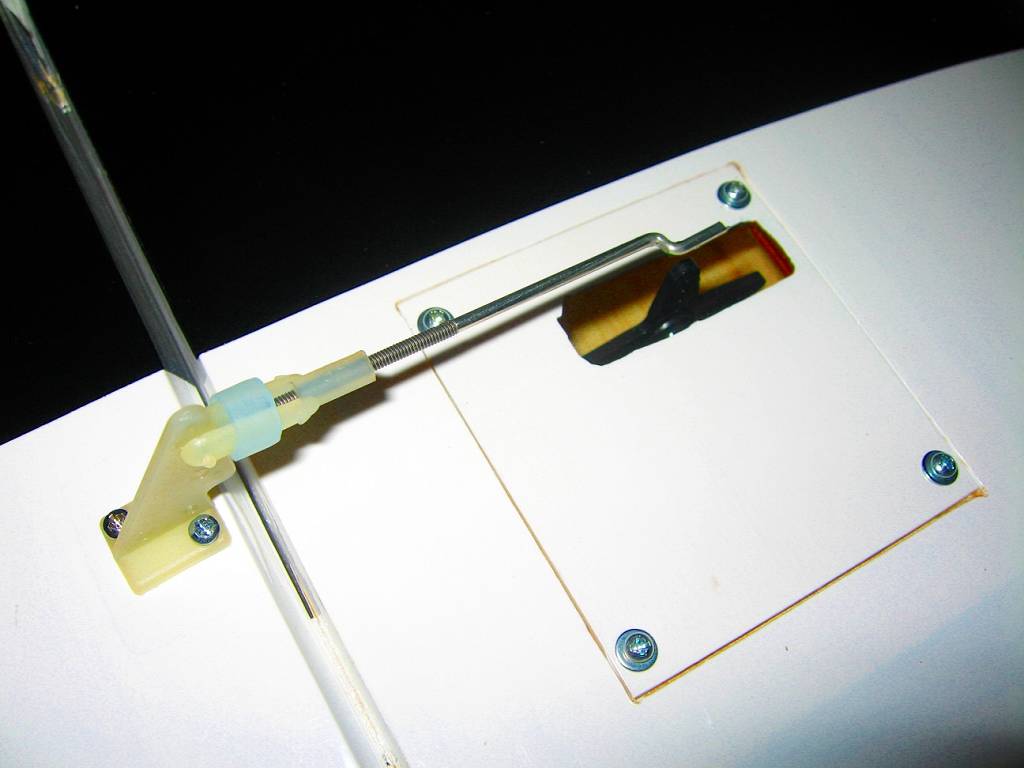

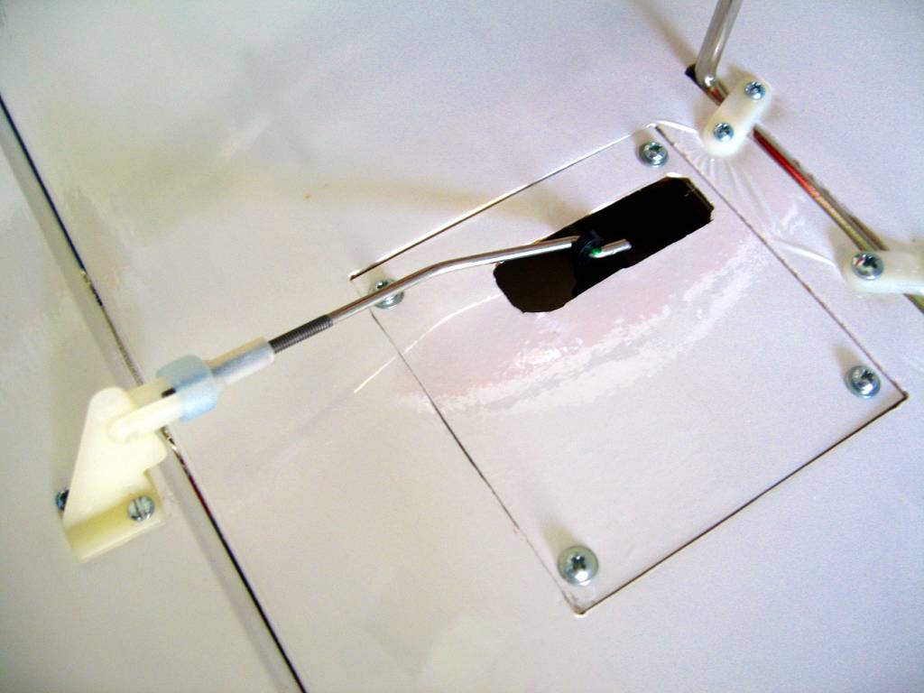

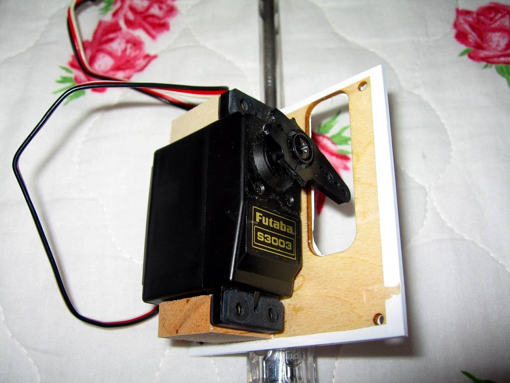

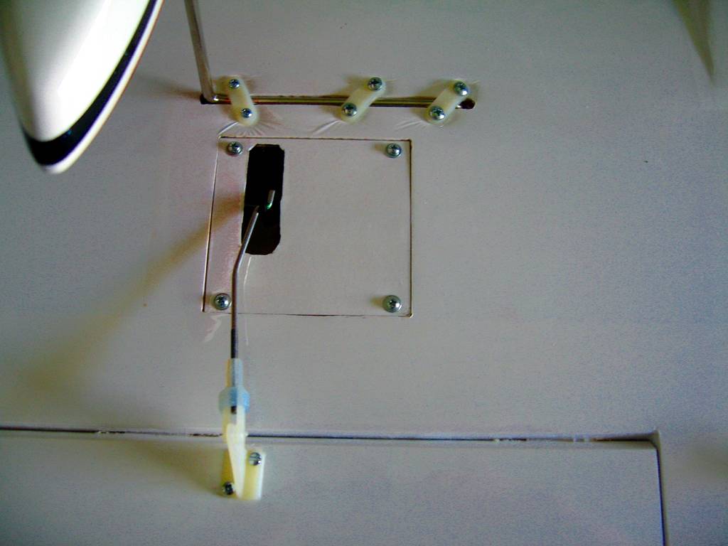

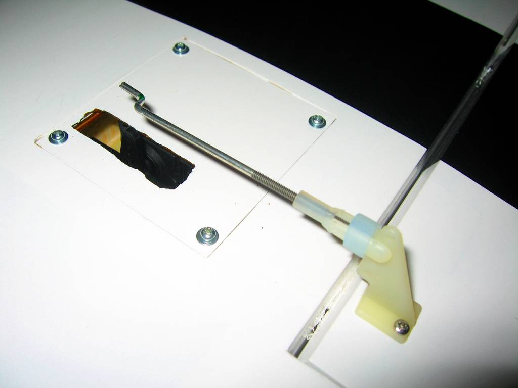

Both flaps are now Ready!
I used x2 Futaba S3003's and GreatPlanes 2-56 Nylon clevises & 2-56 aluminum pushrod.
ID:	1609631   Click image for larger version
ID:	1609632   Click image for larger version
ID:	1609633   Click image for larger version
ID:	1609634   Click image for larger version
ID:	1609635   Click image for larger version

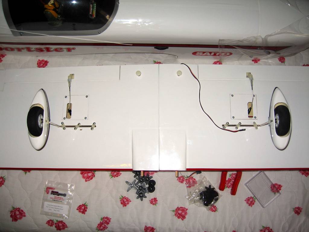

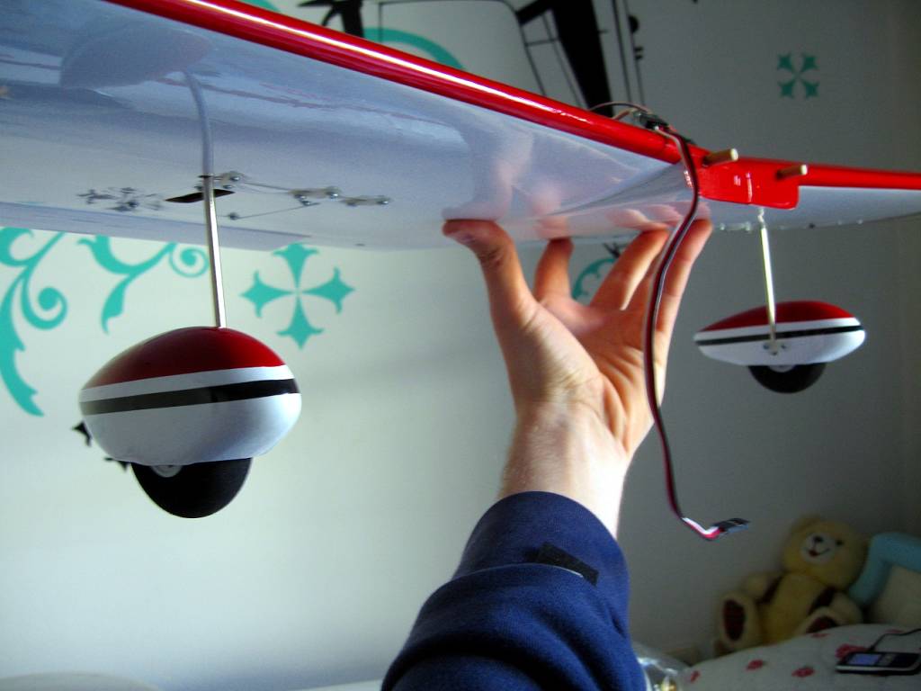

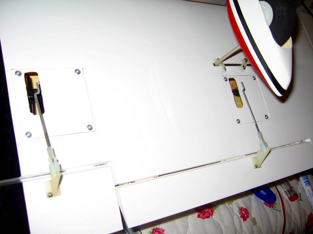

Wing is now ReaDy.....Both Ailerons also installed.
I used x2 Futaba S3004's.

Rudder pushrod & horn, installed.

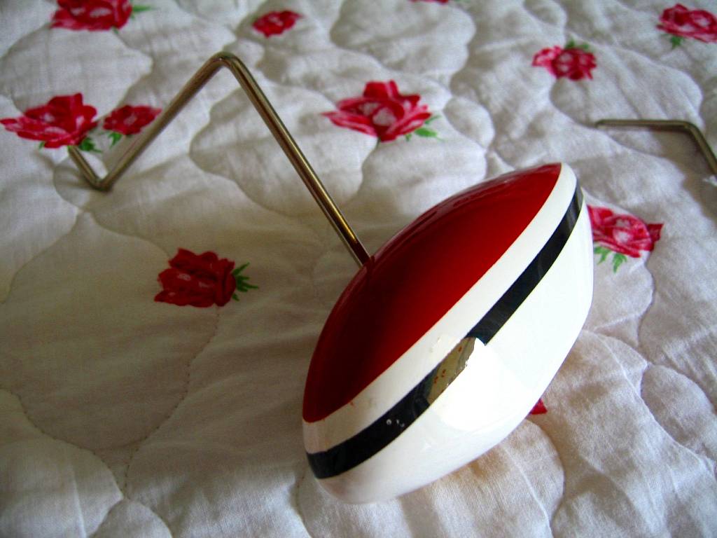

.....ouch....
