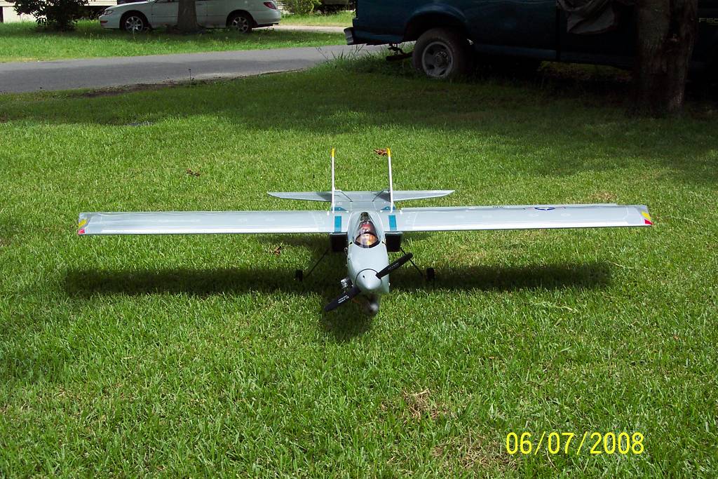

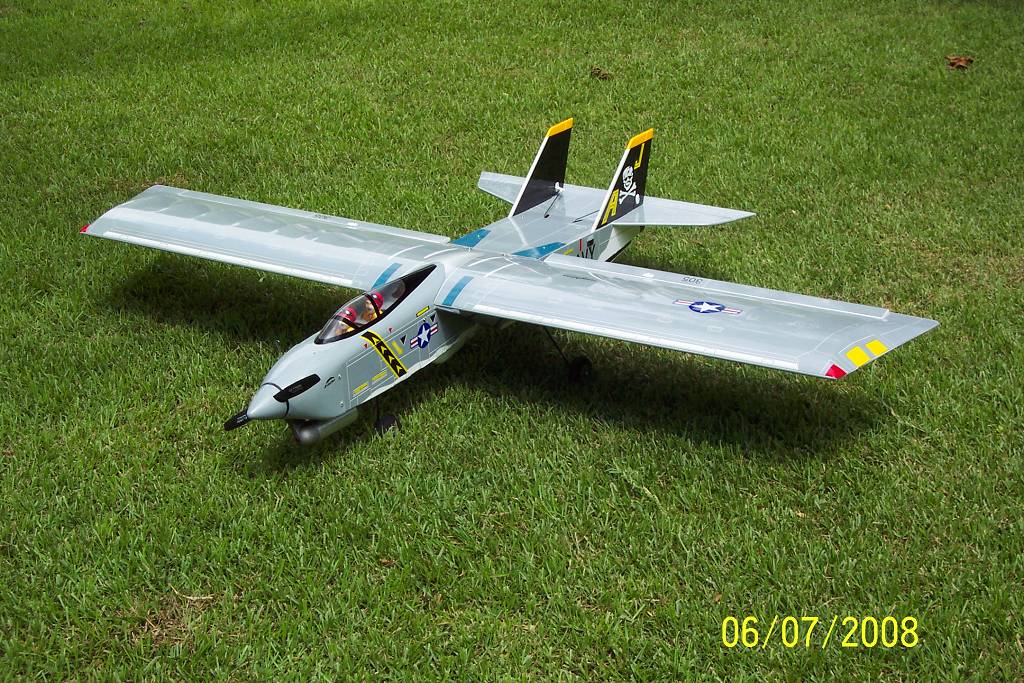

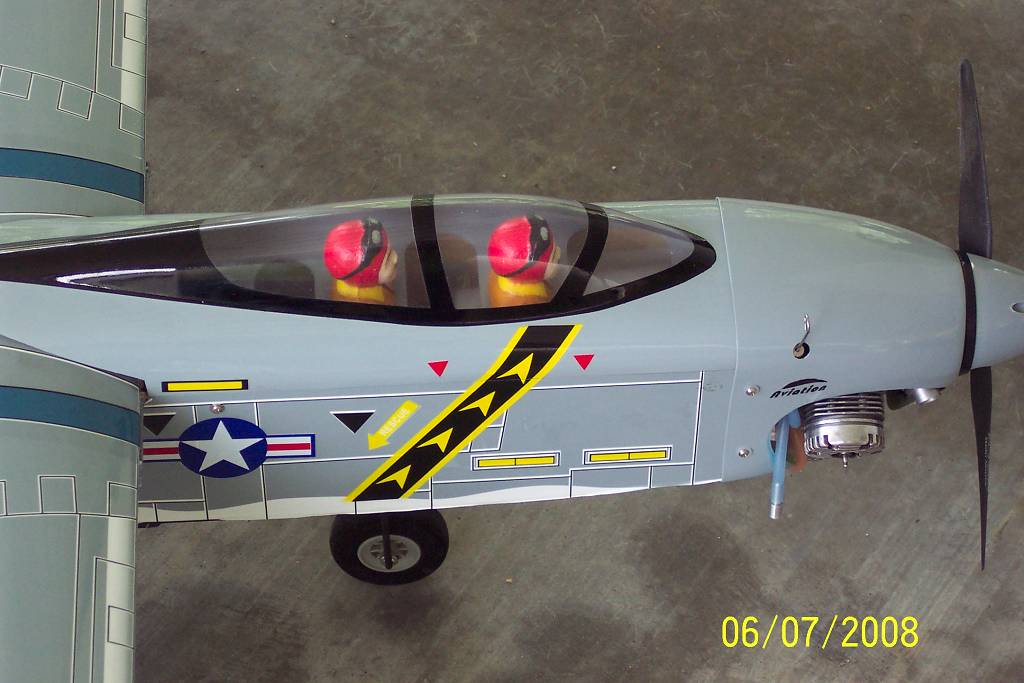

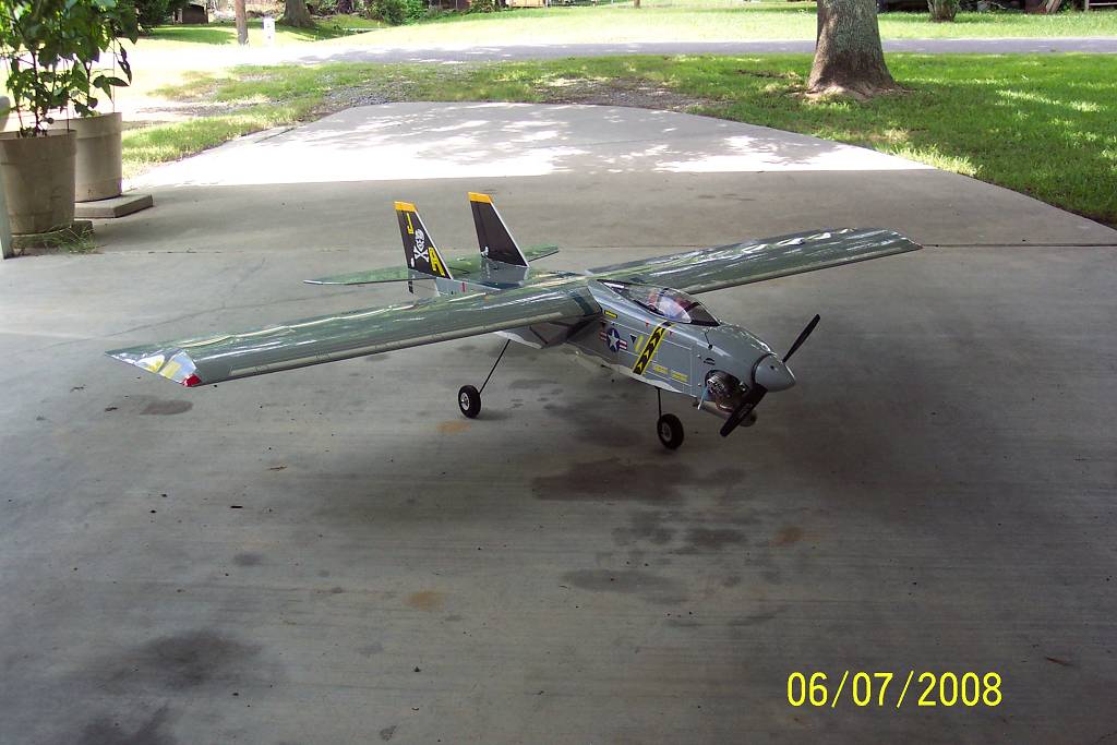

ORIGINAL: Bill Diedrich
Here are some pics of my TameCat, just to get those fingers going on the assembly.
Bill D.
Bill D.

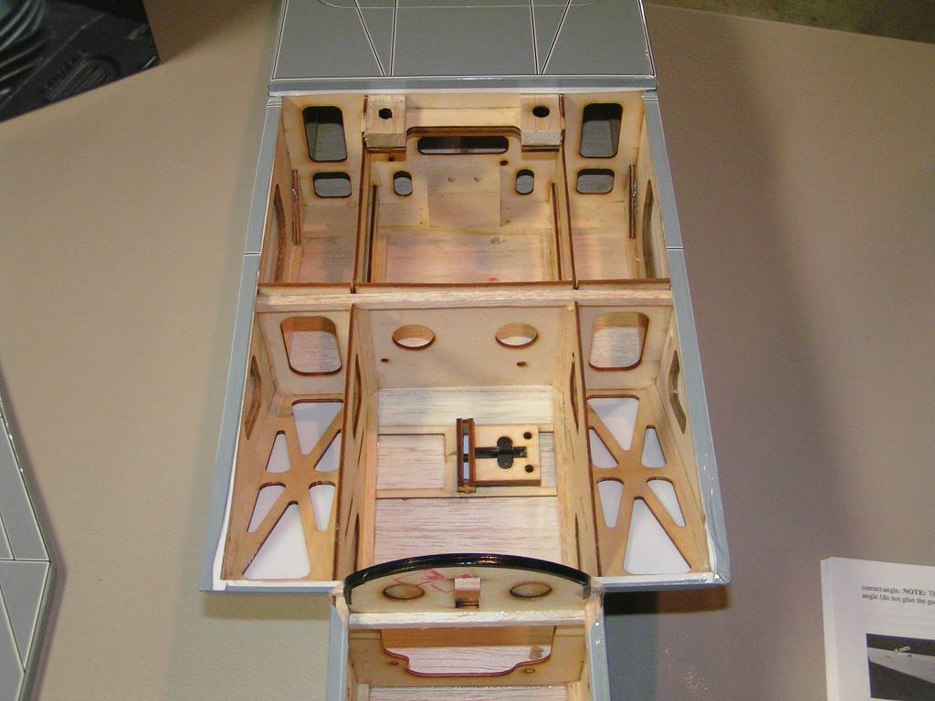

Started on it tonight, i'm pretty impressed so far.. Everything looks to be built good, with plenty of glue on what i can see.. The wing went together very nice and is nice and straight, gonna let it dry over night... The only thing I am changing so far is the control rods and will connect to the servos with "Z" bends, not the supplied EZ connectors.. As stated by others, 4-40 is the way to go.. As far as ARF's go, this one has most of the work done. Should have it done in a couple of nights...</p>
Question on the hinges:
It says they are pre glued, with the arrow pointing to the control surface side of the hinge. Then the code for applying epoxy is also in the box.(pic 1&2)I am thinking it has to be glued to the flying surface, but i cant get them apart. Am I missing something here, are they glued already? I tried all the control surfaces and I cant get them apart using normal force, don't want to pull them out if they are glued...
Here are some pics of the fuse, you can see the glue and that is always a good thing.. The quality of this arf is very good and you cant beat the price..
ORIGINAL: turboratt89
i saw the same thing on my kids i tried my hardest to pull apart
no can do i think the man was changed afterward
