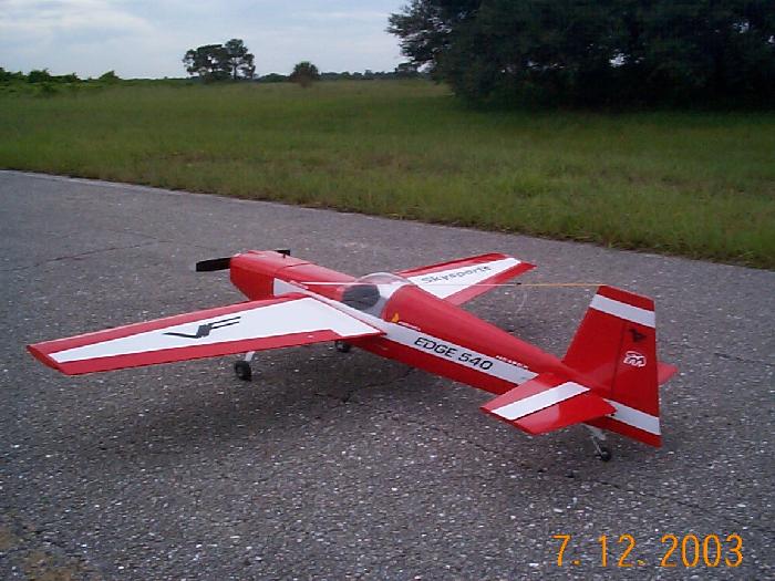

Default vector flight edge questions
I built mine with no engine offset at all, and it flys great. I also used the CA hinges, just added a couple of extra here and there. Yes, the instruction/assembly manual does leave a little to be desired, but if you take your time, and go through the manual a few times before starting, it makes things go much easier. And if in doubt about anything, call or e-mail Vector Flight. They'd be glad to help you. Believe me, you'll never deal with a better customer oriented company!
