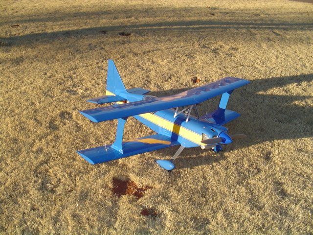

Well I'm taking the st 90 off the seagull Ultimateand installing a saito 125, can someone tell me how much right thrust and down thrust they have been adding? I have heard around 2 to 3 degrees right and 2 degrees down does this sound right?

Ken, I shimmed mine to match the nose on the cowl. I don't recall any down thrust, but it did take some right.

Thanks David, that was how I did the st90 and it took a few clicks of right rudder, Would 1 to 2 degrees help?

I don't know what kind of flying you do. But the Saito 1.25 on this plane is a good sport flyer. Vertical will not be unlimited by any means. That being said, as long as you don't care if it hovers or 3Ds the 1.25 is a good choice. It will get better with time. I would leave the 16x6 for now.
Curious, why do you think it needs more right thrust? Also, have you checked to see if everything else is straight? When I assembled mine I had a hard time getting the top wing mount straight. Lay a yard stick from it to the rudder post and see if it's dead on. I spent a lot of time getting mine right.

Thanks dave for the info, Im not looking to 3d just the average sport flying, I do agree with you about leaving the 16-6 on for now, It flys ok just seemed a little slow but then again it is still on its first gallon. The reason for right thrust was I had one of our top flyers mention he had to add quite a bit of rudder and that right thrust would take it out, we flew it sunday and it did seem to hlep so i may leave it as is for now but i will deff check it with a yard stick to double check things. thanks again for the info..one more question though, you mentioned the 125 wont give it unlimited vertical, I thought I read some were on a thread on here that it would?

It would not on mine. It had decent vertical but no where near unlimited. Could be I had a heavy example. I sold it because it was so heavy compared to the Goldberg of the same size. I think the canopy with pilot bust weighed 1/2 a pound. To be fair, I never ran the 1.25 on the Goldberg I bought to replace it. The 1.25 went to a profile and I bought a 1.20AX for the new bipe.
When you start checking everything for straightness. Also look at the inter plane struts. Mine were putting a slight twist on both wings when I bolted them up. I noticed one day the covering would wrinkle a little when I bolted them in. It was not off much, but I am picky. The fix was easy, I just elongated the holes and it relieved the pressure.
