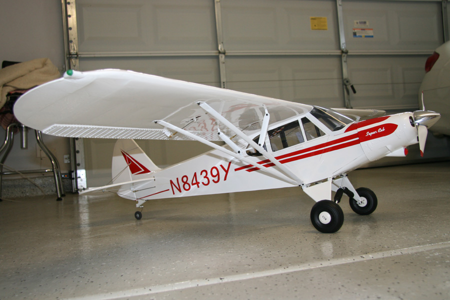

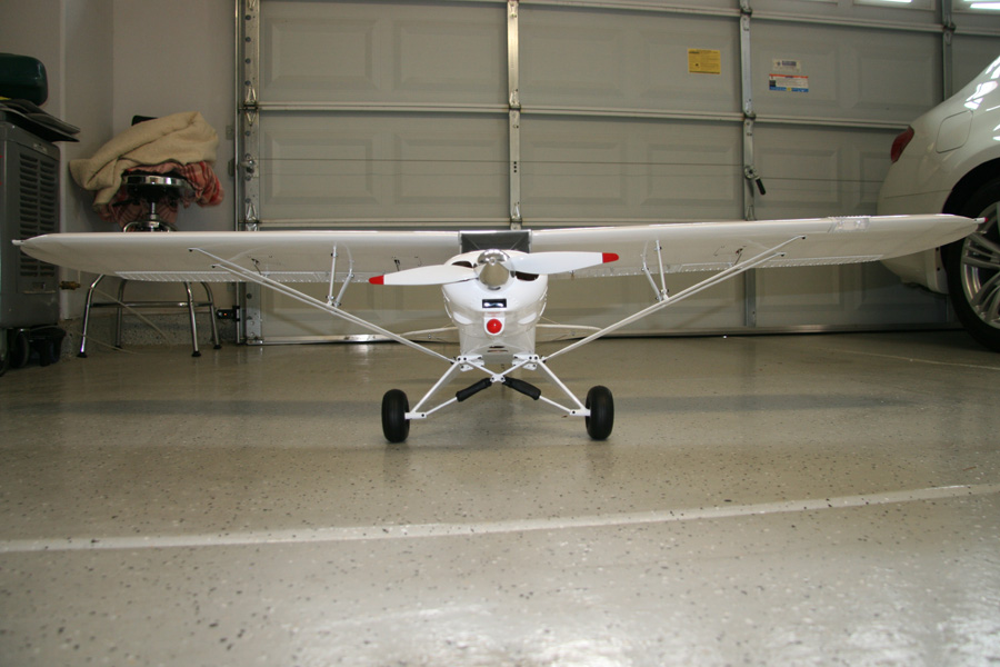

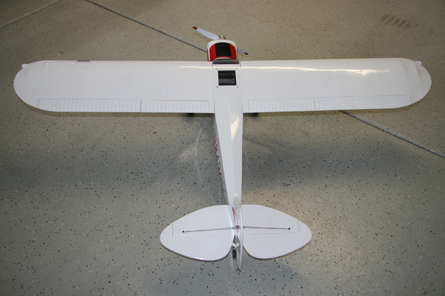

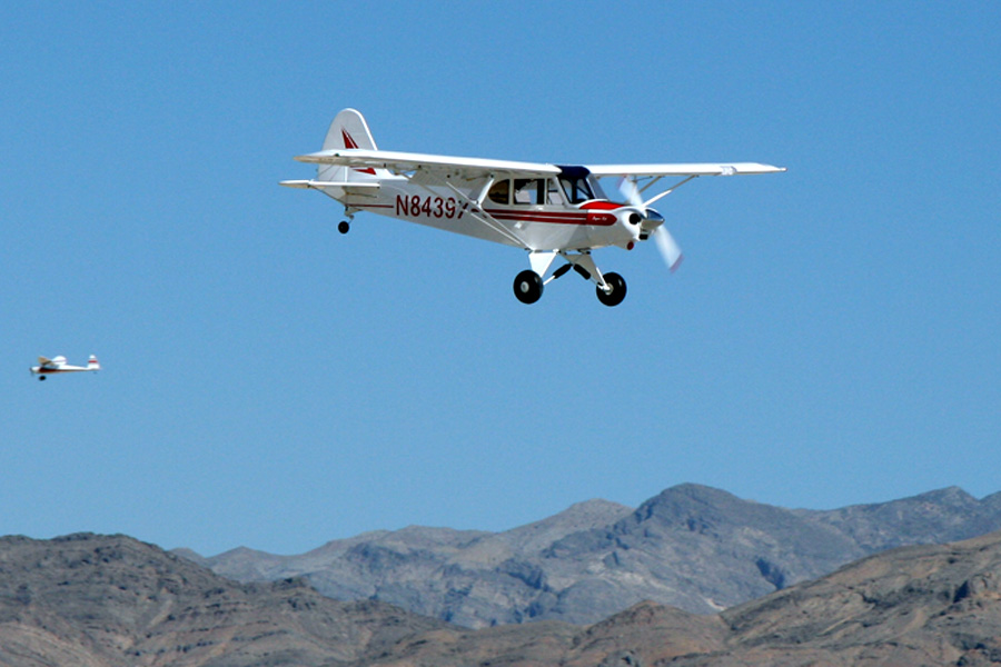

I am using the eflite 25 motor, castle creations 75 amp esc and a 4 cell 3300Mah li-po. Recommended prop is an APC 13x6.5. I am powering the servos with a seperate NiMH battery pack.The decal was done by our local club member.

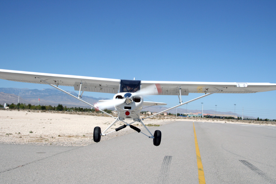

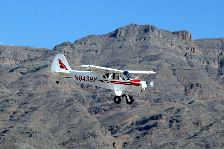

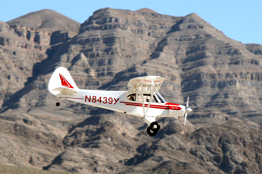

Had the maiden flight on the super cub. Flies like a cub. Aileron differential is a must. Flaps work great. We felt that this plane does NOT have a tendency to tip stall. Stalls are straight forward. Using the e-flite 25 with an apc 13x6.5 prop has ample power for me. Flew 7 minutes on a 3300 pack and used 2500 MaH. E-Flite has done a wonderful job on this plane. Should be a keeper.
Hellcat- I LOVE that last picture!!!
